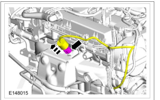

I am having a problem with my car. One time it overheated on me, I was able to get it home. The next day I get into my car did not even fully turn it on and it is saying "engine coolant over temp"? So I dd not think too much of it I just let it sit for a week or two and I am still getting the same message. Any suggestions? Taking it to the dealerships out of the picture.

It sounds like you have a coolant leak which will cause both issues here is a guide to help you see how to find the leak.
https://www.2carpros.com/articles/car-is-leaking-coolant
If everything looks okay I would try replacing the engine coolant sensor here is a guide to help you see what you are inf or when doing the job.
https://www.2carpros.com/articles/coolant-temperature-sensor-cts-replacement
Here is the location for your car. Check out the diagrams (Below). Please let us know what happens.
