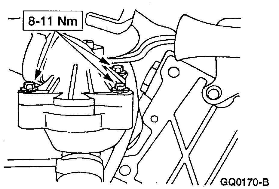

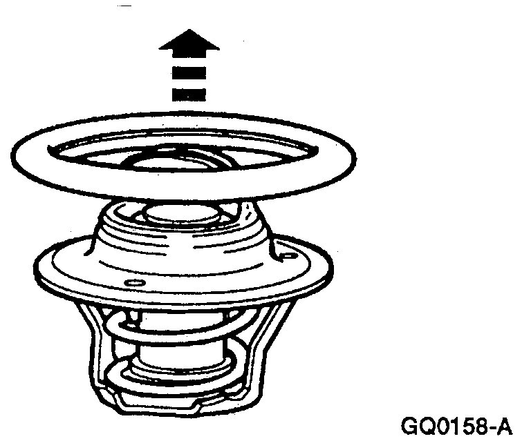

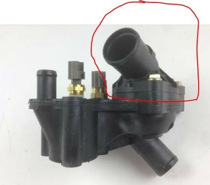

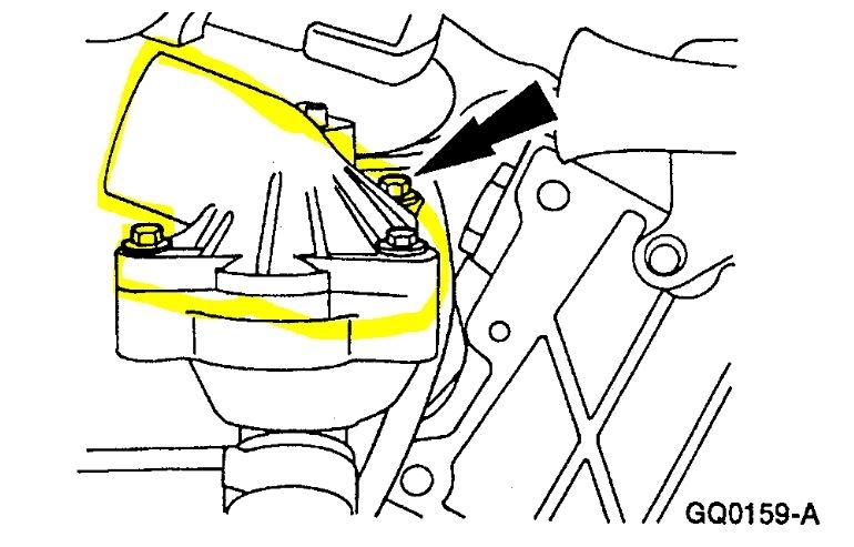

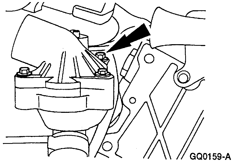

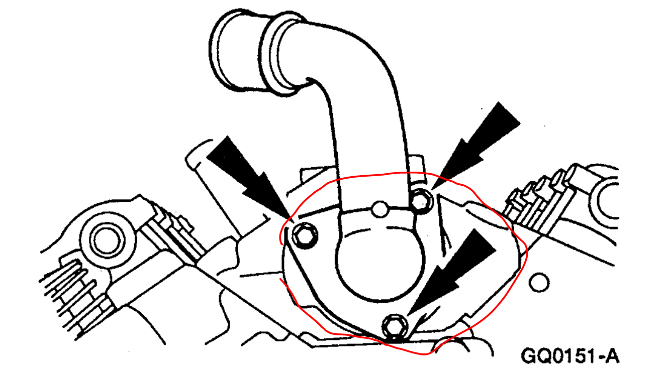

Nearly 40 years in the business and I have never seen a thermostat housing on the radiator. I have seen them at the bottom of the engine feeding off the lower radiator hose. However, your vehicle should have one at the end of the upper radiator hose (top of the engine). If you follow the upper radiator hose to the engine, it will end at the thermostat housing. If you look at pic 2, it shows what the housing looks like, As far as plastic or metal, both were used over the years, but that really shouldn't matter.
If you are replacing the thermostat, here is a link that explains in general how it is done. If it is a different problem you are fixing, let me know what it is.
Here are the directions for alldata. They are a bit vague. That is why I included the link above. The worst part of replacing it is you have to craw under the vehicle to open the drain on the radiator. You will need to drain the coolant just a little below the height of the thermostat; otherwise, it will leak from the engine when you remove the thermostat housing.

pic 3
3. Remove the bolts.
pic 4
4. Remove the thermostat and gasket.
Installation
pic 5
1. Follow the removal procedure in reverse order.
______________________________________________
Let me know if this helps. Also, if you have questions or need help, please feel free to let me know. One last thing. the first and last pics below is an actual photo of the entire inlet assembly. I circled the thermostat housing portion. There are (I think) three bolts that hold it on to the unit. Under that is the thermostat. For some reason, it ended up being on there twice and I can't delete one of them. Sorry.

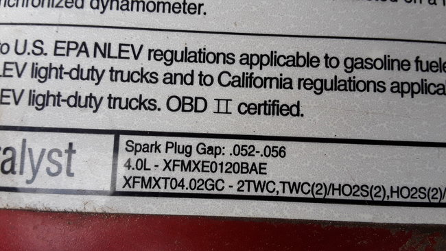

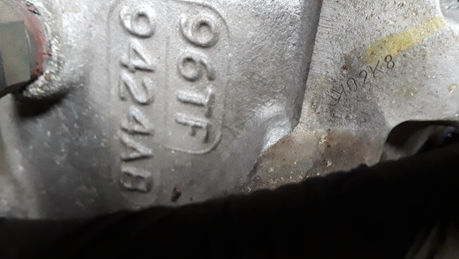

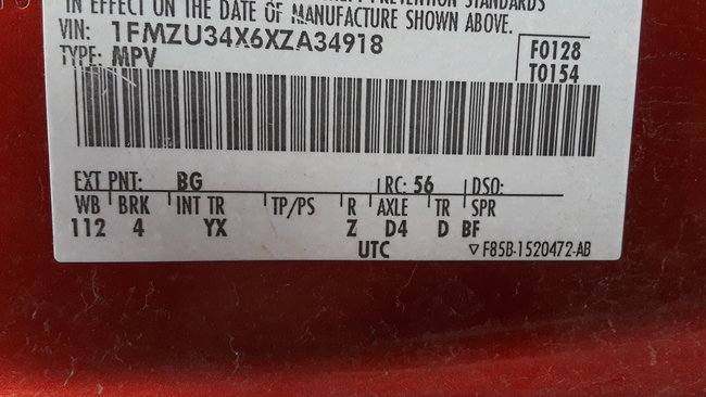

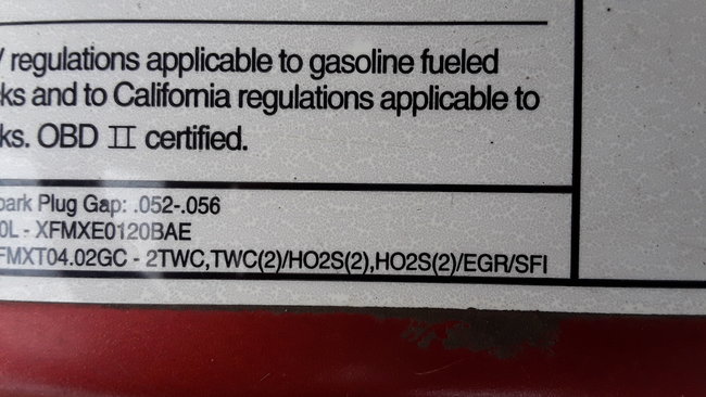

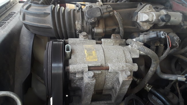

I have to take the mass air flow hose and all that stuff off to to get a clear picture of it because everything's really crammed in there in that spot. But alongside that spot I did find a number that I think I got a pretty clear picture of. I don't know if you can do anything with it or what it means but I'll show you a picture the other three are the first two under the hood at the front of the truck over the grill and of course the other ones the one on the driver's side door the door. One apparently says that it is an automatic 5-speed which it's an automatic but I didn't know it was called an automatic 5-speed and it's also says 3.73 limited slip. So I'm not sure what they mean. I acquired subscription for Alldatdiy they have a acronym list for some of them but again I find several of the ones I have are not listed from the stickers. I haven't finished reading up yet on the other letters and numbers I'm working on that right now.
Friday, January 10th, 2020 AT 9:58 PM
  • 110,194 POSTS

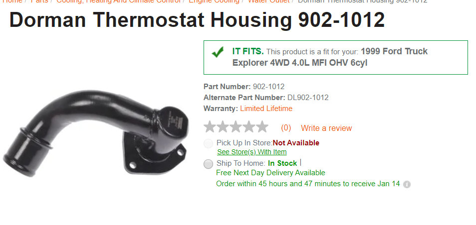

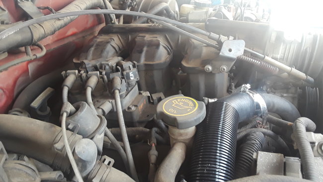

Okay, I think I figured this out for you. Based on the vin number (pic 4), you have a 4.0L V6 with an engine code (X). For some reason that shows up differently when I check the pictures. Take a look at the attached pic and let me know if this is what yours looks like.
Although it is a Ford 4.0L, the engine in your vehicle is of a slightly different design and this design isn't as common as the other.
Now, if that looks correct, I checked online and found the dorman part number. See pic 2.
Anytime you need parts for this engine, indicate that it has an X engine code.
Let me know if that looks right.

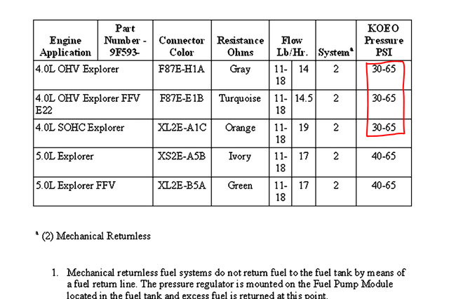

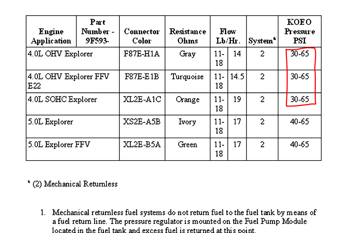

It is possible the vehicle could be from Canada. As far as that code, that indicates a lean fuel mixture. Most commonly, the cause is either low fuel pressure or a vacuum leak. That could be the cause of the rough idle and low power.
Do me a favor. Here are directions for checking both for a vacuum leak and fuel pressure. Start with fuel pressure. Although a leak will cause a rough idle, low fuel pressure will cause a power loss.
If you look at the attached picture, it shows the manufacturer's specs as far as pressure. Note that KOEO stands for key on engine off.
Check this and let me know what you find.
