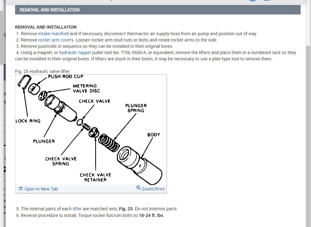

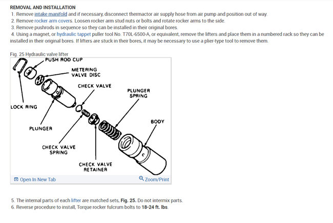

There is a spring inside the lifter and you should be able to compress them. It is not easy but if you put the push rod in the cup, you should be able to compress them.
Normally people will pump them up and fill them with transmission oil before installing them.
Since the engine is sitting for a while, I would replace all the lifters and retest for the noise.

When the lifters are pumped up, you cannot depress the plunger by hand. That is done with the pushrod installed and the rocker arms attached.
As far as the ones that you can push down, they are bad. You need to replace them. As Ken said, I would replace all of them at this point.

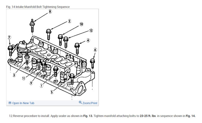

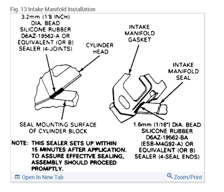

https://www.2carpros.com/articles/replace-intake-manifold-gasket
https://www.2carpros.com/articles/replace-valve-cover-gasket
