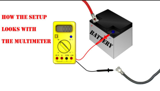

We need to test for the battery draw. This guide talks about this issue but I will give more details to properly address this:
https://www.2carpros.com/articles/car-battery-dead-overnight
Please see the diagram below and that will explain how to set your meter up in series with the battery so that we can confirm this fuse is the cause of our issues.
Then we need to get a picture of the fuse you are removing so that we can be sure we are on the right circuit. Then we can figure out what is causing this on that circuit with the proper diagram of the system.
Please see below and let me know what amperage you have with the fuse in and out.

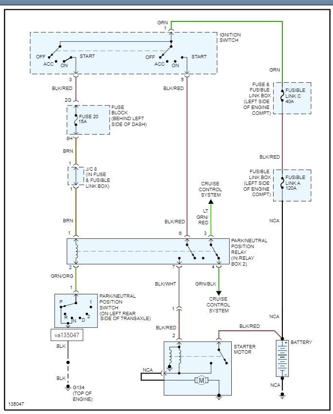

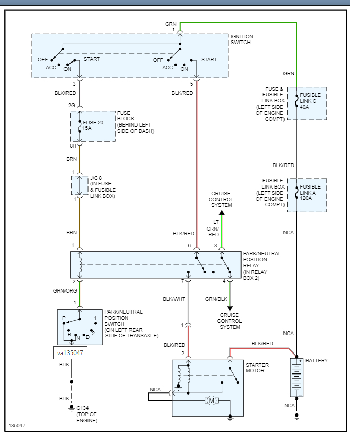

However, we need to confirm this by checking voltage at the park neutral relay. If you look at the wiring diagram you start circuit goes through two sides of the relay. Basically, it sends voltage through the park neutral switch and if it is in park or neutral then there is a path to ground, and it closes the relay to send power to the starter. Technically the ECM does not control this.
