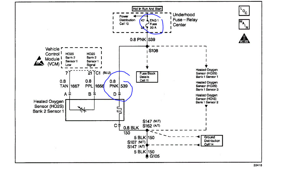

I attached a wiring diagram for you. Check the voltage to the pink wire at the sensor for power with the key on.
153,154

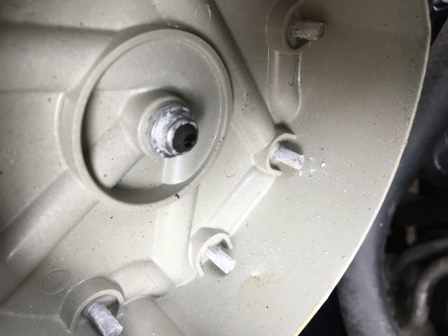

So the rotor does turn, but there is crust residue on all the leads inside the cap. Here is a picture:
Sunday, August 2nd, 2020 AT 2:24 PM
Replace the cap and rotor.
Did you check for spark to the coil to be sure the wire is good?
Sunday, August 2nd, 2020 AT 2:32 PM
JEREMY0507
  • 27 POSTS
I checked the coil wire, it's. Good.I will get a cap an rotor. Hopefully that’s it. Thanks I appreciate the help.
