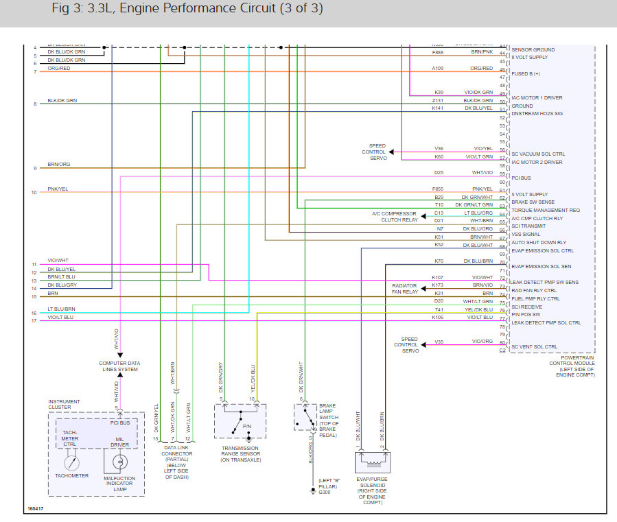

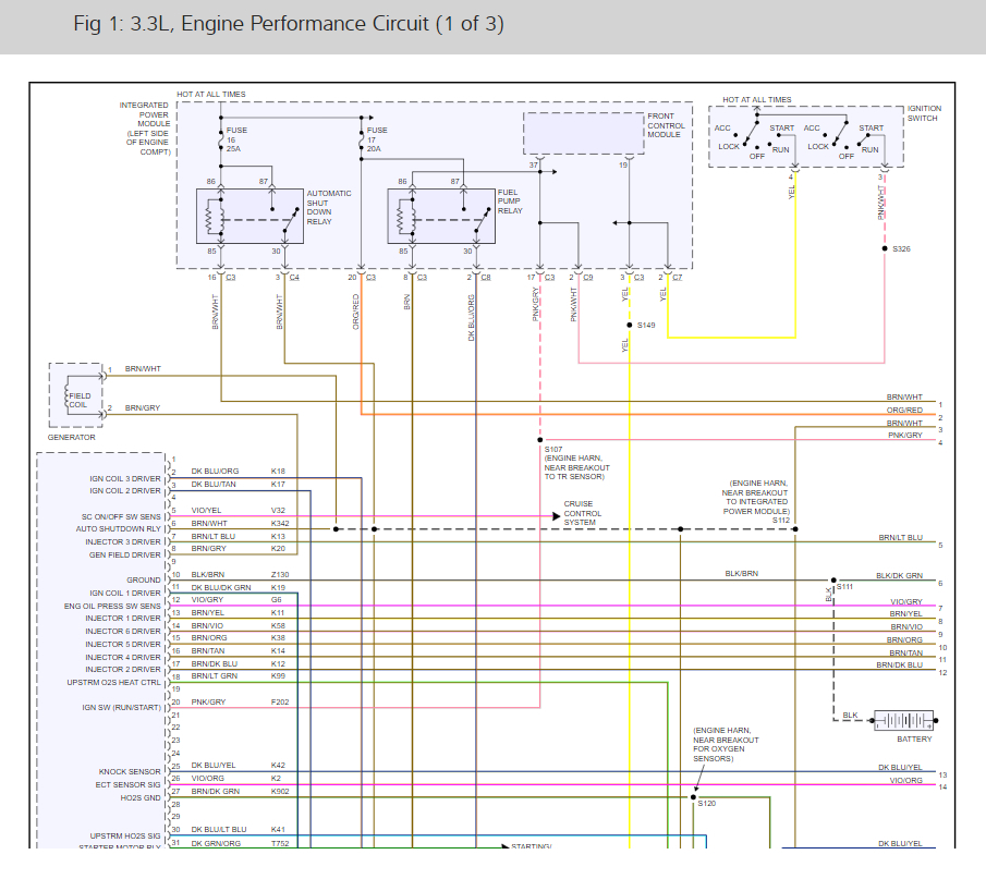

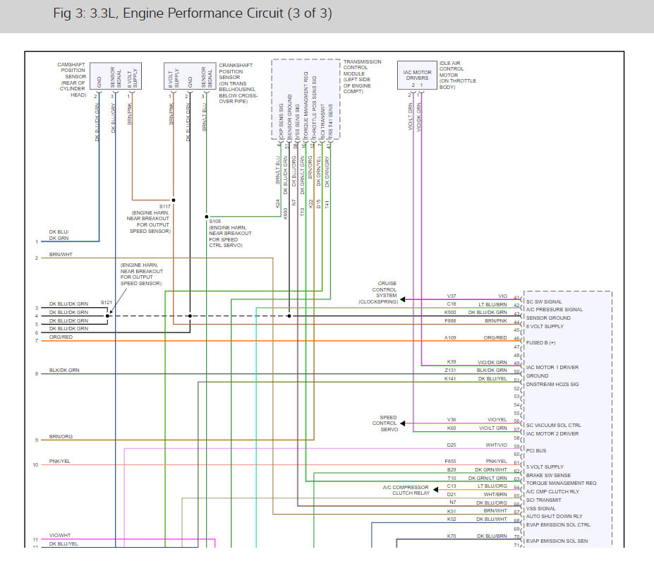

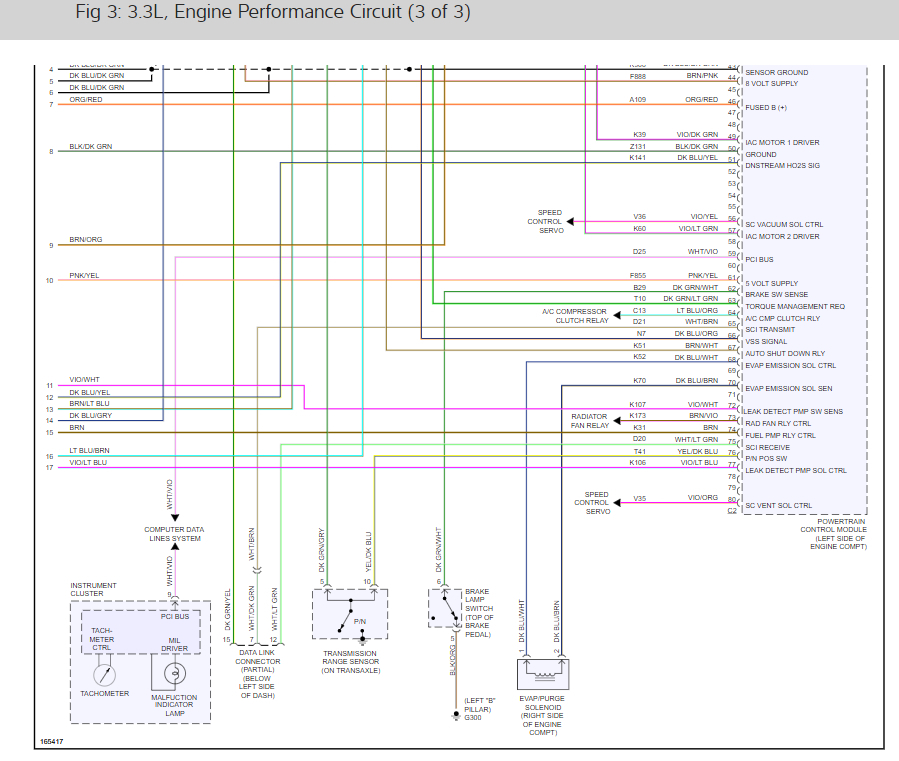

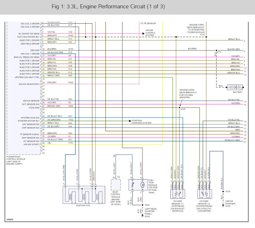

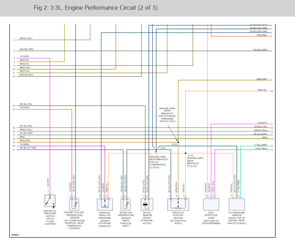

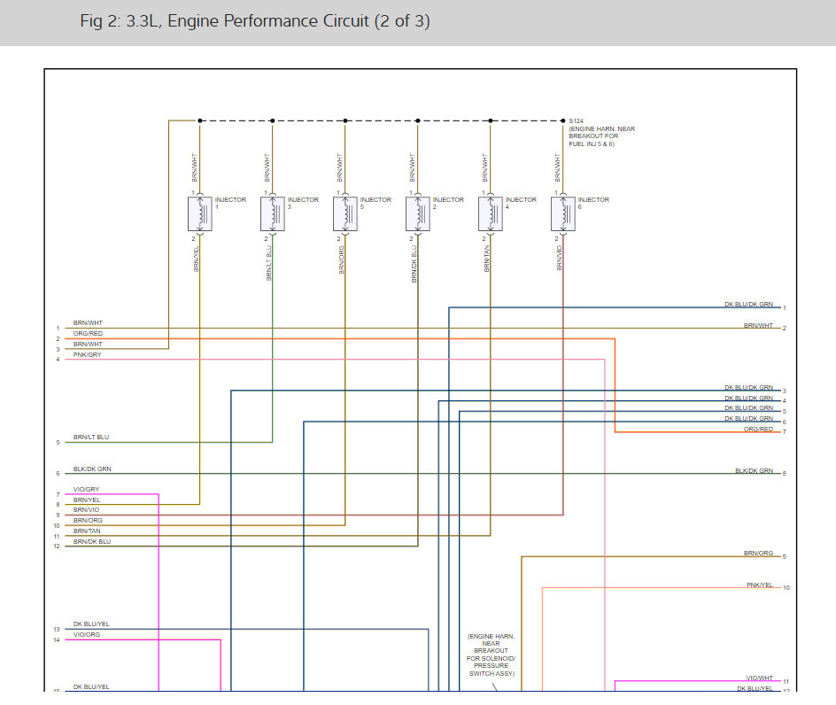

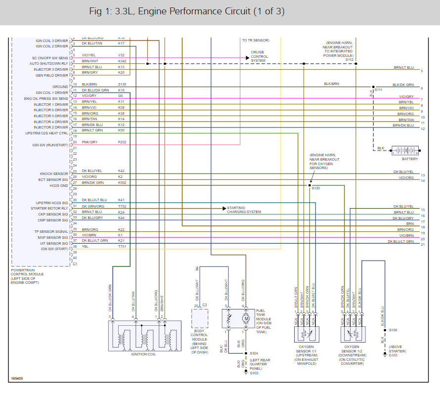

Thanks you for the information. It sounds like a wiring ground/power issue. lets use this guide to check the inputs to the PCM using the wiring diagrams below.

I admit I still have a lot to learn when it comes to electrical. So, I decided to start very basic. After checking battery voltage (12.51), I decided to trace the power side directly from the battery. With my DMM - at the battery positive I first placed the DMM + on the two red B+ cables coming from the battery positive (the exposed wire areas only about 2 inches from the actual connection to the terminal). The reading was as expected (0V or a few millivolts). Then I continued along the positive cable to the next exposed point. That was the B+ cable where it connects to the connector plug (the connector plug that plugs directly into the IPM/fusebox). The connector was still plugged into the IPM/fusebox (basically a back-probe except with the DMM + instead of a t-pin). This reading was NOT as expected. I also expected zero. However the reading was about 0.8V! Then, I unplugged that connector completely from the IPM/fusebox. I also back-probed the unplugged connector and I had the same 0.8V reading! This was also surprising! The B+ cable is only 12 inches long and other that being taped to the other positive cable (I assume the one coming from the alternator) this wire is not even exposed to be able to to be grounded! I also probed the blades in the un-plugged connector (one at a time) and NONE of them show voltage (0V or a few millivolts only)! However, when I probe the mating terminals (in the IPM/fuse-box- with the connector still unplugged) I get FULL battery voltage! I am not sure how ANY of these scenarios are possible? Unless maybe (at least for the last one) that somehow an unintended ground to the B+ terminal in the IPM/fuse-box is present?

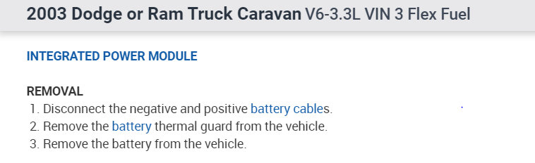

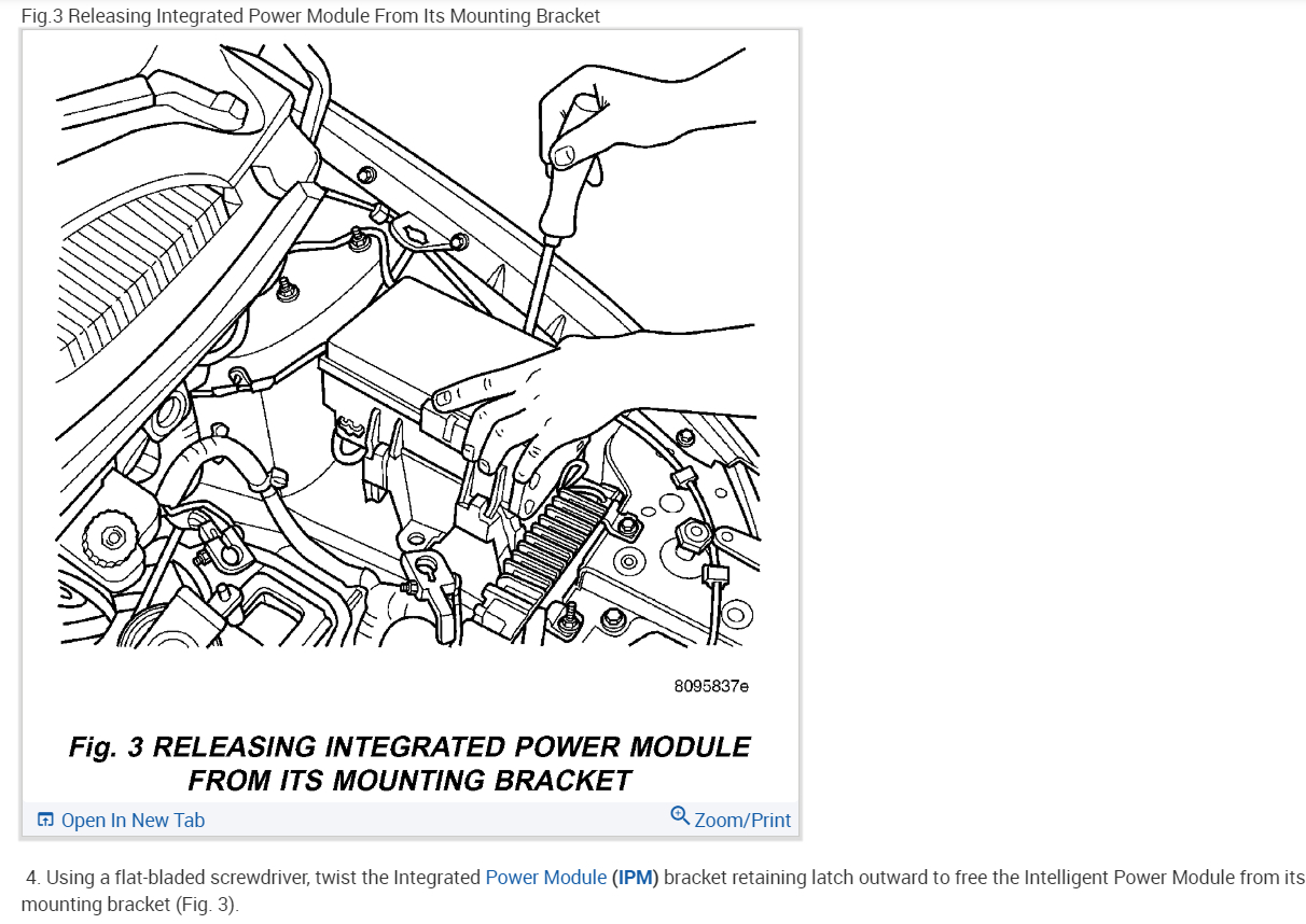

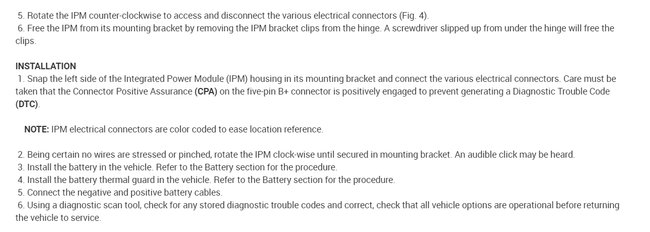

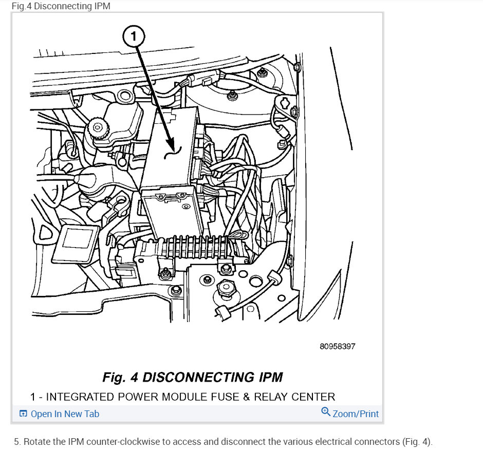

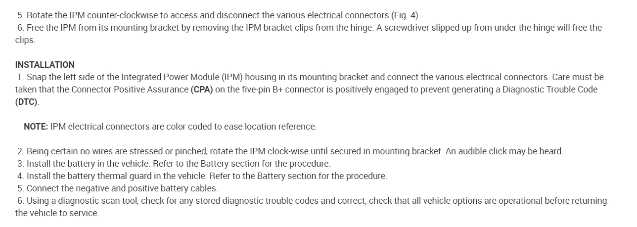

I have seen the IPM go out on this car causing the engine not to start. They are easy to replace because they self initialize. It sounds like this is your problem. Here are the instructions in the diagrams below to help you swap it out. Check out the diagrams (Below). Please let us know what happens.

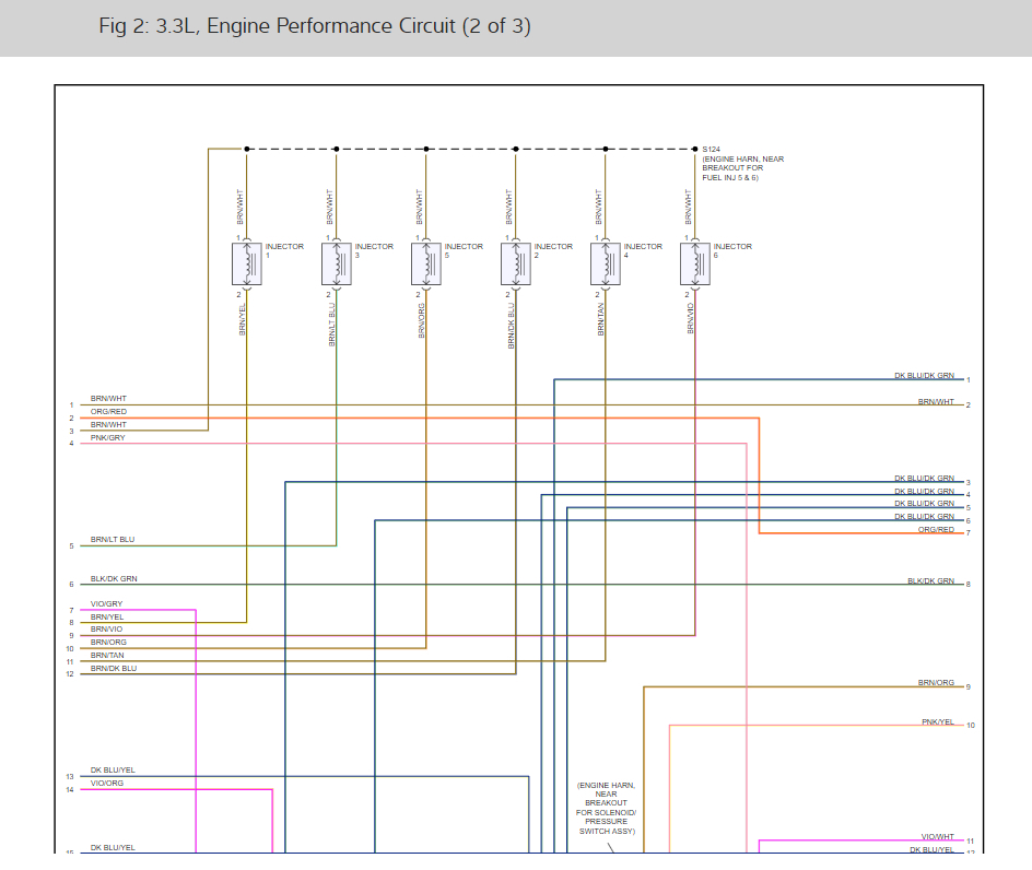

Good to hear, anyone should learn about car repair since we all drive them. I would check the ASD (auto shut down) and fuel pump relays. here is a guide just to make sure. Look at the diagrams above.

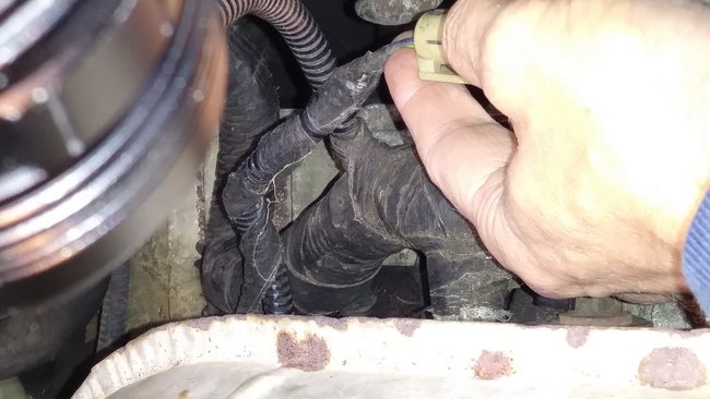

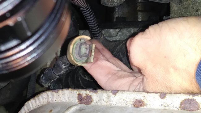

I have checked all relays and fuses again and they are okay.I did find a harness with connector just hanging out - unplugged. It appears to be the knock sensor cable/connection. I checked continuity back to the PCM to confirm. Only problem is I cannot find where it is supposed to plug back in! I have looked everywhere. I also tried to find a diagram on line. Even my Haynes manual has too little detail to discern location. Maybe you have access to something better to show the actual position of the knock sensor?

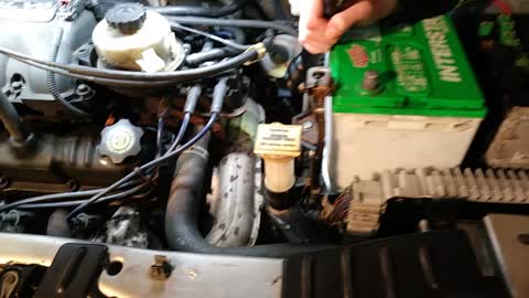

Knock sensor left side of engine, near starter. Can you please shoot a quick video with your phone so we can see what's going on? That would be great. You can upload it here with your response. I don't think this will keep it from starting though.

Put everything back together (except for that one wire connector that has no home #25-- Knock sensor connector). That connector is no where near the front or starter- and would never reach. Still no start. Codes 0123, 0118, and 1193. Also noticed that I have the very original concern again. #43 from PCM has no connection to negative battery terminal even with key in on position.

Okay. Another update for you. I saw that the ground side of the sensor wires were getting power again. This signified a ground issue to me again. So, I tried my old direct ground bypass again. That was to connect a ground bypass directly from the negative battery terminal to the sensor ground at the PCM (#43 wire back-probed with the PCM connectors still plugged into the PCM).
This again worked? All sensor readings go back to normal again and the vehicle starts right up! I am still a bit baffled at this though and really want to understand.
So now the first big thoughts/questions.
Thoughts;
I thought that the PCM controlled when to turn on the sensor ground (#43). As such, I would again suspect the second computer as the issue again. However, that would be statistically very rare.
So now the questions ->
How does the PCM ground to the battery/body? I think wires #10 and #50 go directly from the PCM to the battery (through the TIPM). I am fairly certain of this and these two wires do definitely show continuity to the battery negative.
Should the sensor ground (#43) also normally be connected (and show continuity) directly to the battery negative regardless of the computer (after all, this is what I am doing with my bypass and everything is working properly when I do it)?
Or, does the computer normally make the connection between #10 and/or #50 to the sensor ground #43?
Based on the above information and answers to my questions what should I suspect/test next to confirm what is going on?

Thanks fort the video. The car has a fair amount of rust. I would clean and tighten the ground to engine and body connections. Can you do a video of the engine cranking over? That way I can see if the engine is any good.
