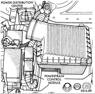

I have a 1998 dodge stratus that wont start motor turns over but still wont start.I change cam senor, crank sensor, computer, coil pak, but still not getting any spark
Thursday, September 20th, 2018 AT 5:10 PM (Merged)
  • 75,992 POSTS
Which engine 2.0 or 2.4 liter?
Check the dark green and orange wire on the coil pack do you have power if not check and test the ASD relay.
BUDDIBAD001
Its a 2.4 and where do I find the asd relay
  • 75,992 POSTS
Dunno which one in the power distribution center but its there -sorry no pic
