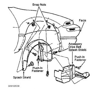

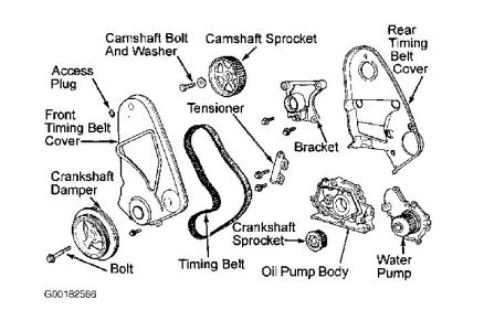

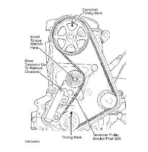

SERVICE WRITER
  • 9,123 POSTS
I would guess a timing belt with tensioner job would run around $500. I don't know that I would call it a do-it yourself kinda job.
http://www.2carpros.com/forum/automotive_pictures/30961_neo1_1.jpg
http://www.2carpros.com/forum/automotive_pictures/30961_neo2_1.jpg
http://www.2carpros.com/forum/automotive_pictures/30961_neo3_1.jpg
http://www.2carpros.com/forum/automotive_pictures/30961_neo4_1.jpg
Friday, May 4th, 2007 AT 10:22 PM
