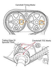

Timing marks on the right spot with #1 cylinder at highest point; still can't get any compression and no start; any final ideas greatly appreciated.
(I initially removed old timing belt w/out aligning timing marks, I then proceeded w/ cylinder head removal and gasket placement ; finally I put everything together and aligned timing marks at the end of job. )

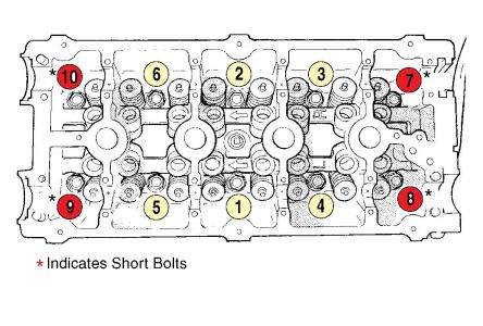

BMRFIXIT
  • 19,053 POSTS
Did the car start before the head gasket job ?
and if so double check your work
Standard head gasket
1step tighten bolts 1-6 to 25 FT LB and 7-10 to 20 FT LB
step 2 : 1-6 to 50 FT LB and bolts 7-10 to 20 ft lb
step 3: repeat step 2
step 4 : tighten all bolts and additional  turn (DO NOT USE A TORQUE WRENCH FOR THIS STEP )
MULTI LAYER STEEL head gasket
step 1 : tighten bolts 1-6 to 25 ft lb and bolts 7 -10 to 20 ft lb
step 2: 1-6 to 50 ft lb and 7-10 to 35 ft lb
step 3 repeat step two
step 4: Â turn on all (DO NOT use torque wrench for this step )
check the rocker
http://www.2carpros.com/forum/automotive_pictures/99387_95_neon_1.jpg

BMRFIXIT
  • 19,053 POSTS
I have the feeling that timing belt off
double check it too
http://www.2carpros.com/forum/automotive_pictures/99387_24dodge_3.jpg
