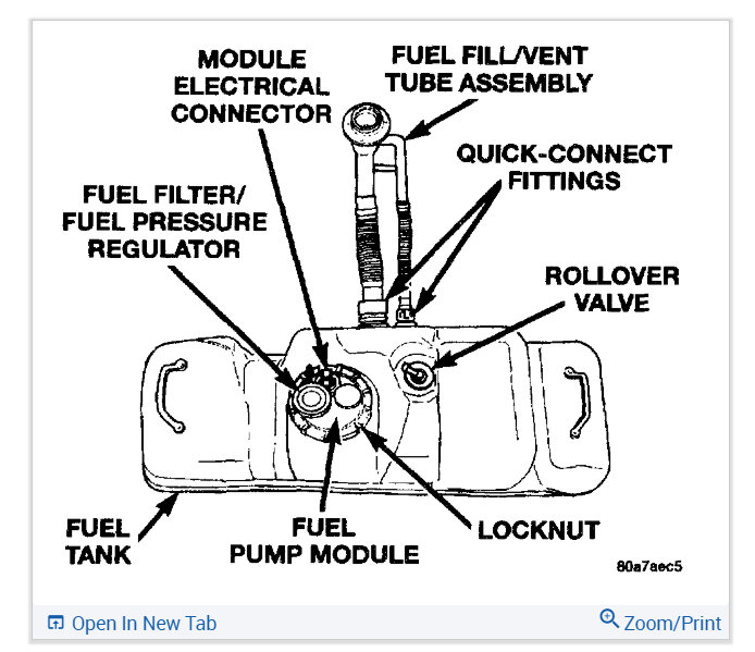

Where is the fuel filter on this vehicle?
Tuesday, June 23rd, 2020 AT 5:25 PM (Merged)
SERVICE WRITER
  • 9,123 POSTS

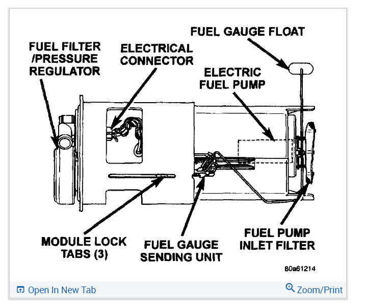

The fuel filter is part of the fuel pressure regulator on top of the tank here are diagrams below to show you how to change it and its location. Check out the diagrams (Below). Please let us know if you need anything else to get the problem fixed.

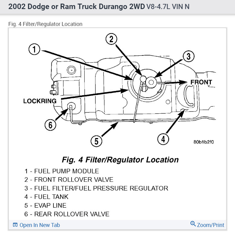

How to get to fuel filter on gas tank
  • 75,992 POSTS

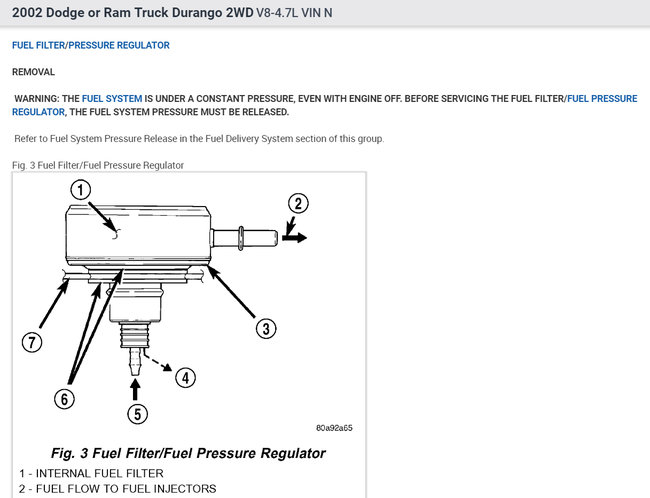

The fuel filter/fuel pressure regulator (Fig. 3) is located at top of fuel pump module on top of fuel tank (Fig. 4).
Fuel pump module removal is not necessary for filter/regulator removal.
Drain fuel tank and remove tank. Refer to Fuel Tank Removal/Installation.
Clean area around filter/regulator to prevent contaminants from entering pump module.

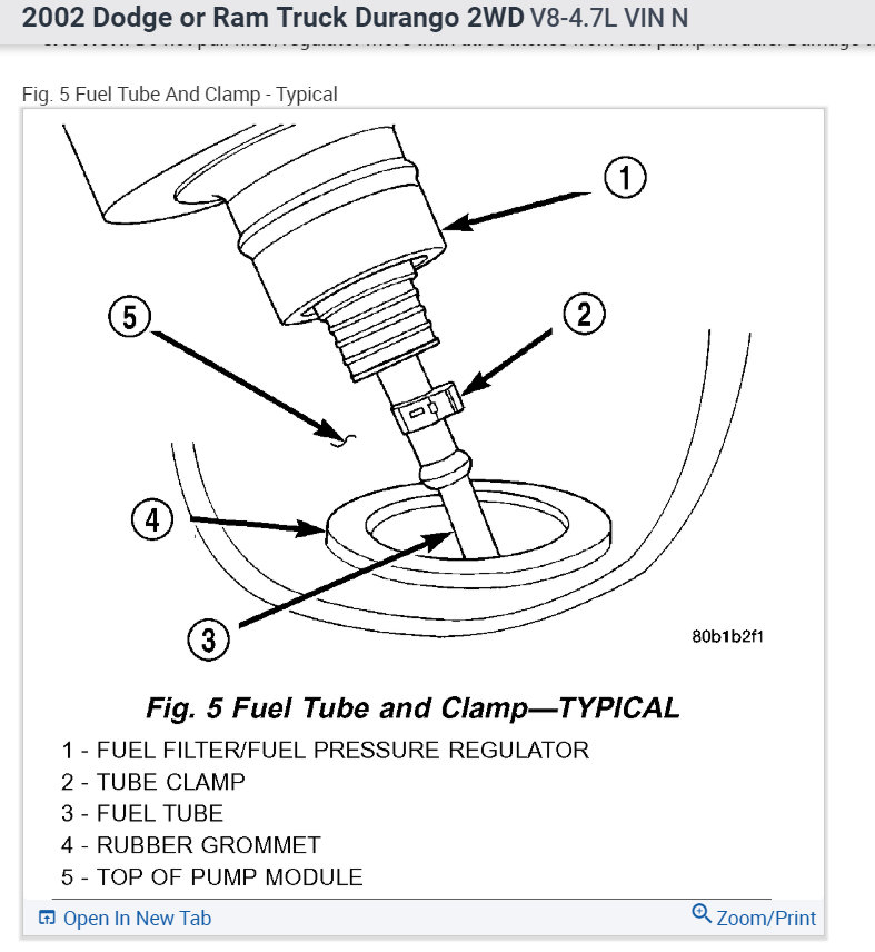

The fuel filter/regulator is pressed into a rubber grommet. Remove by twisting and pulling straight up. CAUTION: Do not pull filter/regulator more than three inches from fuel pump module. Damage to coiled fuel tube (line) may result.
Fig. 5 Fuel Tube And Clamp - Typical
Gently cut old fuel tube (line) clamp (Fig. 5) taking care not to damage plastic fuel tube. Remove and discard old fuel tube clamp.
Remove plastic fuel tube from filter/regulator by gently pulling downward. Remove filter/regulator from fuel pump module.

Fuel filter/fuel pressure regulator is mounted on top of the fuel pump module, located on the top of the fuel tank. No periodic service is required. The fuel filter/fuel regulator should only be replaced if it is clogged or if a diagnostic procedure indicates it is time to do so. No separate frame mounted filter is used.

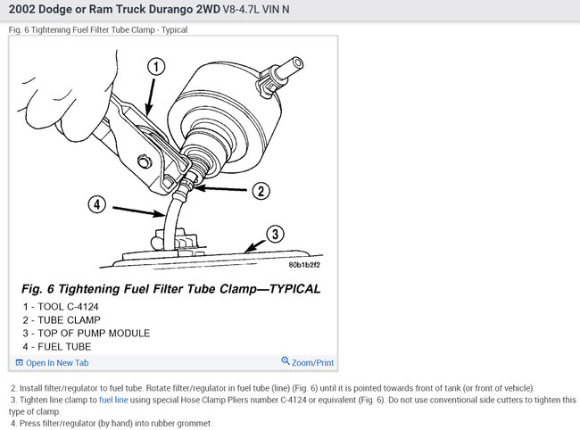

Install the filter/regulator assembly to the fuel tube. Rotate the filter/regulator until it is pointed to line up with the matchmark previously made.
Tighten the clamp to fuel line using Hose Clamp Pliers C-4124 or equivalent.
Slide the convoluted plastic tube up to the bottom of the filter/regulator and install the snap ring.
