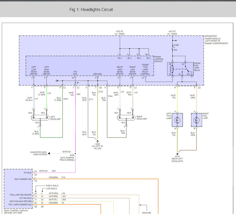

My headlights quit working, but my fog lights still work.

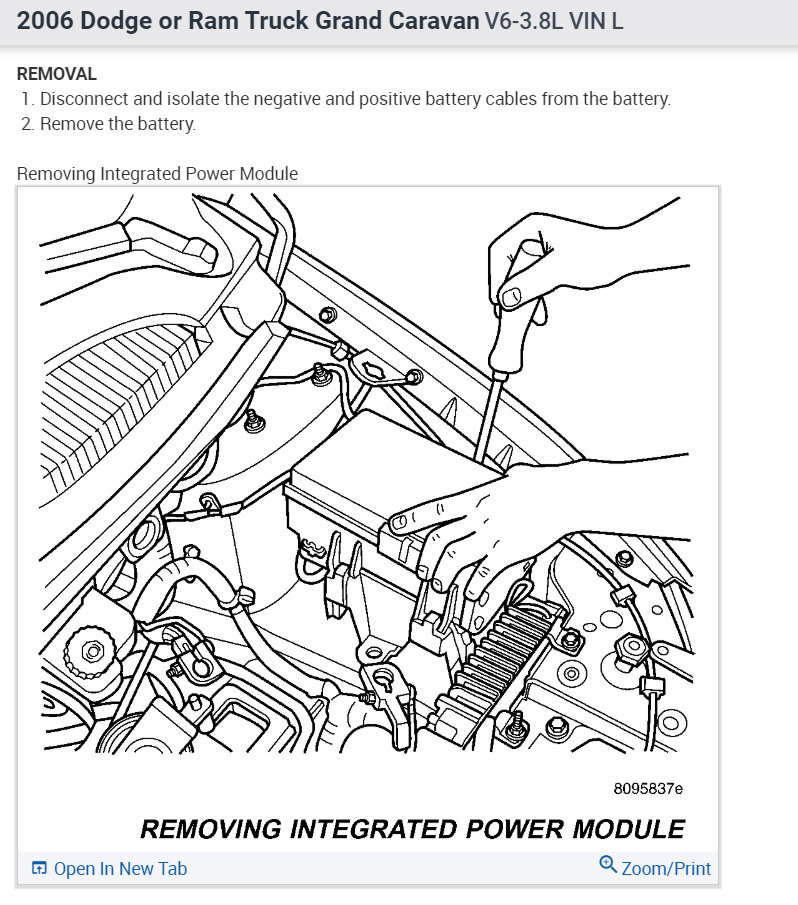

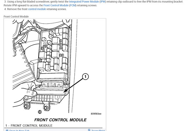

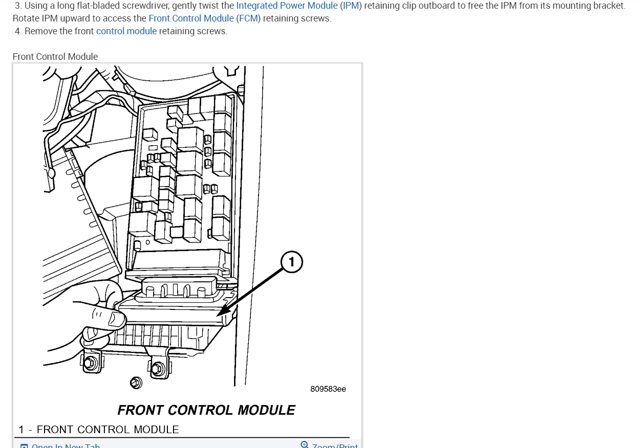

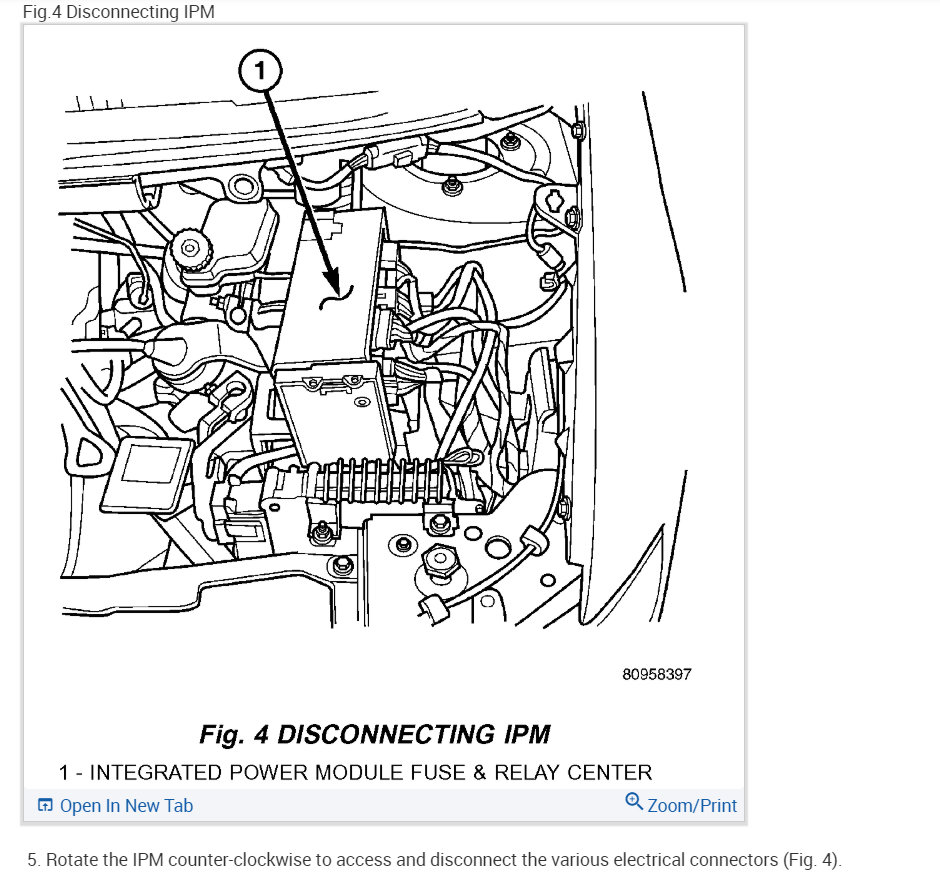

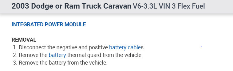

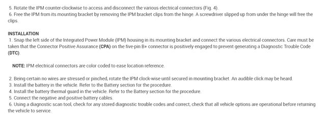

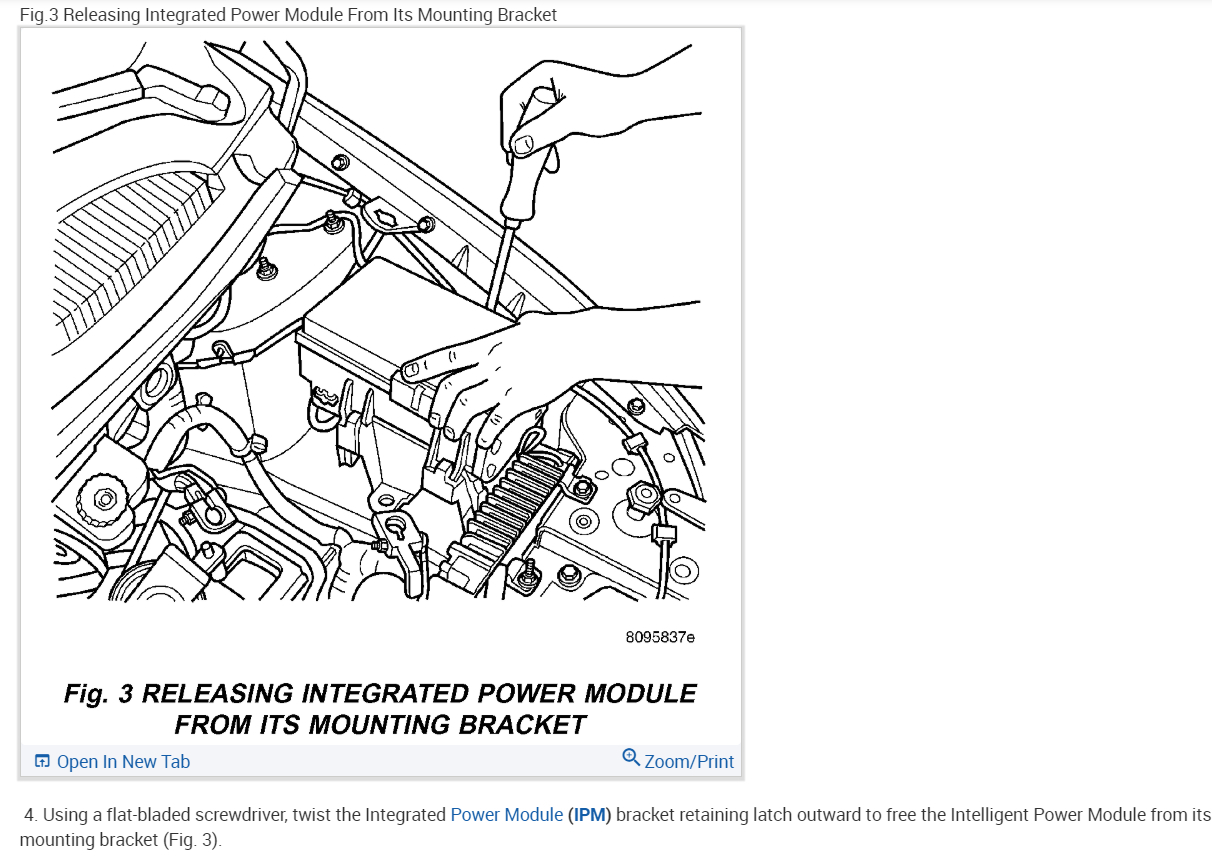

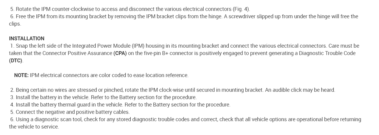

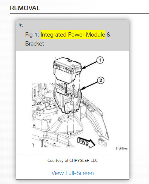

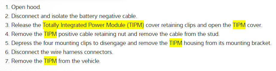

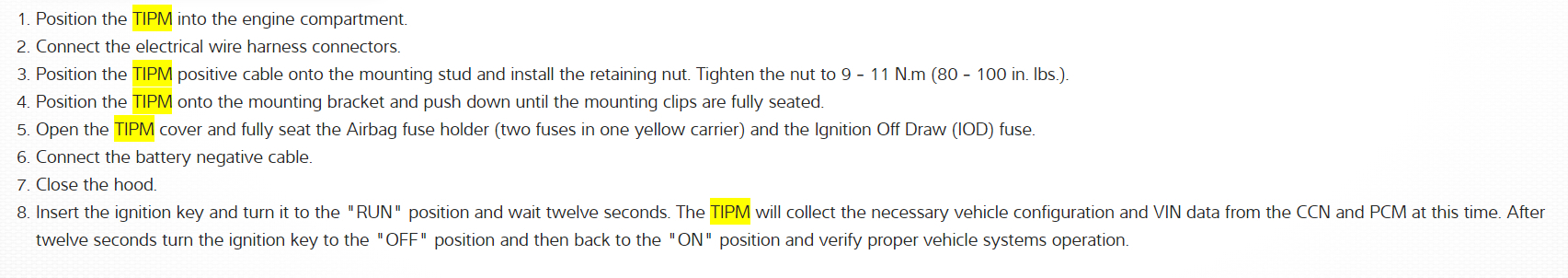

I have seen the TIPM cause this issue but fortunately is is easy to replace because it self initializes. Here is how you replace the unit. Check out the diagrams (Below). Please let us know if you need anything else to get the problem fixed.

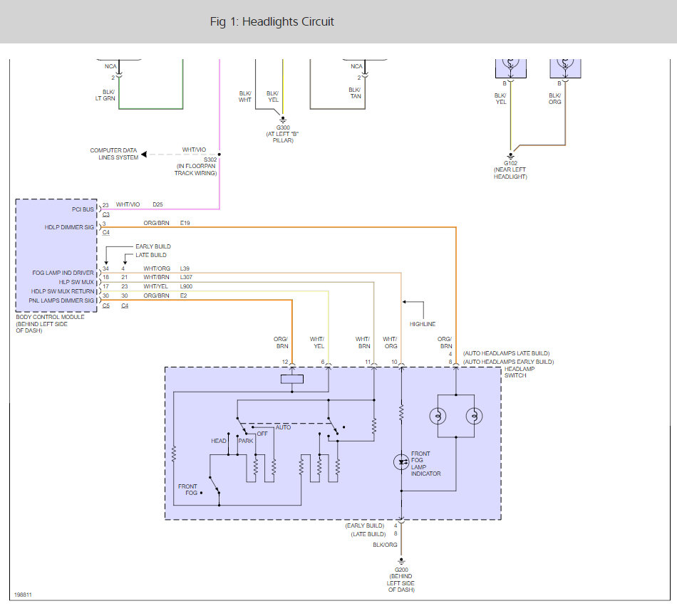

There is a fuse in the integrated control module located under the hood which needs to be checked. Also here is a headlight wiring diagram (below) to test for power going into and out of the module.
and
Please let us know what happens so it will help others.

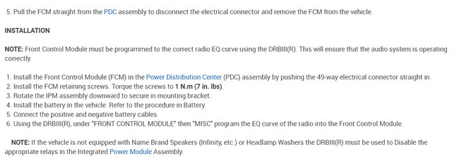

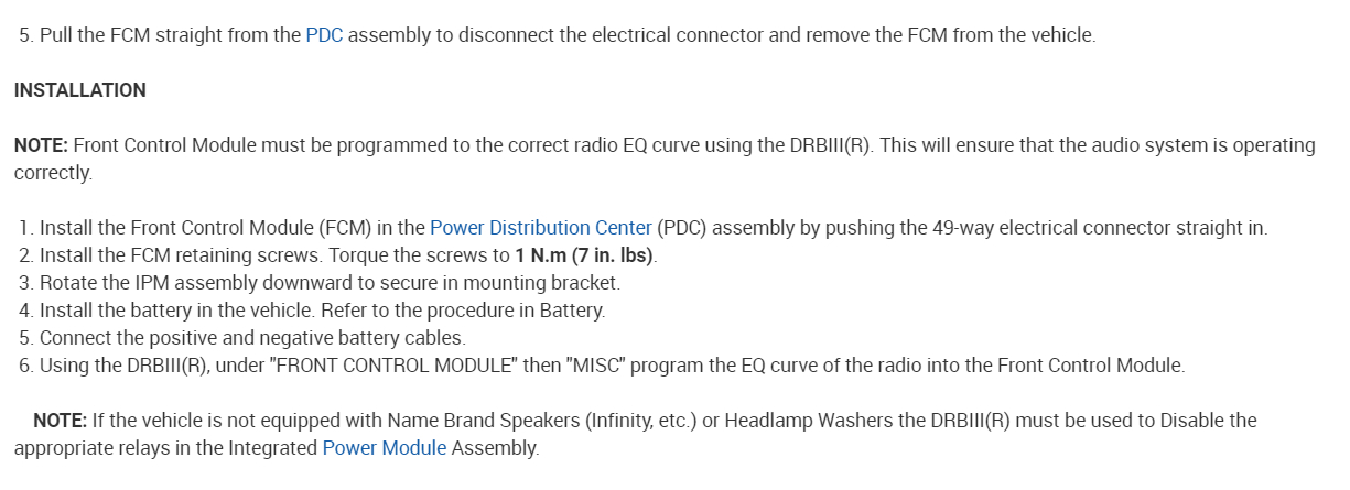

CAn you send a pic of what you are talking about? It sounds like the TIPM is the problem which is easy to replace because it self initializes here is instructions to do so in the diagrams below.

Did you check for voltage at the bulb circuit? The headlamp switch sends signal to bcm, bcm sends data signal to front control module, front control module controls headlamp driver. In the diagram, the top wires are voltage for high and low beam at the headlamp. Bottom wire is ground. Check applicable fuse/s for front control module. Check for applicable trouble codes.
