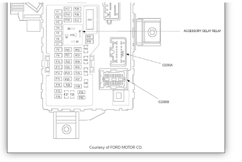

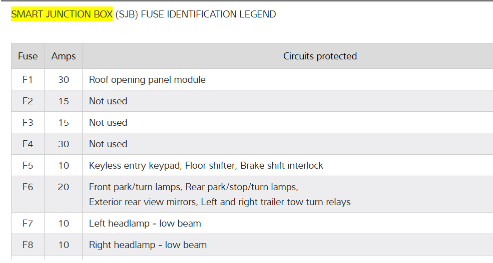

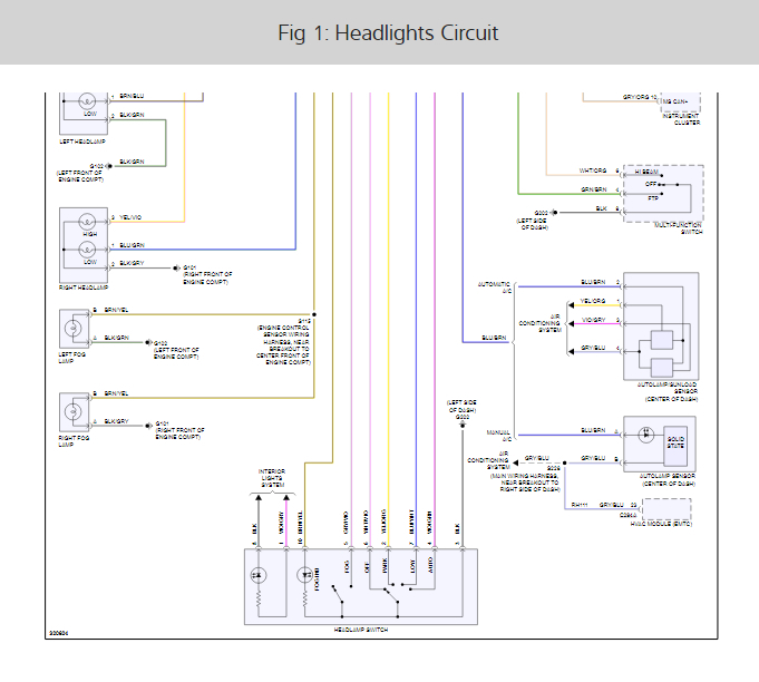

Low beam head lamps, dull amber color. Bought bright white bulbs. High beam lights nice and bright but not low beam lights.
Sep 30, 2019 at 11:00 AM
SCGRANTURISMO
  • 4,897 POSTS

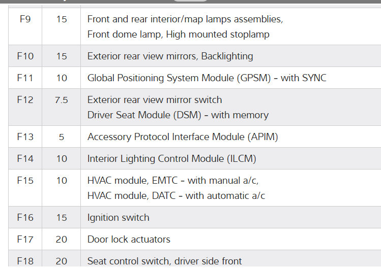

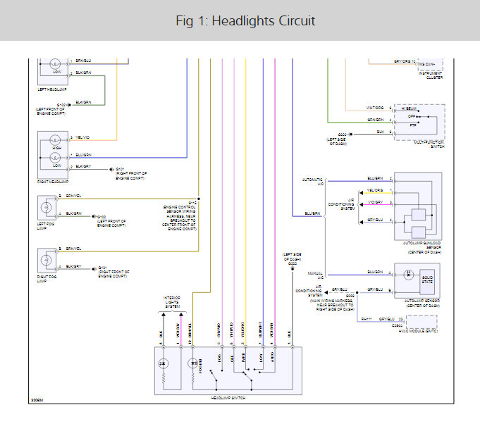

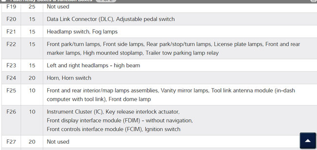

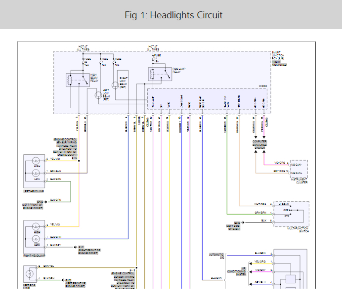

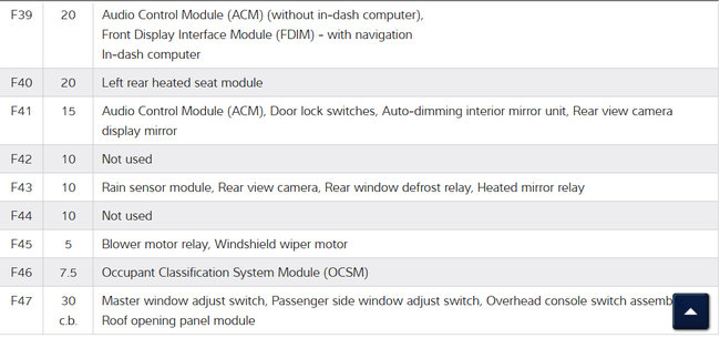

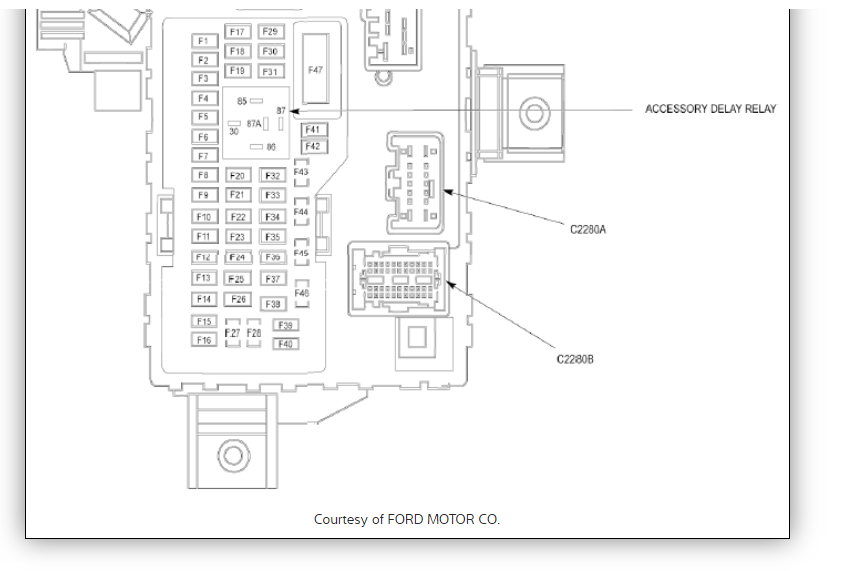

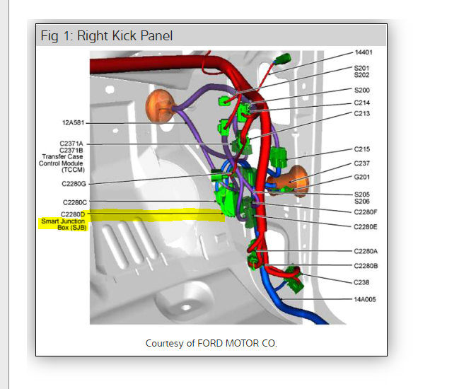

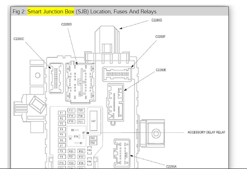

This could be a problem with the Field-Effect Transistor which is located in the Smart Junction Box also known as the Generic Electronic Module. They control the amount of current that is allowed to go through to each headlight. In the diagrams down below I have included diagrams with the location and layout with callout of the Smart Junction Box on your vehicle. I have also included a wiring diagram of your headlight circuits for you as well for reference. Please go through these guides and get back to us with what you are able to find out.

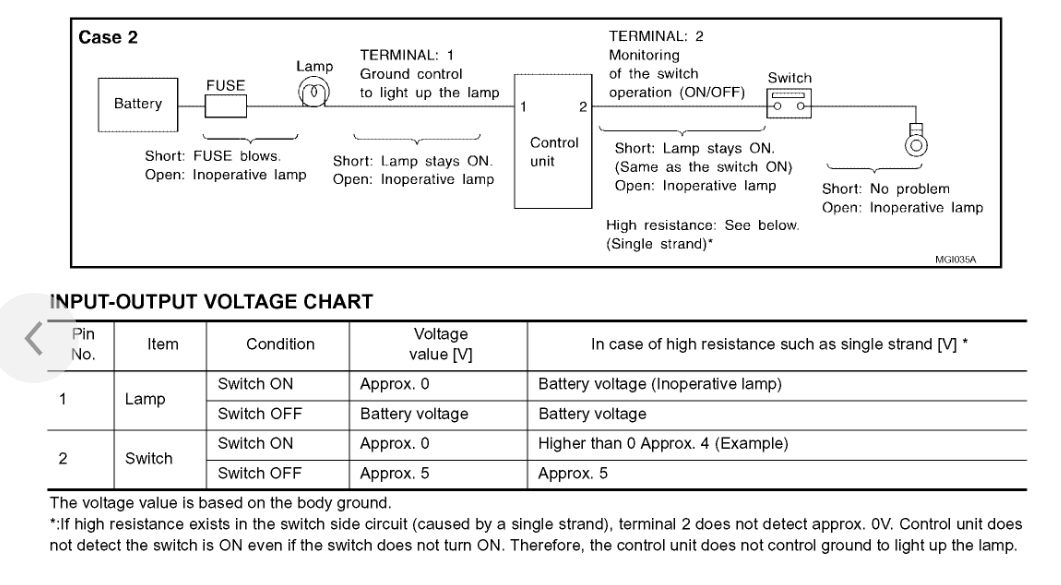

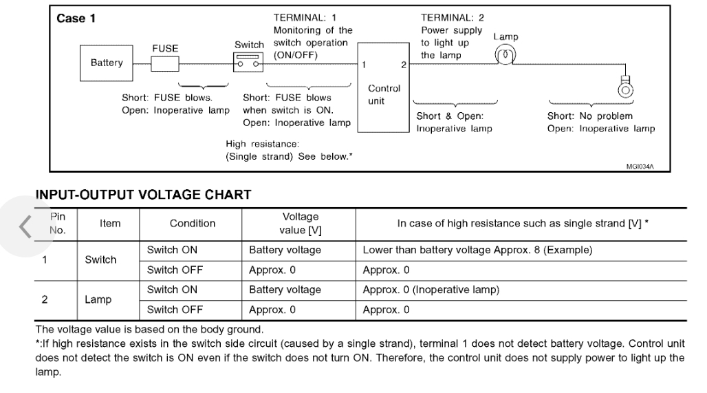

Checked and cleaned the electrical connection but no help. Bought a set of led head lamps and converted to led, can see to drive but no difference between high and low beam. Back original problem dim low beam head lights but high beam are okay, so i checked the voltage i have 12.09 volts (roughly) on low, both sides. i have 12.45 on high, both sides( truck not running)but with lights on auto and lights not on, I have 8.09 volts on the driver side low beam, but not on passenger side. Bad head lamp switch or shorting to ground some where?
Oct 27, 2019 at 3:03 PM
SCGRANTURISMO
  • 4,897 POSTS
Hello again,

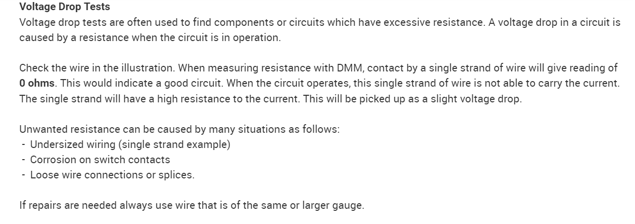

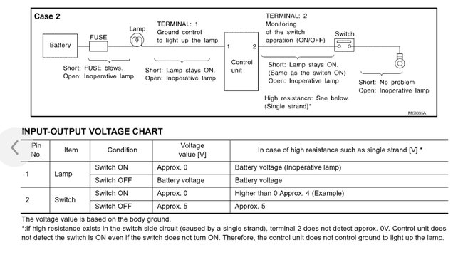

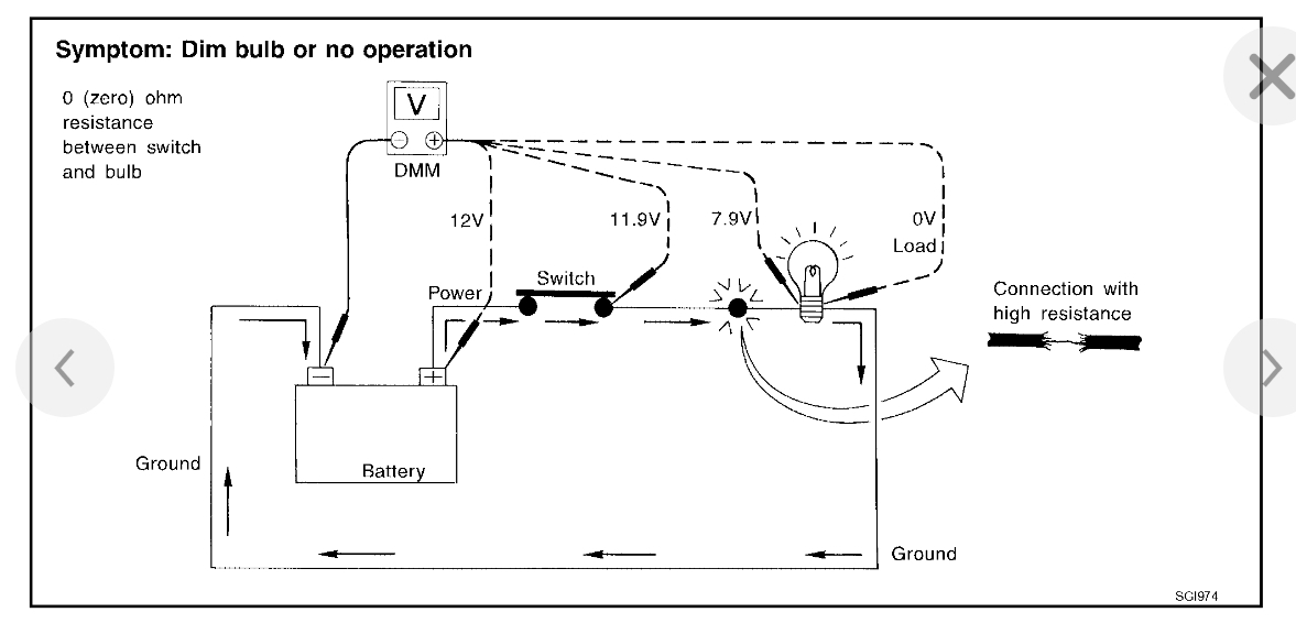

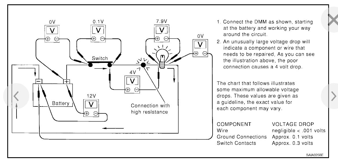

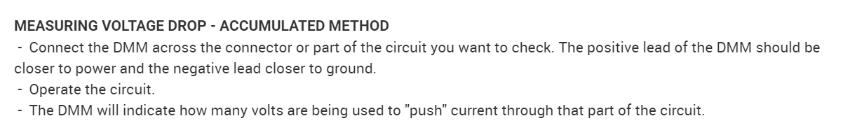

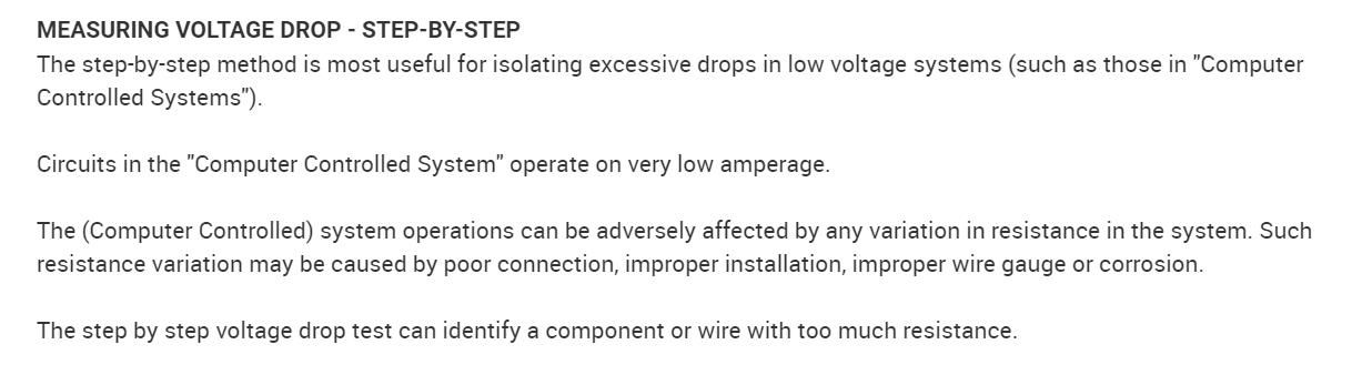

There is unwanted resistance somewhere in the "AUTO" circuit on your headlamps. The best and preferred way to determine where "unwanted" resistance is in an electrical circuit is the voltage drop method. I have included a guide for how to perform voltage drop testing in an automotive electrical circuit. I would first check my headlamp switch first and the the wire going from pin 4 of the headlamp electrical connector[auto pin]. Repair as necessary and get back to us with what you find out.
