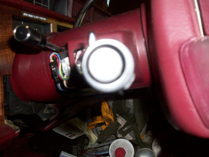

Ok so when I turned on the cruise it came up with e.7.0 then when I hit the brake and did the other things it said e.0.0 and it kept flashing back and fourth from e.7.0 to e.0.0

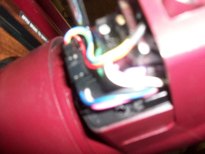

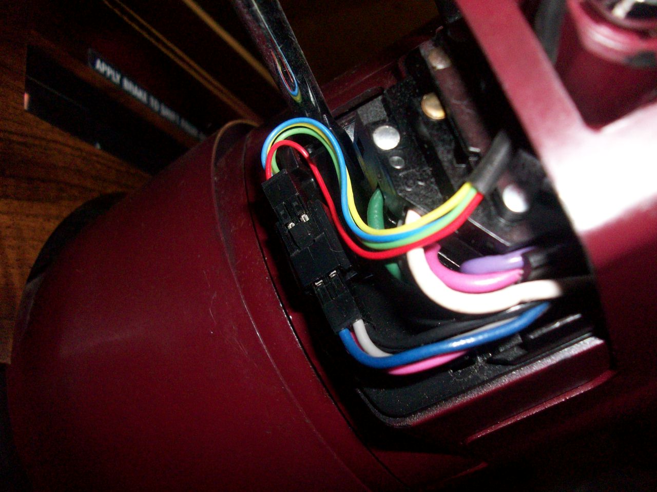

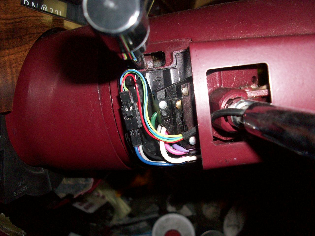

pop the lever connector out in your pics. and test the pink wire for voltage on both sides of the connector. with a test light then u will need to ck the ground next stick a paper clip in the connector on the pink wire then put the test lights clip to it.then probe the black wire at connector.if it lights the ground is good.start here all testing should be done with the key turned on and not started

ok so I did what khlow and what cadieman said. I grounded one probe to the bady the grey wire came up with 0.01v. I put everything back together. I tested both sides like you said and their was power. I also hooked the two connectors and it was 12 volts on one side and 0.01 on the other and I flipped the connector on the other side and it wasthe same. so their is voltage going to the connector I would assume.

i know there is voltage coming to the connector because your reading voltage from the pink and black wires.this tests the voltage on the pink and it tests the ground to be good.just test the opposite side of the connector the same.look like blue and yellow and black stripe.do u read voltage their going to
