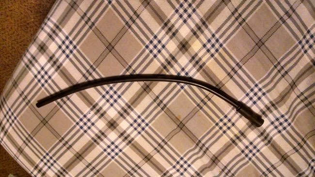

This was on the ground under the car.
Image (Click to make bigger)
Tuesday, January 8th, 2019 AT 12:18 PM
MECHANIC
52,796 POSTS
Looks like a vacuum line from somewhere. This will not cause the no start.
