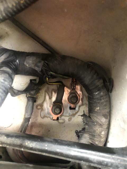

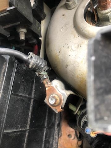

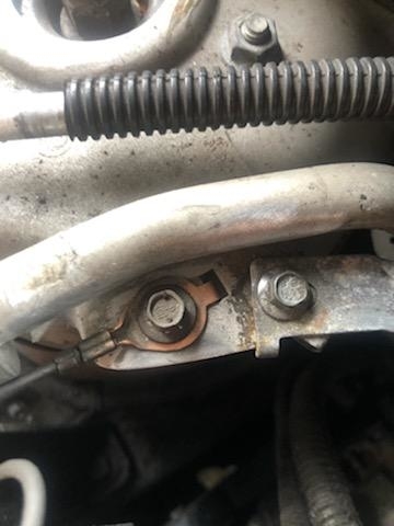

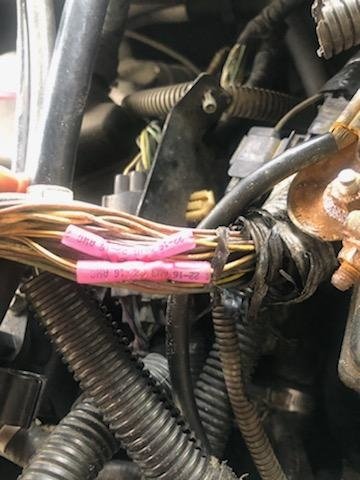

We found out the problem. There was a short in the wiring harness to the computer hence the reason why we had no power to the fuel injectors, fuel pump, fuel inertia switch or fuel relay. The opening in the wire harness was caused by corrosion. After completing everything the total came out to $313.90.

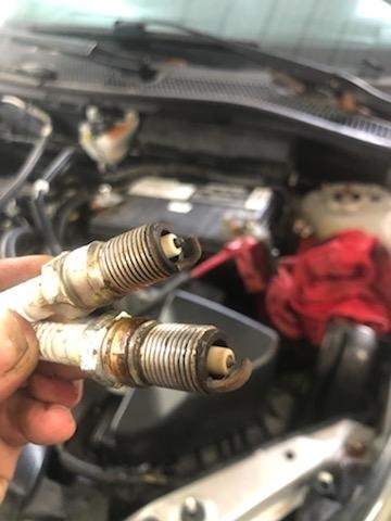

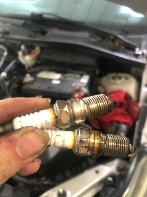

New plugs new coils had tune up like,
4 months ago,
But I guess could need again cause of all it just went thru. Lol

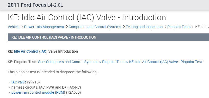

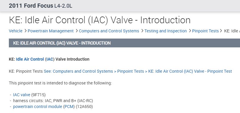

As far as the steering, it sounds like you are losing power assist when the engine RPMs drop.
If it is stalling when stopping or a light acceleration, the first thing I would be looking for is an engine vacuum leak.
Here is a link that explains how it's done:

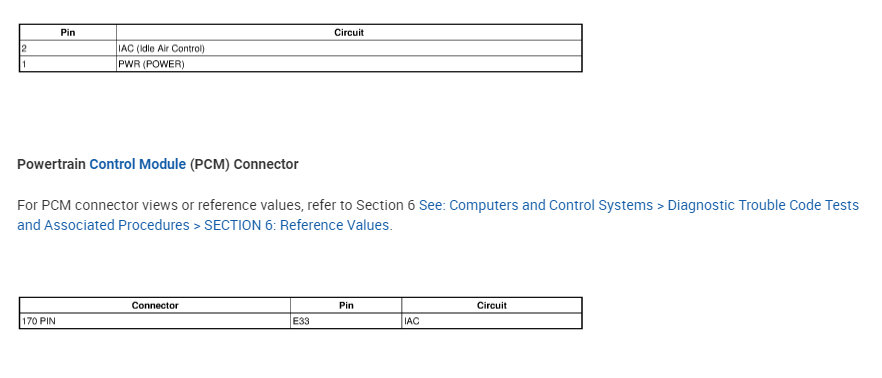

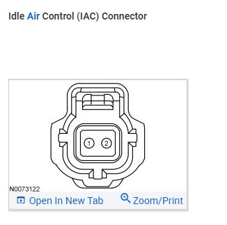

If you find no leaks, then suspect there is an issue with the idle air control valve. On most vehicles, the IAC can be serviced or replaced. On this vehicle, neither servicing nor replacement is possible. The throttle body will need to be replaced.
Let me know. Also, I attached diagnostics below for testing the IAC circuit. Let me know if you are comfortable performing them.
