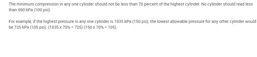

If I remember correctly it was like 123 to 126 and yes the tachometer moves up a little and the check engine light is on.
Monday, March 23rd, 2020 AT 10:00 AM
  • 52,797 POSTS
Compression is low.
https://www.2carpros.com/articles/the-reasons-for-low-compression
The crank sensor is working.
Any idea on the fuel pressure?
Can you give me the code?
If you spray some starter fluid in the air filter, does it start and stall?
