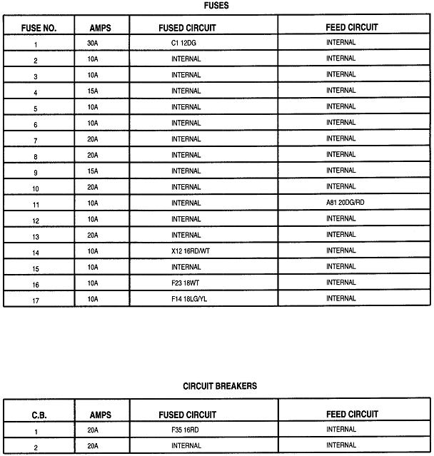

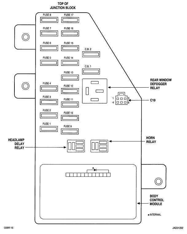

That means the communication link between the computers is dead. That originates in the Body Computer. Every time I've run into that, it was related to blown fuses. Check for those under the hood and inside the car. I can't find a drawing showing the fuse box inside, but as I recall, there's a cover to snap off on the left side of the dash.

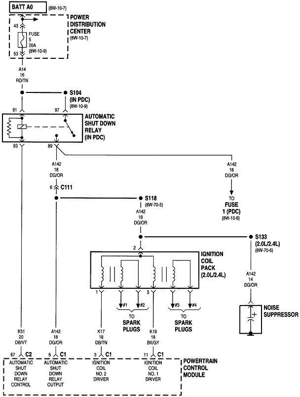

The lowest percentage of crank/no-starts are caused by loss of just spark. By far most are caused by loss of spark, injector pulses, and fuel pump. All of these get their 12 volts from the automatic shutdown, (ASD) relay. The Engine Computer turns that relay on for one second when you turn on the ignition switch, then again during engine rotation, (cranking or running).
The first thing to do is to determine if the ASD relay is turning on. If you don't have a scanner, you can do that with a test light. Connect it to the dark green/orange wire at the ignition coil pack or any injector. It should light up for one second when you turn on the ignition switch, then again when you start cranking the engine.

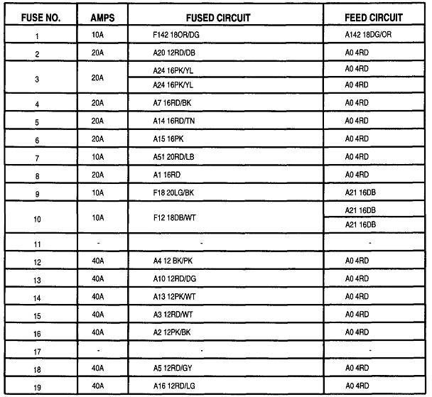

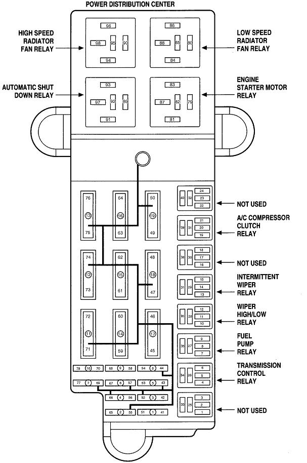

First check fuses 5 and 8 under the hood. Those are both 20 amp fuses. If they are okay, put your fingers on the automatic shutdown relay and the fuel pump relay, then feel if they click when a helper turns the ignition switch on. You should feel both of them click once, then again about one second later. Listen for the hum of the fuel pump for that one second.

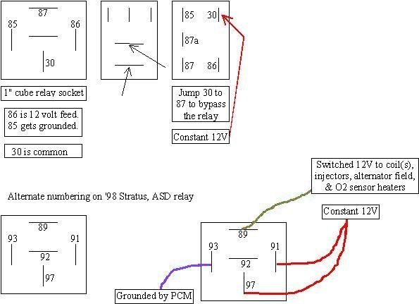

So I've narrowed it down to I believe the automatic shut down relay because the 86 spot has constant power even with key off, there for there's an open circuit. What I don't know is how to correct that? Can you tell me or maybe send me a picture of where the body to engine grounds are?
Thursday, February 14th, 2019 AT 10:26 AM
CARADIODOC
  • 34,489 POSTS
For some reason the engineers used a different numbering system for the relay terminals on the Breeze and Stratus. You'll see in the diagram that terminals 91 and 97 both have 12 volts all the time. While the numbering is different, the physical layout of the terminals is the same as that shown on the very common top left relay in the second drawing. That equates to terminals 86 and 87 in that more common pattern.
An "open circuit" means there's a break in it. If that were the case, you'd have 0 volts on terminal 86, then we'd have something to look into. What you found is correct. Does that relay click two times when a helper turns the ignition switch on?
The ground wire you're asking about is the smaller negative battery wire. The fat one always bolts to the engine or transmission because it has to carry the very high starter current. The smaller one bolts to the car's sheet metal body. That one carries all the return current for the lights, radio, wipers, computers, and other electrical accessories. If that wire is corroded off or broken, everything will be dead inside the car.
