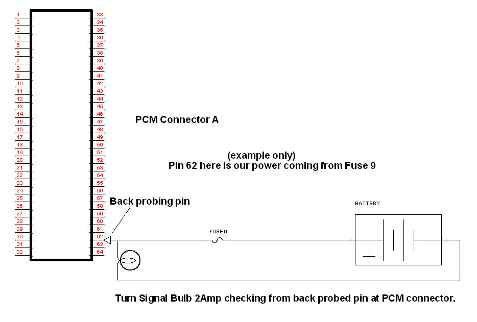

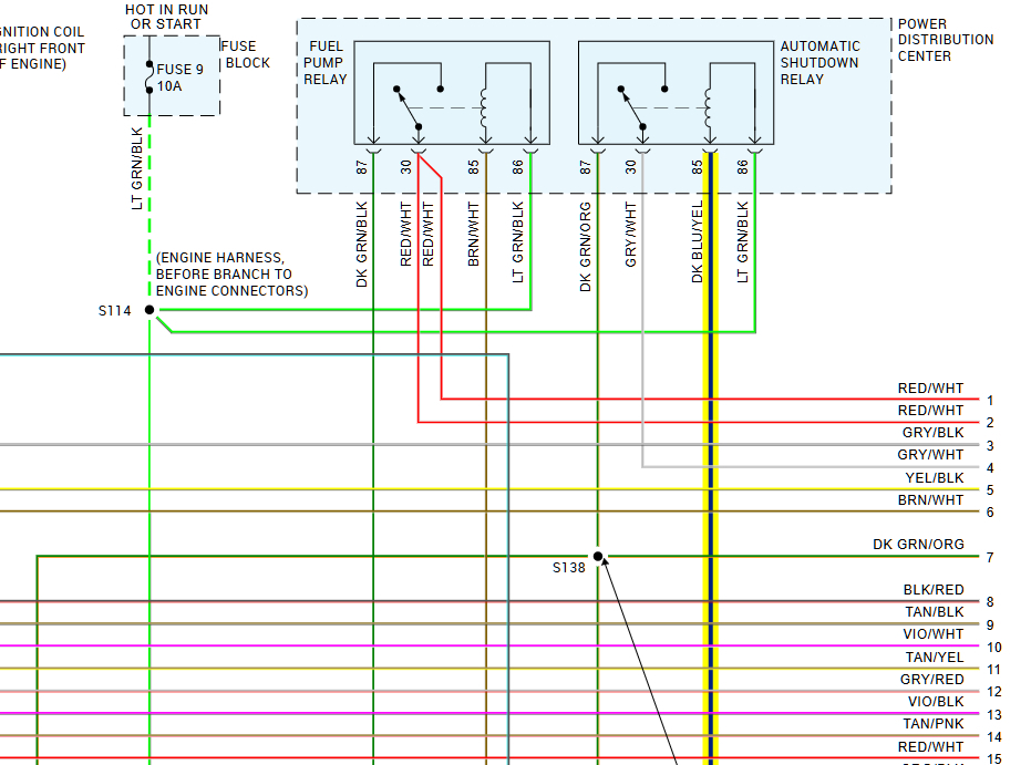

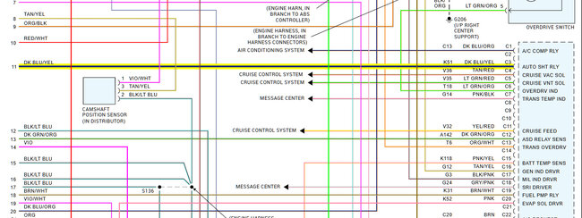

What about the ASD relay control wire to the PCM, with the relay out do you have continuity to PCM connector C pin C3? Thats the wire the PCM should ground to activate the relay. And as for load testing powers and grounds, I always use a higher amperage bulb to make sure that wire can carry enough current. So for example, if there is a wire that is broken some where but there is still one strand of wire that is not broken, the wire will not carry current, but will test fine with a resistance test. Hence the reason for load testing.
So you would back probe the PCM connector that has the power wire you want to check, in this case A2 and use the back probe to power the test light. And in the case of a Ground wire, you would hook the test light to B+ and use the back probed PCM pin (which goes directly to ground) to ground the test light.
But you want to remember not to pull high amperage through the PCM, only using the wires that come directly from a fuse or relay, and wires that go directly to ground. If you need more info on this. I think I have some diagrams to help.

Heres my load testing diagram, excuse my terrible artwork.

Something else to note. With the key On, you should read 12volts on the ASD relay control wire at the PCM connector C pin C3, you should read 12volts on the control wire until the PCM actually grounds the relay, then the voltage will drop to zero. This is another testing method. It can be done with any actuator that is ground side controlled, such as a fuel injector. Just something you can try. The wire is a DarkBlue/Yellow wire. The PCM should turn on the ASD for 2 seconds the same as the Fuel pump relay prime, and then will require a crank signal to reactivate the ASD and fuel pump relays.
If all else fails, when you have done all the testing you can, we can try grounding the ASD relay and see if the PCM comes to life, but this is the last thing to do because we need to be very careful grounding PCM circuits.
