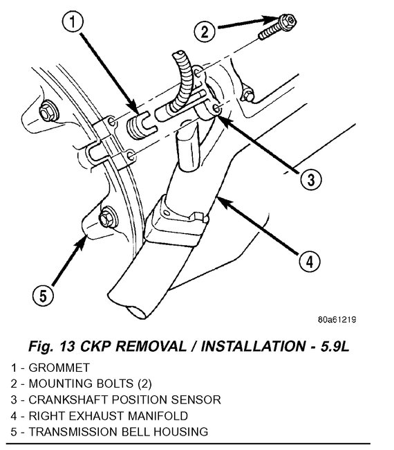

The easiest way to test the sensor is with a live data scanner. If it is bad, you first won't have spark and second, there will be no RPM signal when you are cranking the engine. If you find it is bad, here are the directions specific to your vehicle for replacement. The attached pic correlates with the directions.
2002 Dodge or Ram Truck RAM 1500 Truck 4WD V8-5.9L VIN Z
Procedures
Vehicle Powertrain Management Sensors and Switches - Powertrain Management Sensors and Switches - Computers and Control Systems Crankshaft Position Sensor Service and Repair Procedures
PROCEDURES
Fig. 13 CKP Removal/Installation - 5.9L
Pic 1
REMOVAL
The sensor is bolted to the top of the cylinder block near the rear of right cylinder head.
1. Raise vehicle.
2. Disconnect crankshaft position sensor pigtail harness from main wiring harness.
3. Remove two sensor (recessed hex head) mounting bolts.
4. Remove sensor from engine.
INSTALLATION
1. Position crankshaft position sensor to engine.
2. Install mounting bolts and tighten to 8 Nm (70 in. lbs.) torque.
3. Connect main harness electrical connector to sensor.
4. Lower vehicle.

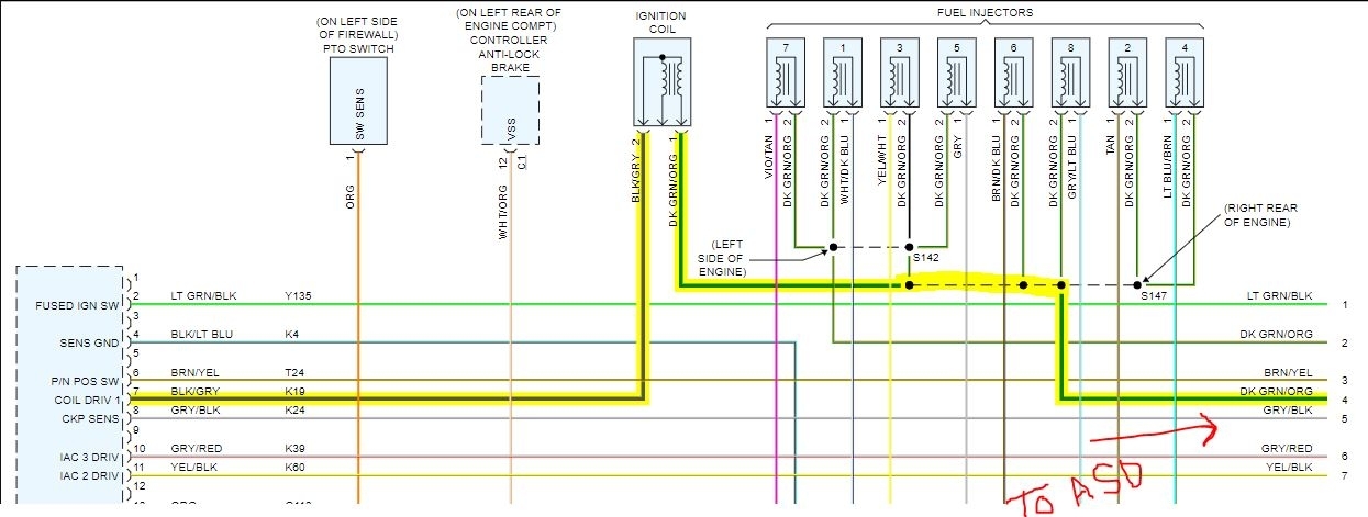

If you are getting an RPM signal, then the crank sensor is working. So that is eliminated. Next, is the ASD, could be an issue. In addition for checking if there is spark, also check if there is an injector pulse at the injectors. If you look at the attached picture, you will see how they are tied together.
Confirm both spark and an injector pulse. If both are missing, we will try the ASD relay. If that is good, we will need to check the coil itself.

Last but not least. If there is an injector pulse but no spark, here is what I need done. Unplug the connector at the coil. It is a two wire connector. One if the wires is black and gray which goes to the PCM and the other is the power supply (dark green / orange) from the ASD. I need to know if when the engine is cranking if the black/gray wire is getting an on and off ground. If it is, check the other wire for power with the key in the run position. You will need to crank the engine to check.
Here is why. The PCM opens and closes the ignition coil ground circuit for ignition coil operation. If the black / gray isn't showing continuity to ground on and off, there is either an issue with that wire, the PCM connector, or the PCM. On the other wire, battery voltage is supplied to the ignition coil positive terminal from the ASD relay. If the PCM does not see a signal from the crankshaft and camshaft sensors (indicating the ignition key is ON but the engine is not running), it will shut down the ASD circuit. We know there is a crank signal since you found an RPM signal, so then we have to go to the ASD.

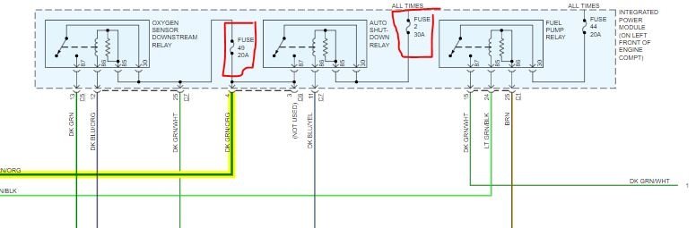

I need you to check two fuses in the under hood fuse box. See the attached picture. If the fuses are good, confirm there is power to the circuit.
Tuesday, November 26th, 2019 AT 5:55 PM
LANCE GAGNE
  • 34 POSTS
Continuity on both fuses. Tested the number 2 socket with key on and got a test light on. Number 49 socket only lights when cranked then shuts off.

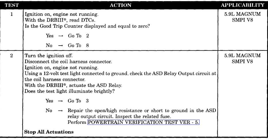

Okay, that sounds like all is working. That leads me to the coil itself. To do the next test you need a scanner that can actuate the ASD. Is that something you have? If so, take a look at the attached picture and confirm there is power to the coil from the ASD. If there is, replace the coil. I know this is a pain, but to determine the actual problem, this is what is required.

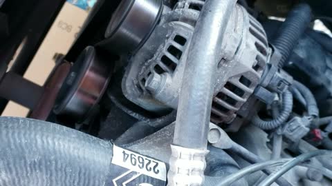

Got it started today. Acts like its slow to start, turns over really slow then starts. Not sure what I did other than put water in the battery and put it on the charger. Pushed on all connections. But it started. Sounds bad though, loud tick and a kind of squeal. I will send a video.
Thursday, December 12th, 2019 AT 2:29 PM
  • 110,194 POSTS
The tick sounds like a lifter. Is the oil clean and full? As far as the noise, it could be coming from the belt or one of the belt driven accessories.
If it is still turning slowly, it sounds like the battery. I would suggest having it load tested by a parts store to see if it is good. Also, try something for me (and don't laugh). The noise can be a few things, so I want to eliminate the belt. Start the engine and while you hear the noise, pour a small amount of water on the belt and see if the sound changes. Make sure you protect your eyes and wear old clothing. Water can spray at you.
