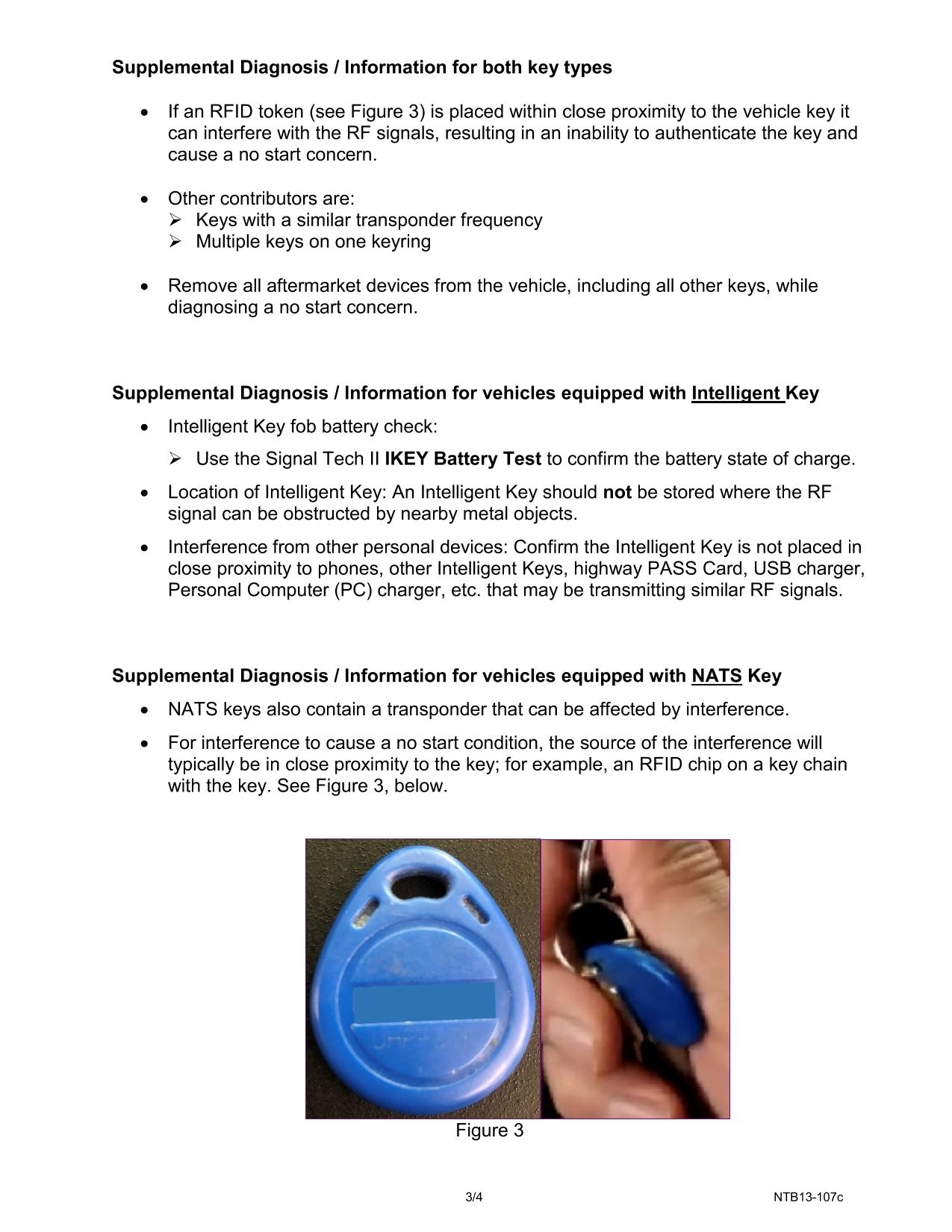

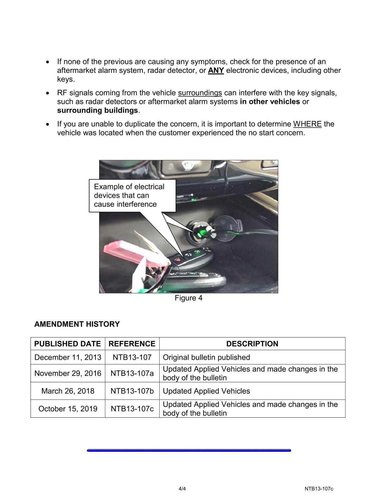

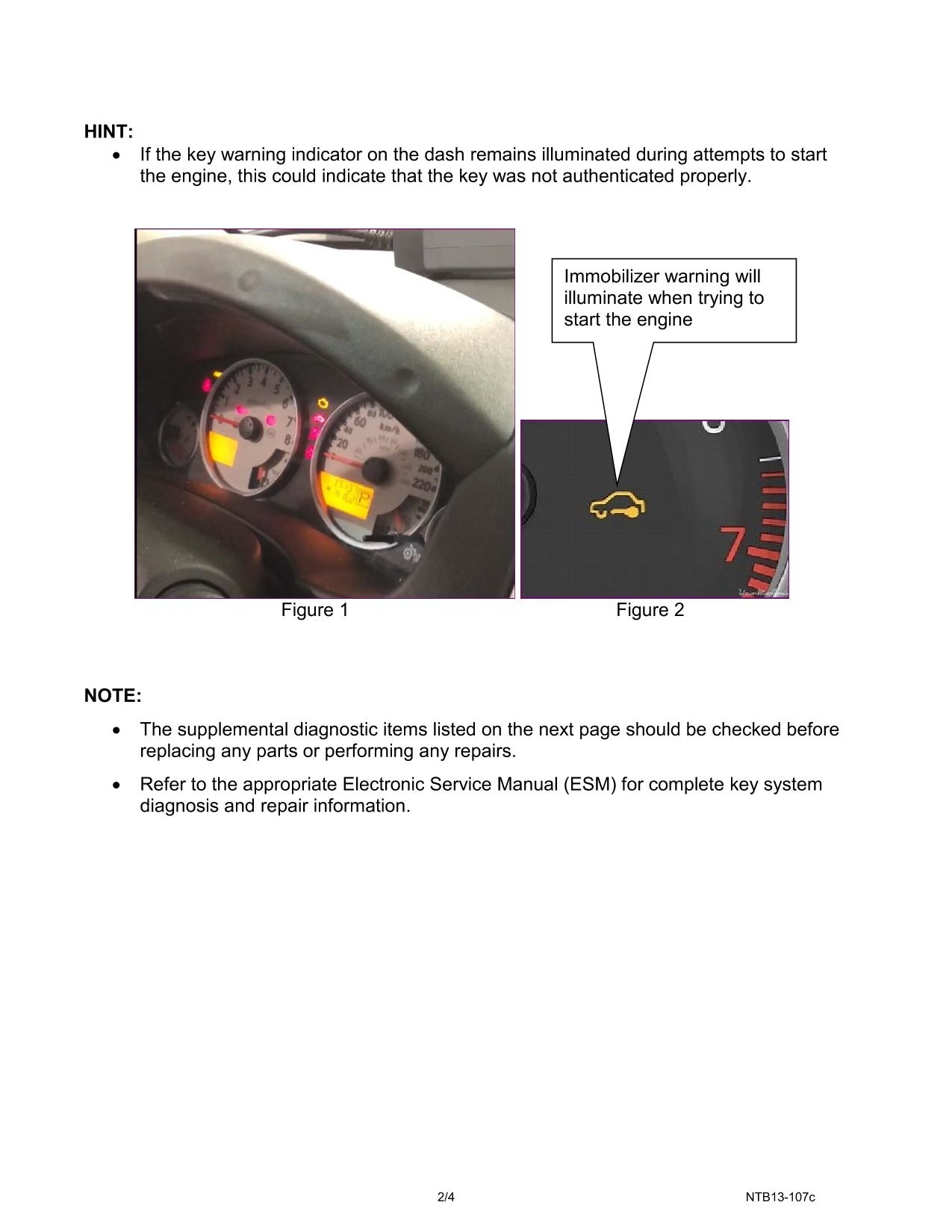

There was a technical service bulletin related to the key not being detected. Take a look through this and let me know if it mirrors what you are experiencing and if the diagnostics help.
See the attached pics.

Good morning, after going through the technical service bulletin, it is obvious that the vehicle key is not the problem and the immobilizer warning light will not illuminate during attempt to start the vehicle. The "service engine very soon" light could not be found on the combination meter any longer. Is there any technical bulletin concerning the PCM?

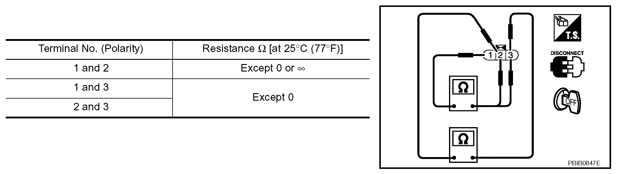

Okay, let's start at the beginning. Here are the diagnostics for testing the ignition coil and power transistor. Do this and let me know what you find.
If you have already done this, let me know.
__________________________________
2006 Nissan-Datsun Truck Pathfinder 4WD V6-4.0L (VQ40DE)
Component Tests
Vehicle Powertrain Management Ignition System Testing and Inspection Component Tests and General Diagnostics Component Tests
COMPONENT TESTS
Component Inspection
IGNITION COIL WITH POWER TRANSISTOR
CAUTION: Do the following procedure in the place where ventilation is good without the combustible.
1. Turn ignition switch OFF.
2. Disconnect ignition coil harness connector.

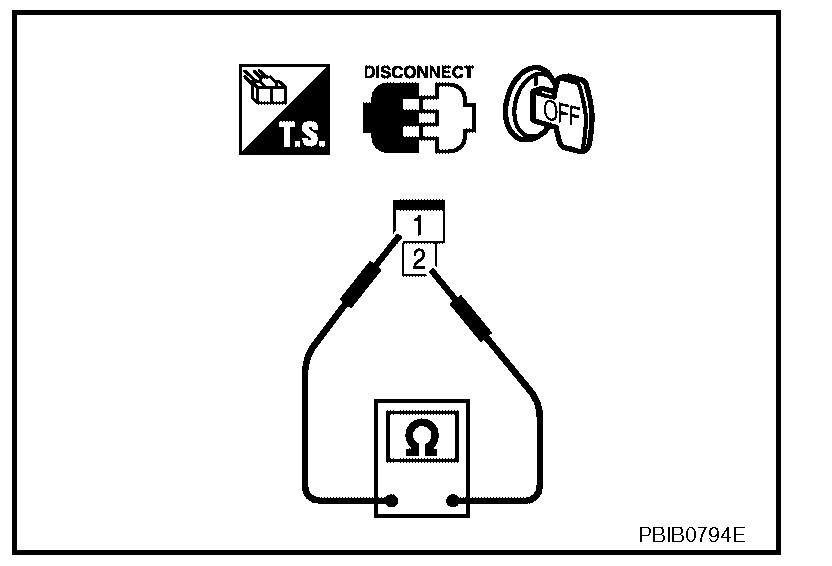

Pic 1
3. Check resistance between ignition coil terminals as follows.
4. If NG, Replace ignition coil with power transistor.
If OK, go to next step.

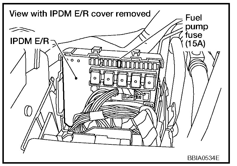

Pic 2
7. Remove fuel pump fuse in IPDM E/R to release fuel pressure.
NOTE: Do not use CONSULT-II to release fuel pressure, or fuel pressure applies again during the following procedure.
8. Start engine.
9. After engine stalls, crank it two or three times to release all fuel pressure.
10. Turn ignition switch OFF.

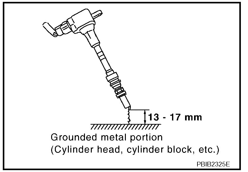

Pic 3
15. Fix ignition coil using a rope etc. With gap of 13 - 17 mm between the edge of the spark plug and grounded metal portion as shown in the figure.
16. Crank engine for about three seconds, and check whether spark is generated between the spark plug and the grounded part.
Spark should be generated.
CAUTION:
- Do not approach to the spark plug and the ignition coil within 50cm. Be careful not to get an electrical shock while checking, because the electrical discharge voltage becomes 20 kV or more.
- It might cause to damage the ignition coil if the gap of more than 17 mm is taken.
NOTE: When the gap is less than 13 mm, the spark might be generated even if the coil is malfunctioning.
17. If NG, Replace ignition coil with power transistor.
