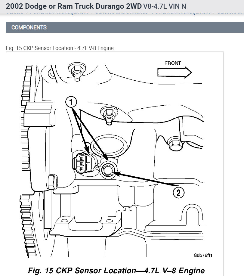

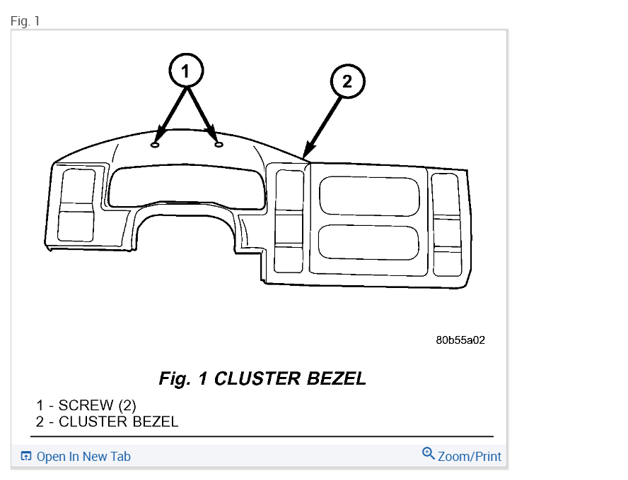

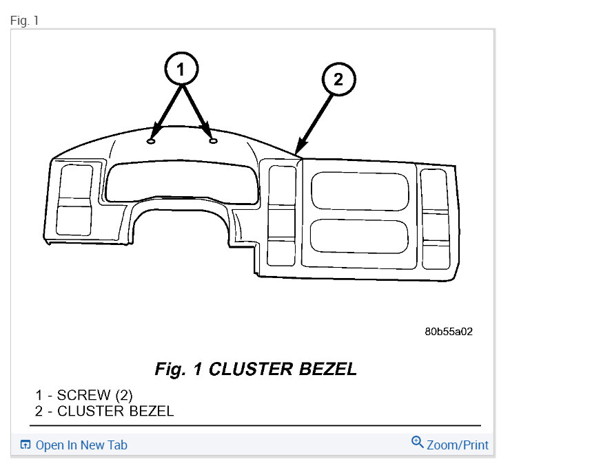

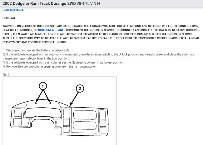

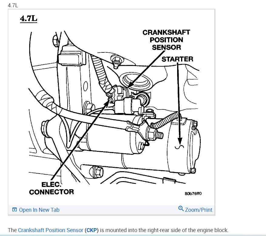

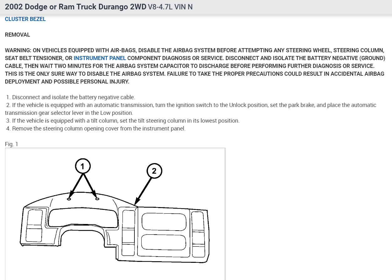

Also, I have seen the crankshaft sensor cause the RPM problem and I have seen the cluster be bad to cause the no BUS issue. Here is the location of the crankshaft sensor and how to remove the cluster so you can send it out for testing. Check out the images (below). Let us know what happens and please upload pictures or videos of the problem so we can see what's going on.

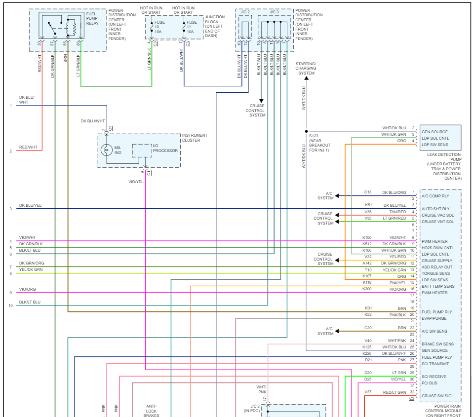

Recap, still have crank but no start, I have checked the +5v reference for the sensors. Unplugged all the sensors, TPS, temperature, idle control, crank, cam, transmission connector removed, ABS disconnected. None of these cleared the no bus. Also, the code scanner reports no codes, freeze frame does show TPS, and I can depress the gas pedal and see the % of throttle change. Fuel pumps work fine, jumped over the relay it starts right up. When this first happened and it would not start, I was messing around and it started, ran for 1 minute then just stopped and been dead ever since. I have also checked the wire harness and see no issues, and also checked power and ground to the PCM all good. What can it be? Security system? The PCM?

I think you have a bad cluster (shorted) which will cause these issues, but to be sure you need to do a CAN scan, you can get a CAN scanner (Controller Area Network) which will work on most cars from Amazon.

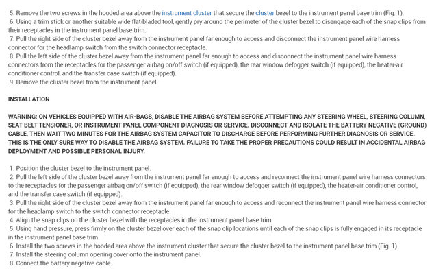

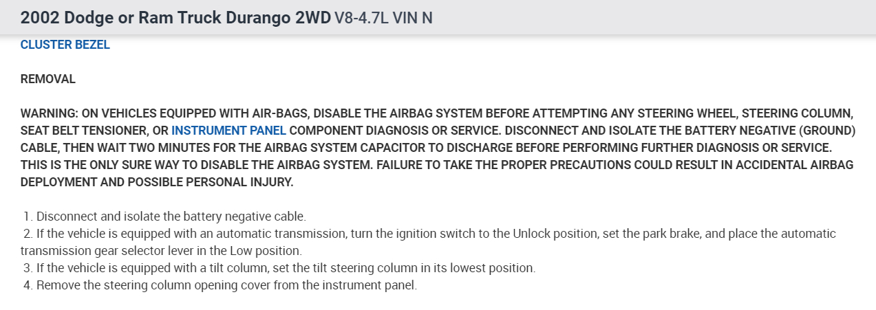

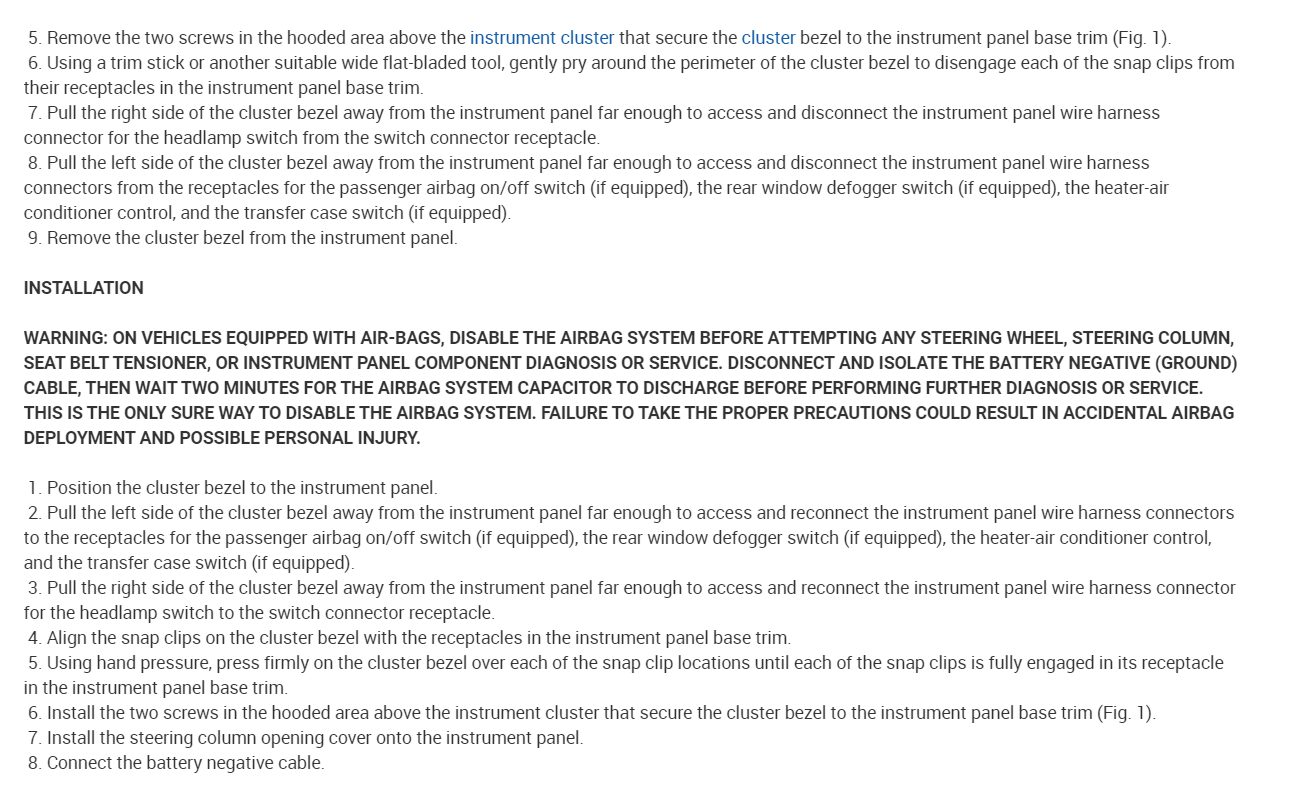

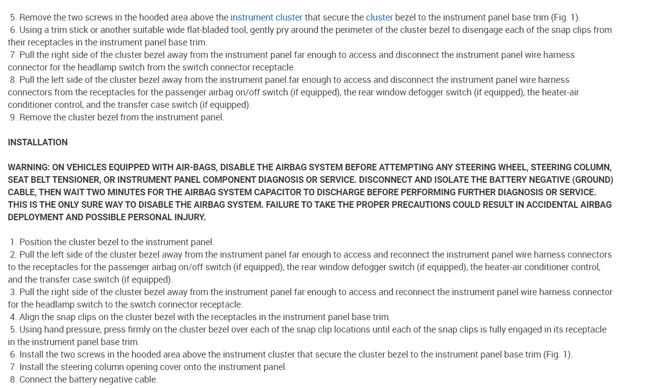

Here is how to change out the cluster, you can get a preprogrammed unit by searching Google or Ebay. Check out the images (below). Please let us know what happens.

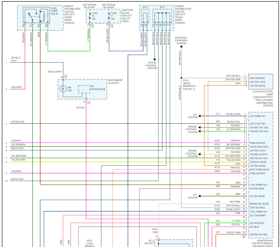

Ken, update, so I had an old super chips programmer for the Durango, wanted to see what it said as the 1000.0 scanner from my friend told me nothing. Any way it has you turn ign sw off then confirm, then turn ign sw on and confirm, that programmer is saying ign sw on not detected, what pins on the ECM do I need to check for this signal, none say ign on. Mark

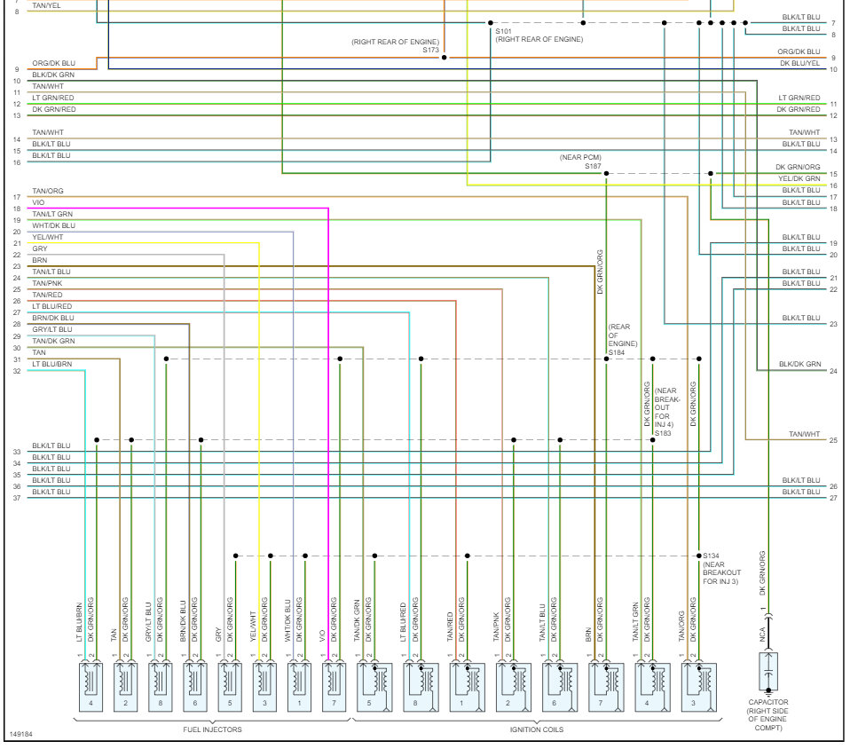

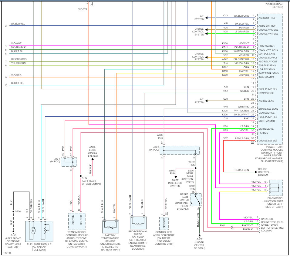

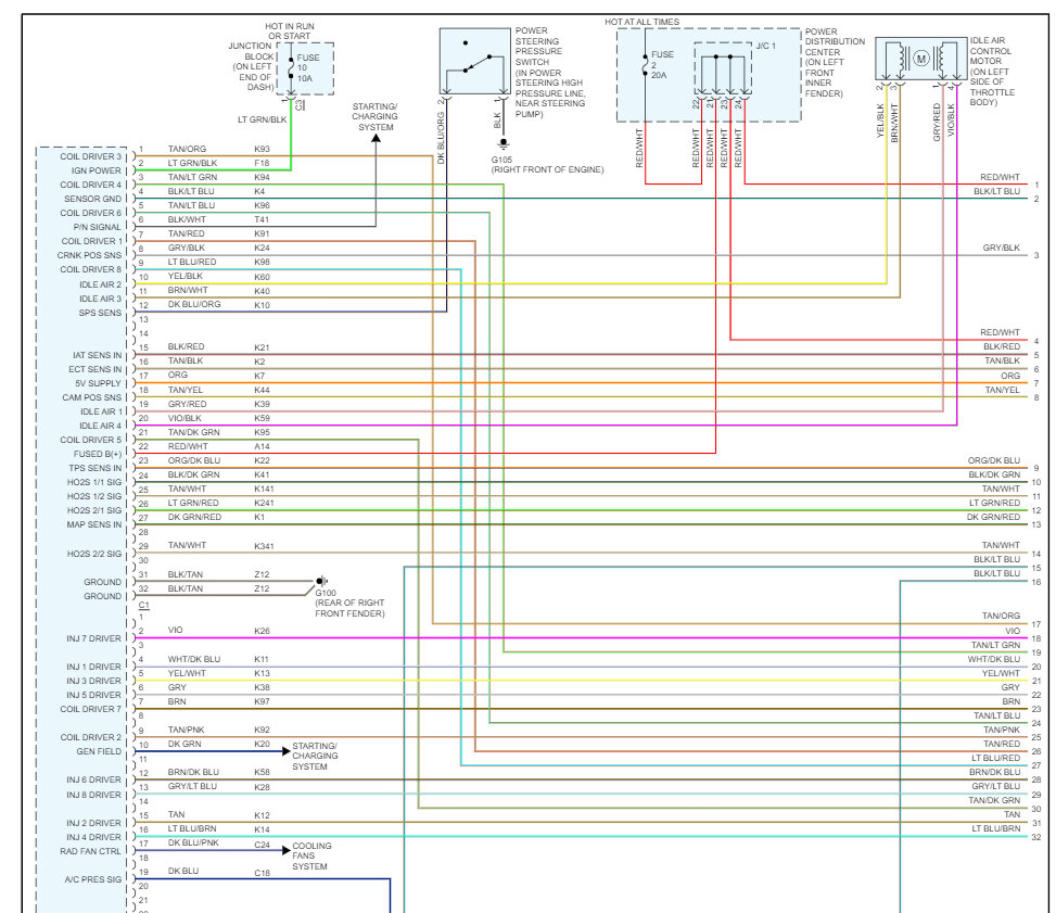

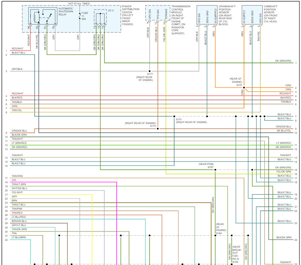

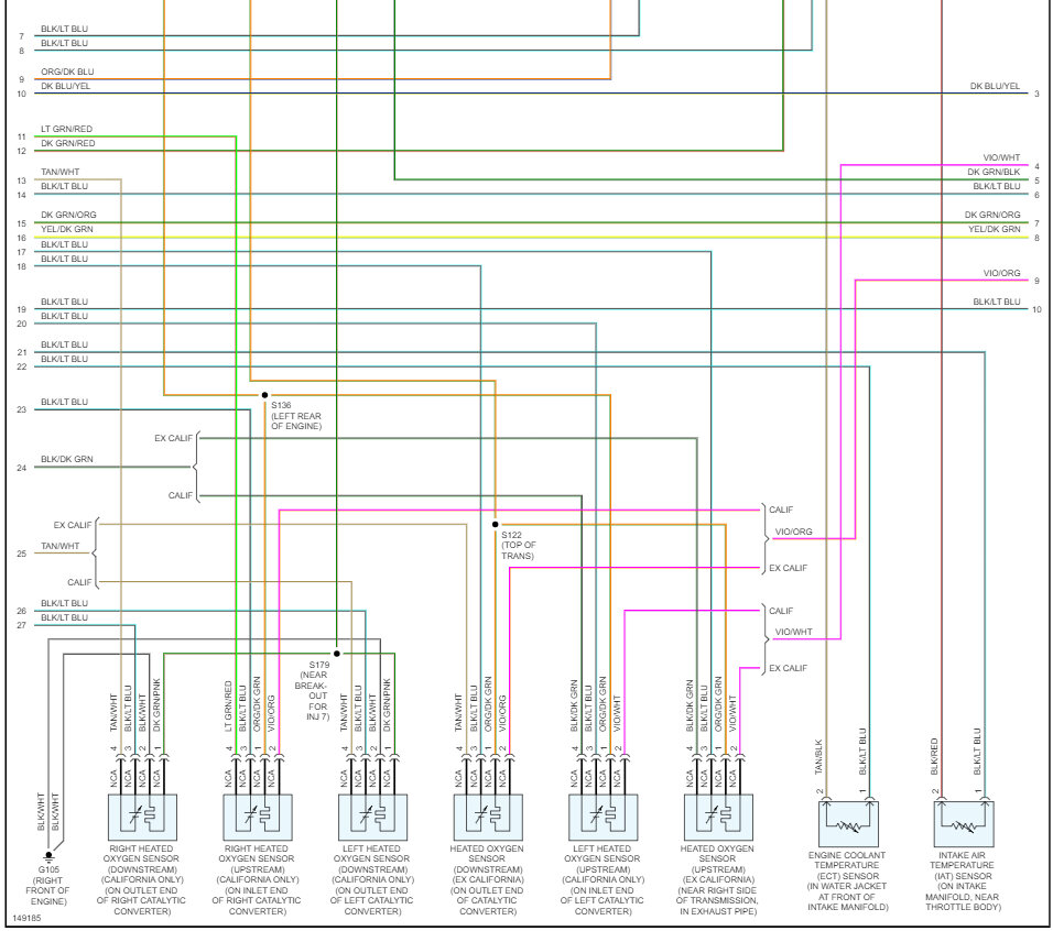

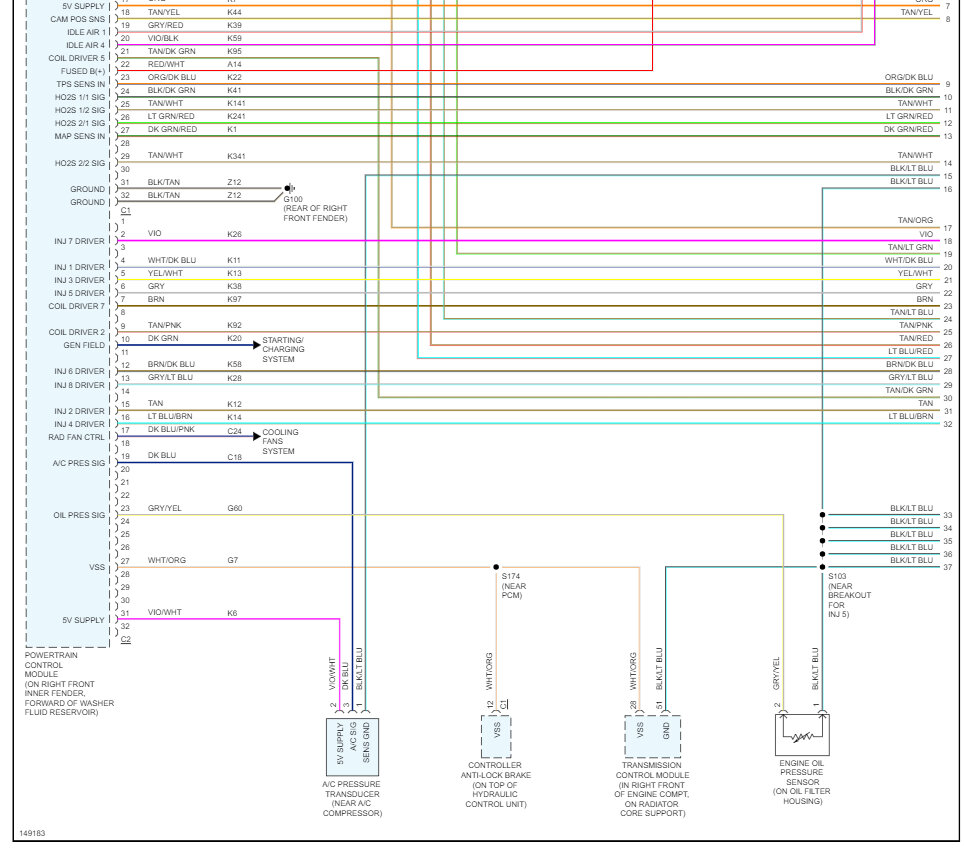

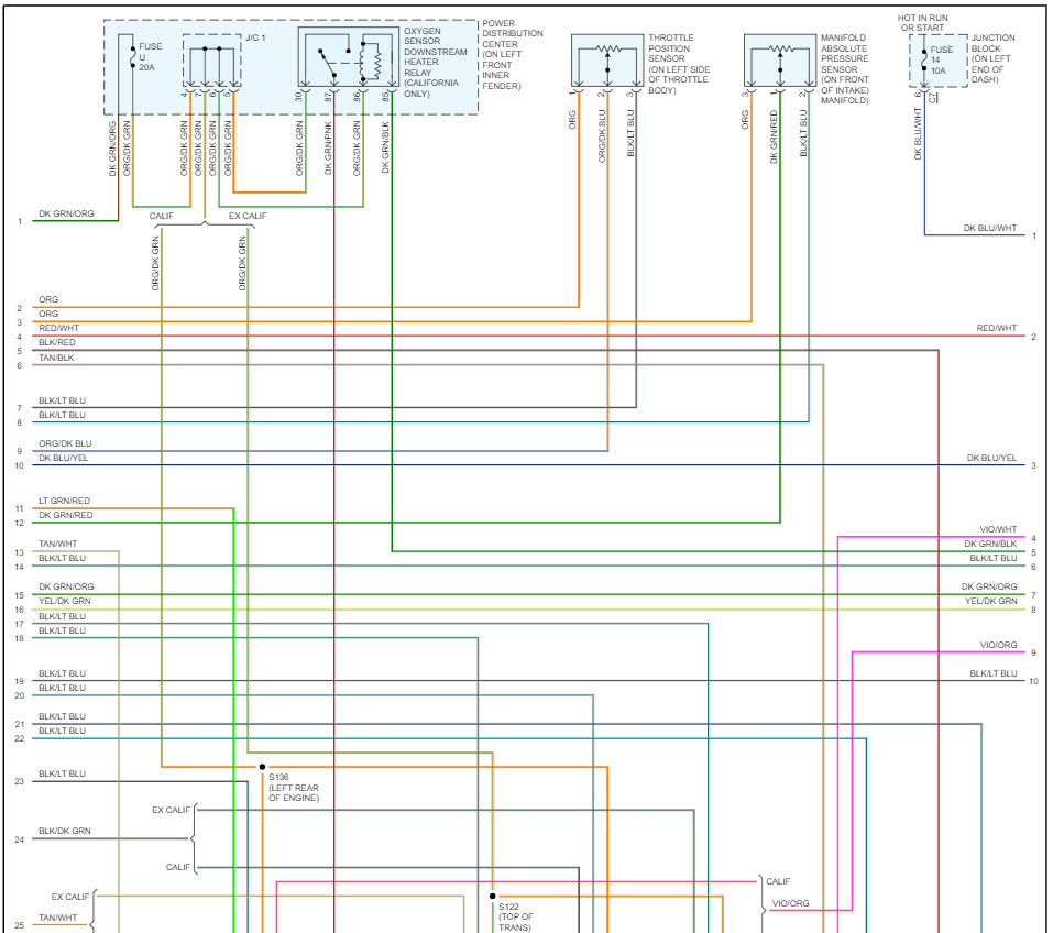

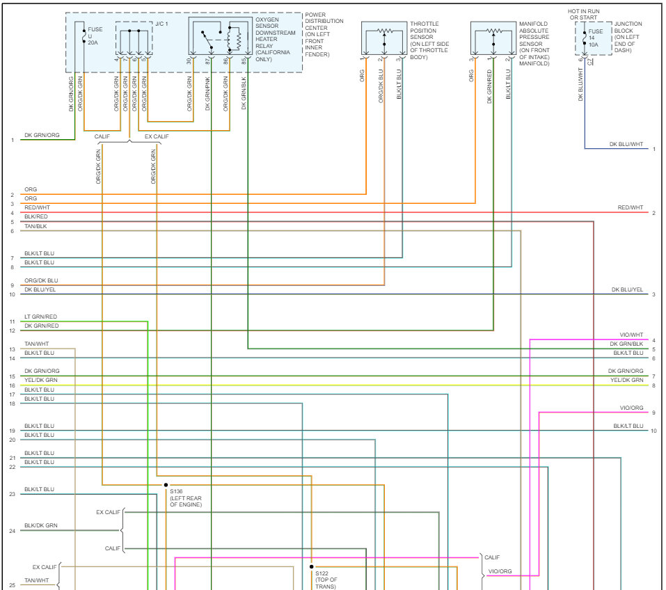

I don't think it will start with the instrument cluster not working or disconnected, here is the engine and PCM wiring diagrams so you can see how the system works and which wires to check.
The guide can help you with the testing:
