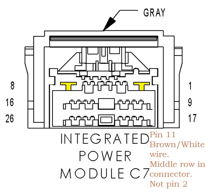

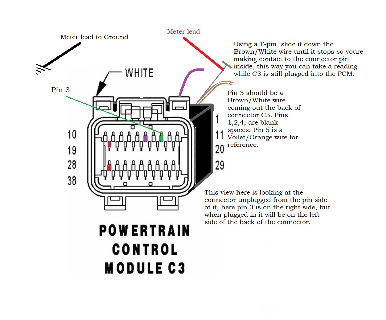

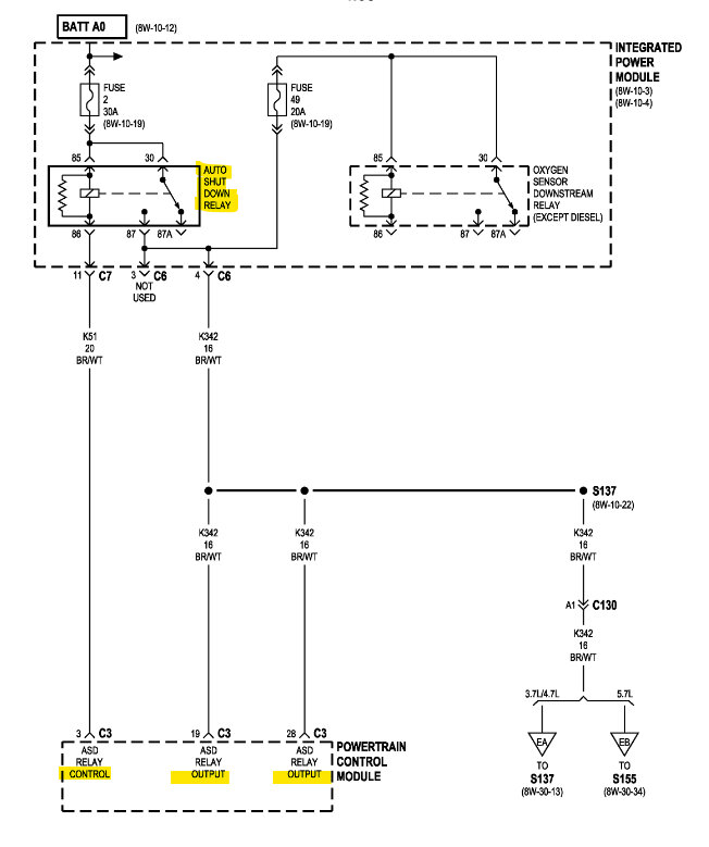

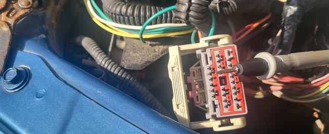

The same way you tested it the first time, C7 pin 11 connector unplugged to PCM connector C3 pin 3 checking the resistance of the circuit. Ohms setting, if it doesn't read set the meter to a higher resistance setting. It sounds like you have pin fitment issues if it was a not start after moving the connectors and harness around. Same wire, same color, we're only dealing with this one wire the entire time here. P0685 is just the ASD circuit code again. If you find very low resistance to the PCM, you might be dealing with internal circuit issues with the TIPM, they're junk, but see what you get first.

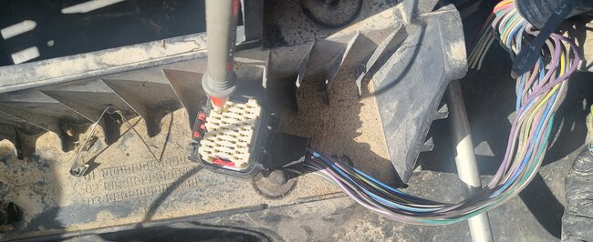

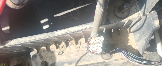

C three pin three / C seven pin eleven. My next step is to cut the wires off the back of the connector a couple of inches down and check for resistance through the actual wired wire instead of lead the lead. Or excuse me, pinned a pin. And then I'm going to hook up a new wire and check that way also. If needed. After I hear back from you.

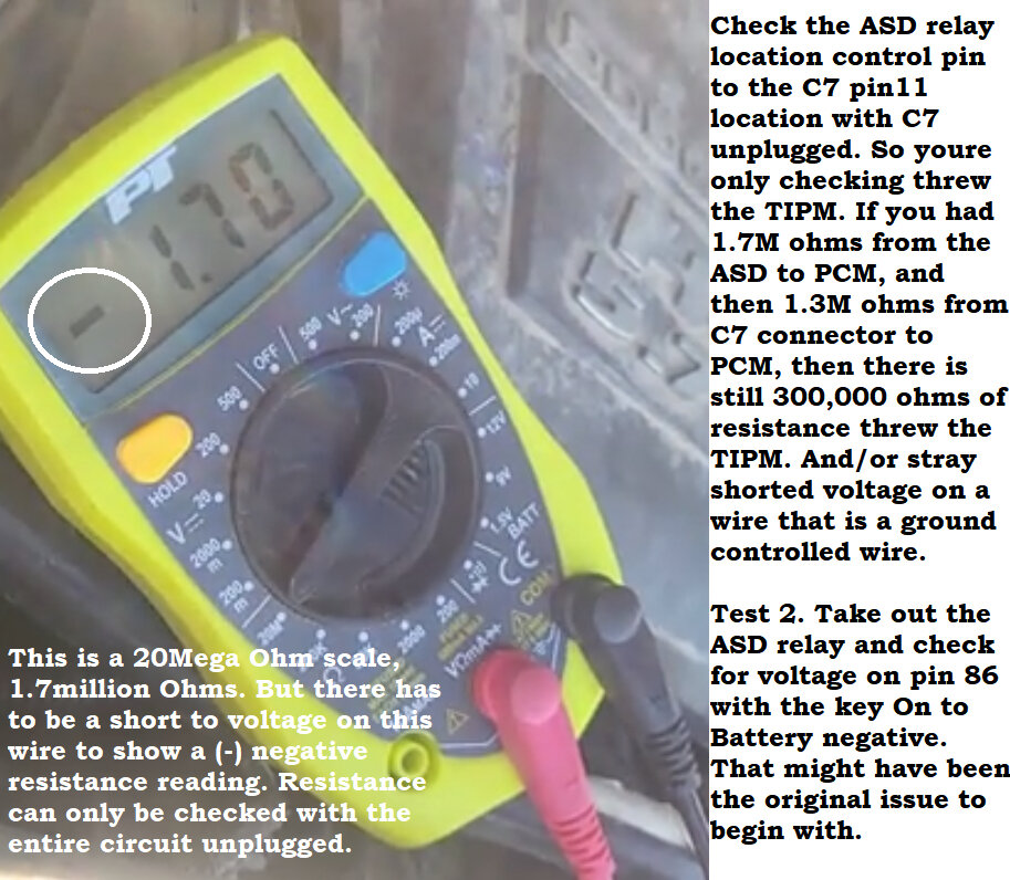

Yeah, check whatever you need to. I was just curious what type of resistance reading you get from the connector's vs the ASD relay location. With a vehicle that's getting to be 20 years old there will continue to be wiring and connector issues. Especially if you live up north where they use a lot of salt from the roads. Since I've moved south, I barely see any of those type of problems anymore. But I did for many years. Every vehicle that came in was a rusted-out mess underneath. So, investing in some basic tools for testing, i.E. Test light, back probing pins, maybe an amp clamp. Will help in the future to make these types of issues easier to diagnose. I will rarely, if ever do resistance testing on a circuit unless it's checking for an open circuit or a short to ground. But YouTube is completely filled with every type of automotive testing you can imagine. So do some searches for automotive circuit testing and diagnostics. There is so much free information out there. I think I learned more in the last 10 years than in my first 10 years. Plus, if you enjoy being able to repair your own vehicle, you save a ton of money and its satisfying work. But anyway, let me know what you get on your circuit checking.

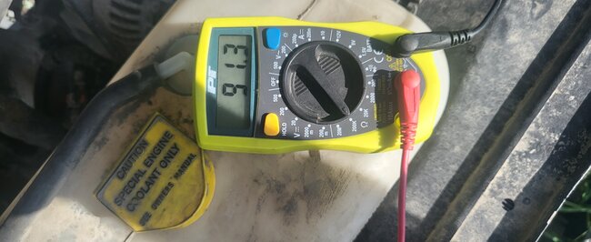

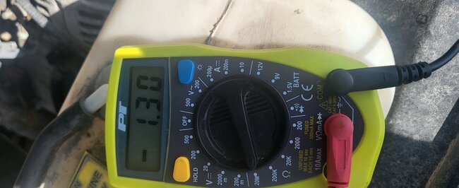

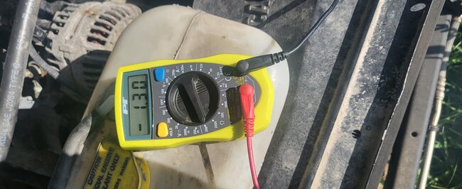

What are these readings from? I see about 91k Ohms on one of them, and I think 1.3M Ohms on the other?
Monday, August 28th, 2023 AT 9:06 AM
LONNIE CARR
  • 52 POSTS

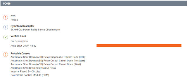

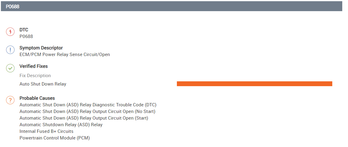

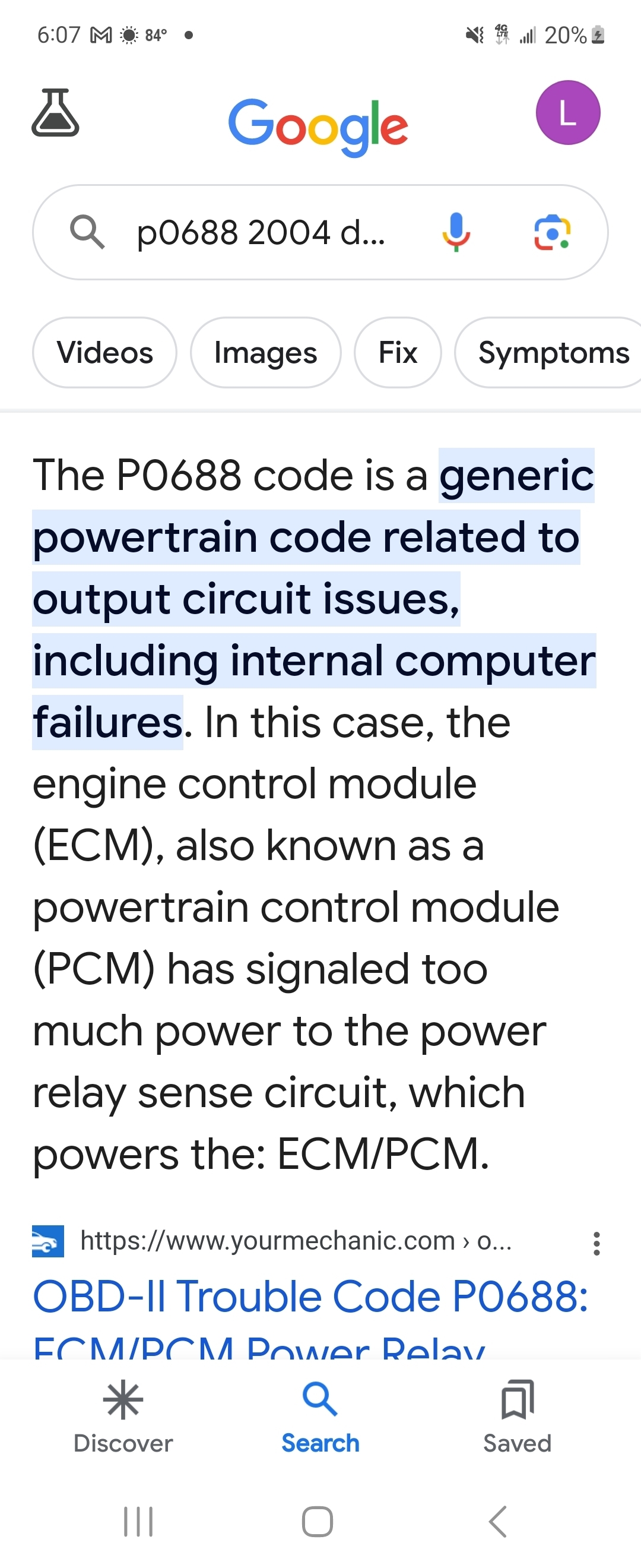

Here's the new code.
P 0688. And the 91k and -1.3m Were the measurements that I read? The resistant homes from C7 pin 11 to see 3 pin, the bottom of the tip Em. To the PCM. Now, I'm getting too much juice, please explain.

Oh, I forgot to tell you that code is from me. Splicing the brown white C7 pin 11 to the C3 pin 3. I cut the wire on the bottom of the TIPM and spliced it and ran it to the PCM And did the same there on C3 pin 3.

The code P0668 is not a "too much power code". You're reading a generic basic OBD2 code definition. It's still the same ASD relay sense Circuit/Open code that been happening. There are 2 circuits that come off the power feed from the relay that feed 12v to 2 different input circuits to the PCM. Did the overlay not work?
If the PCM is not grounding the ASD relay, that code shows up because the ASD relay is not activating. You have to be a 100% sure on your splice connection. It needs to be crimped correctly and very tight as well as heat shrinked so no moisture gets into the wire. I would recheck your resistance reading from C7 to PCM C3 again and make sure the splice is good. If it is then either the PCM has a bad ground, the PCM driver that grounds the ASD relay has failed inside the computer, or there is a pin fitment issue at the TIPM or PCM.

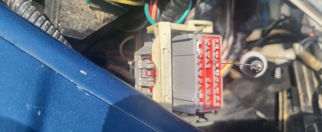

Something else to check is the ASD relay location resistance check to the TIPM C7 pin 11, that will check the resistance through the TIPM for the control wire for the ASD relay. If there is a bad or cracked solder joint inside the TIPM, or corrosion you will have high resistance. Try reconnecting the TIPM connectors as well, you had an issue with that before. You may not notice it, but every time those connectors are unplugged and plugged back in you have moved all those wires, the section of harness and the TIPM around and nothing is ever perfect with connectors. Not every pin is always exactly the tension it should be or the perfect tightness around the pins.

This is where I would back probe the PCM connector pin 3 and with a voltmeter set on DC volts connected to battery negative, key On, does that PCM wire become Grounded.
It has to be checked on DC volts you can't measure resistance with a circuit plugged in. You have to measure voltage drop to battery negative from C3 pin 3.

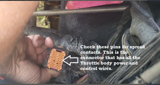

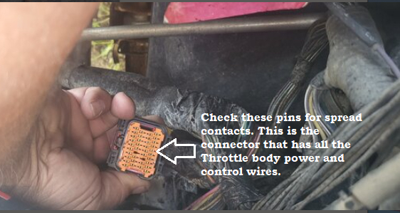

The P2112 is the throttle body actuator that failed its test of moving the throttle plates. Pull the intake air boot off and key on see if you can move the throttle plates with the gas pedal. Don't push the plates open, just see if they open and close with the key On engine off. So, the overlay of the wire didn't work.
At this point you just need to see if the PCM is able to ground that wire. P2106 is a Reduced Power mode due to the P2112.
Try to pierce the wire right at the PCM and see if its being pulled to ground,
And I'm not sure on your resistance readings, why you have 2 different numbers, there should only be one Ohms reading from C7(pin11) to PCM C3(pin3). I don't know where you're reading 91k Ohms and 1.3M Ohms.
Something else I noticed looking back over all your posts and the video you sent, when you were checking from the ASD relay location to the disconnected PCM C3 pin 3 wire and checking the resistance on the 20M Ohm scale, if you look back at it the meter is reading -1.7M Ohms. Now the only way that an ohms reading would show up negative like that is if there is voltage still on that wire. With both ends unplugged you should have had a regular reading around 5 Ohms. Not millions of Ohms and not a negative reading like that. And now that you're getting throttle body actuator codes, you had the PCM connector that controls the throttle body unplugged. C2 is the first connector you unplugged, I remember because it was the one right next to C3. I think the pins inside that connector are not tight. C2 and C3 are the two middle connectors at the PCM. C2 was the one with the Orange inside, C3 had white inside. Those PCM pins are very tiny, they can easily be spread too much just by trying to unplug the connector.

The only real proper way to test the driver right at the PCM is with an LED test light that pulls very low current. And hook the led test light to battery positive and see if the C3 pin 3 at the PCM can ground and light the test light up. I suspect you have high resistance in the TIPM and possibly the wire going to the PCM because of the resistance readings you had at first. One was 1.6M ohms from the ASD relay location and then the other was 1.3M ohms from the TIPM connector, so that's 300k ohms going through the TIPM to its output connector, I think it was C7 pin 11. What's making you suspect a charging system issue now?

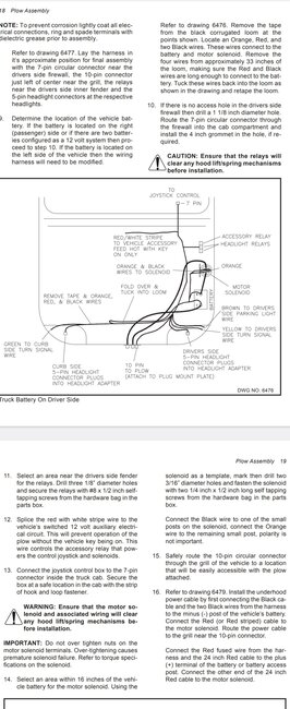

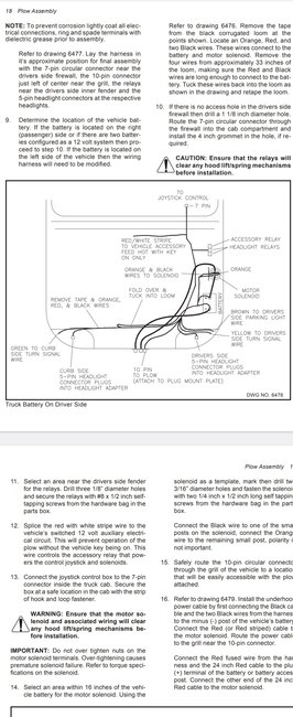

What was involved with installing the plow? And how did you wire it up? Was there a wiring diagram that you followed I could take a look at?
Wednesday, September 13th, 2023 AT 5:53 PM
LONNIE CARR
  • 52 POSTS
I used a diagram from Hiniker that I got online. I used plug and plays to hook up the lights to the truck side harness and plow control. The red/white wire pushed in with a fuse that gone to ignition switch, and I bolted a solenoid under the hood and hooked it to the battery and ground it to the body.
Wednesday, September 13th, 2023 AT 6:14 PM
LONNIE CARR
  • 52 POSTS
Hiniker plow 2752.
Wednesday, September 13th, 2023 AT 6:29 PM
AL514
  • 5,584 POSTS
Did the starting issue start shortly after the installation? These diagrams are really difficult to see, but what fuse does the red/white wire go to? It's an Accessory feed I see, but is it one of the fuses in the TIPM? These headlamp plow circuits, are they in addition to the vehicles headlamps as well or do they take the place of the original headlamps? I wonder if too much current flow through the TIPM did anything, because it's not just a fuse panel, the Front Control module is built into the TIPM and it's on the vehicle network. But I would still try running a wire over to the PCM and see if that activates the ASD relay.
