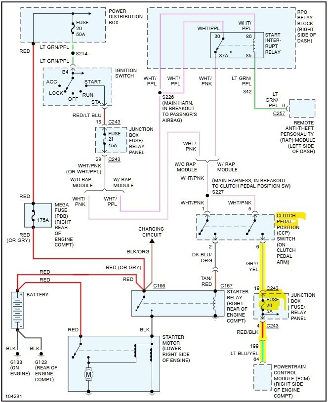

I was driving and it just shut off, will crank but won't fire.
I have replaced the coil pack, crankshaft sensor, camshaft sensor, computer/ PCM,
Checked wiring harness for burnt/damaged wires, checked fuses and relays multiple times. No check engine light, battery went dead took off to charge, I need help
This is driving me nuts.

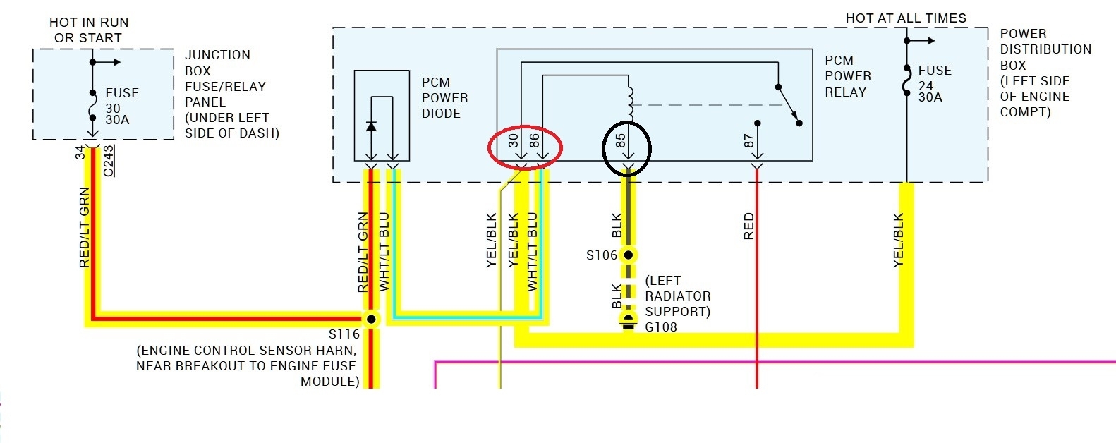

And do you have power to all the fuses in the engine compartment fuse box? Id would check them with a test light and a multimeter to make sure there is full battery power to each fuse since they all have a direct connection to the battery in that fuse box. I'm getting the wiring diagrams for the PCM together for you, powers and grounds. The grounds for the PCM do go to the engine block, so does Battery Negative, the PCM has at least 4 or 5 grounds I see so far, they look like they're all black wires with a White stripe. G123 is Ground at the Rear of Engine Compartment, which is also where the Battery Negative wire goes.
Here are some guides to help. I will post the diagrams next.
Jul 22, 2025 at 12:34 PM
AL514
  • 5,541 POSTS

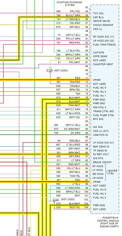

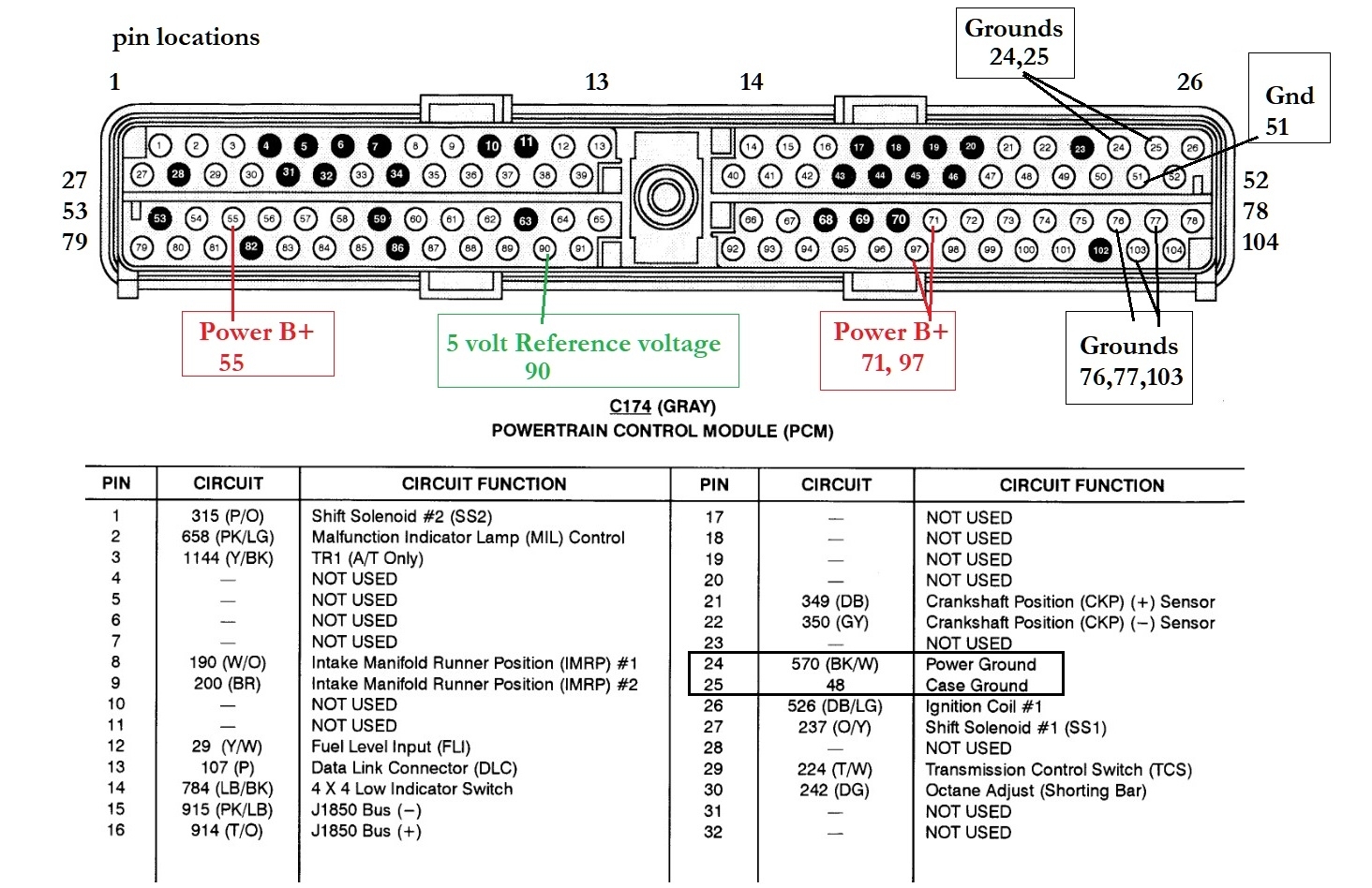

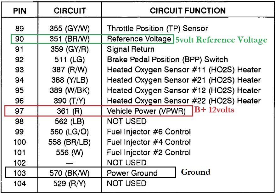

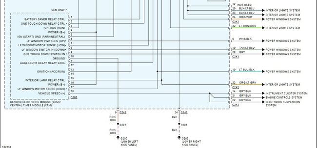

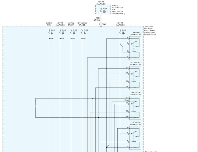

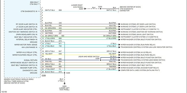

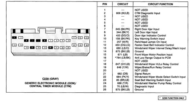

Sorry for the delay, some of the aftermarket diagrams were incorrect, so these are the OEM Ford diagrams. Diagram 1, 2 are the PCM ground locations.

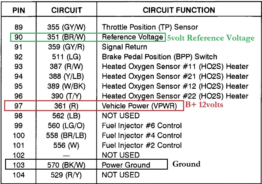

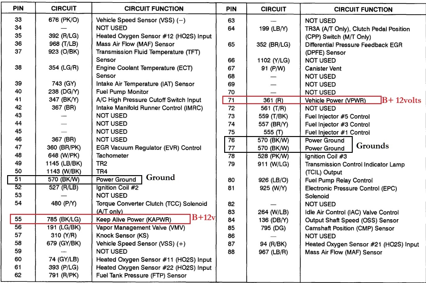

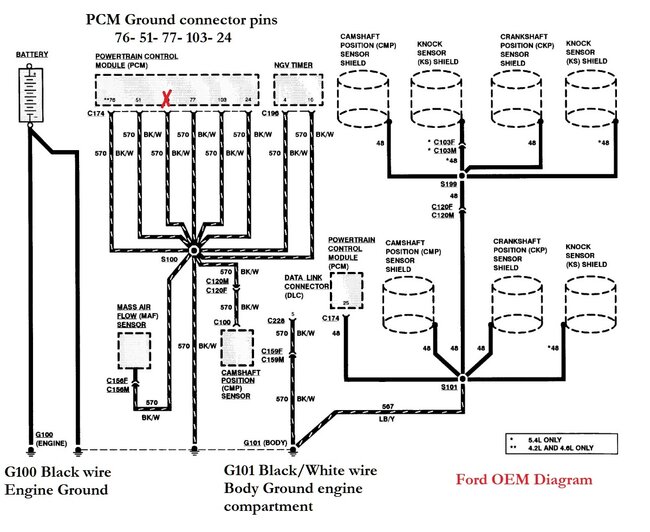

Diagrams 3,4,5 are for the PCM Connector so you can check for power and ground right at the connector, hope fully it's not too confusing, you just need to concentrate on the 6 Grounds and the 3 Power feeds to the PCM. D

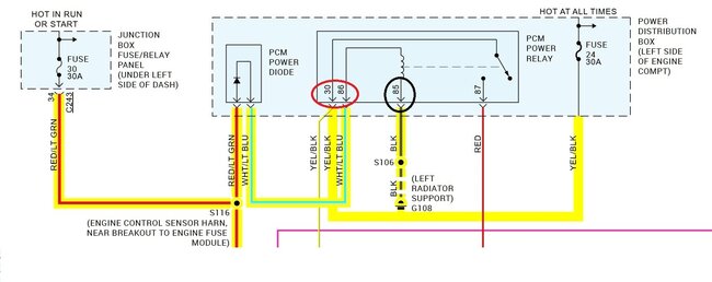

Diagram 6 is for the PCM power relay, if you take the relay out of its location, out of the 4 pins where the relay sits, 2 pins should have power at all times, and 1 pin should go directly to ground. So, if you use a multimeter to check for power here, just touch the pins lightly without pushing the meter leads into the pins, that will spread the pins and the relay will not make good contact afterwards.

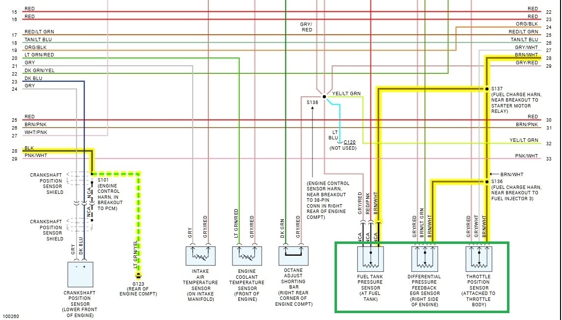

Something else you should check is the 3 sensors in diagram 7, marked in Green on that sheet as well as the PCM connector sheet. Those 3 sensors use a 5volt Reference, and if one of those sensors shorts out and pulls the 5volts down to ground, it will disable to the PCM and can act the same as if the PCM was not powered up, So if you find power and ground where it should be at the PCM connector, unplug one of these three wire sensors and check for a 5volt feed on one of the wires, the throttle position sensor is the easiest to check, you're just looking for missing voltage here with the key On. If it's missing, unplug the next one. If the 5-volts is not missing when one specific 3 wire sensor is unplugged, check for a Check engine light, you may have to cycle the key.
The trick here is if one sensor is pulling the 5volts to ground, and you unplug it, the issue is no longer there, so not effecting the other two sensors at that point, but plugged back in and the issue is back, this is where you would have to back probe the connector with a pin and see if that specific sensor is bringing down that reference voltage.
It may sound confusing, but the idea is checking the sensor while plugged back in to see if the 5-volts is there or not.
A shorted sensor causing the computer to go down is common but can be difficult to find. Thankfully there are only 3 sensors on this truck that use that 5volt Ref.
The last diagram is the aftermarket PCM connector just in case. Sorry for the long post.

You want to check for voltage at the PCM connector on the 3 wires that I marked on Red, and the 6 Grounds marked in black. The Coil pack is controlled by the PCM, it has 4 wires to it, one wire is power, the other 3 wires are control for each coil. The coils are ground side switched, and one coil sends spark to 2 cylinders, it's known as a waste spark system. But with the key On, you should see the Check engine light come on for at least a few seconds. You can also look at your Tachometer, if you have lost a crank sensor signal, the tach won't move at all when cranking. But you should see a check engine light, that's why I mentioned checking the powers and grounds for the PCM. But remember if one of those 3 wire sensors shorts out, it will have the same effect. It can cause the PCM to go down.

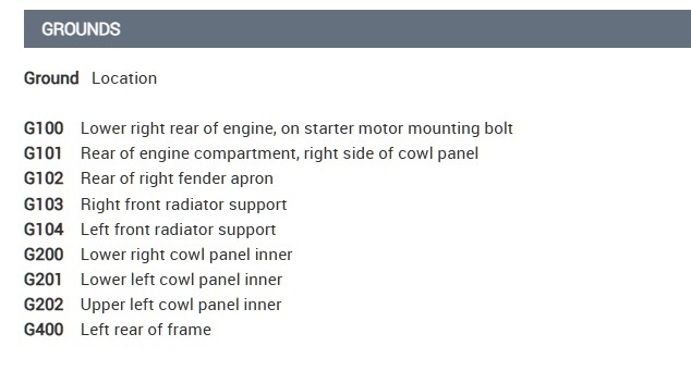

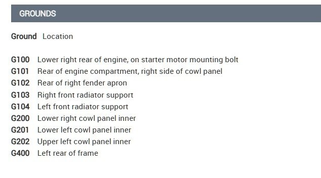

Sorry the delay, working nights due to the heat down here. Be sure to check under the truck as well for any braided frame to body grounds, they can have high voltage drop across them, even if they look okay, run a large temporary ground and see if it starts.

okay, unplug the throttle position sensor and with the key On, see if you have 5-volts on one of its wires as well.

I checked the grounds at the PCM connector, using a DMM set to resistance. 000 at every one.
The positive pins is getting 12.6 volts at them.

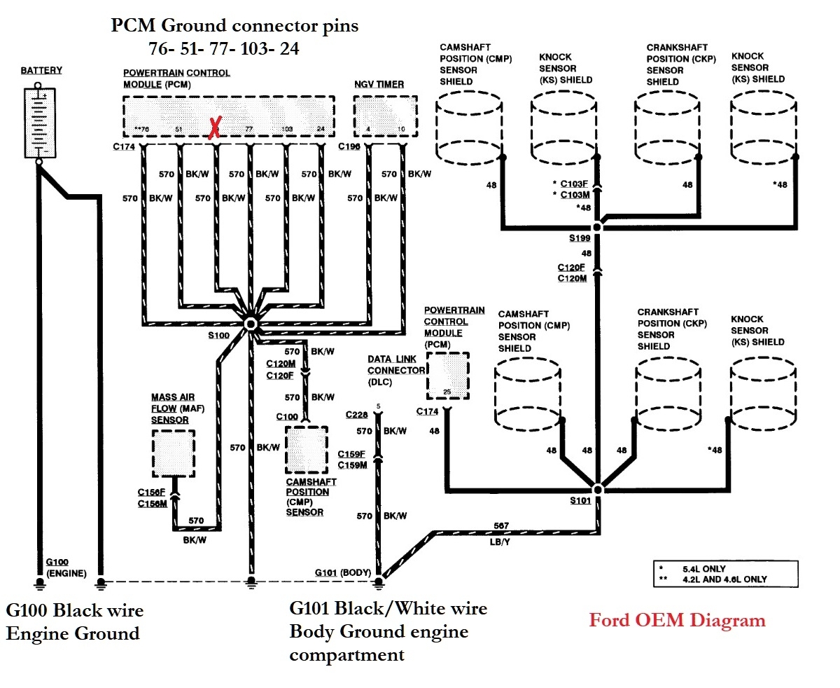

Okay, I will usually load test the powers and grounds to make sure they can carry current, I'll use a turn signal bulb most of the time, they pull a few amps, but for now see if you have a 5volt reference on the throttle position sensor. Out of the 3 wires one will read 5volts with the key On. If the 5volts is missing, plug the TPS back in and recheck at the Differential Pressure Feedback (DPFE) Sensor on the EGR valve for a 5volt reference. Let's see if this is a sensor issue.
Another quick test to rule out any bad engine or body grounds is to run your own grounds for testing purposes, you can use some jumper cables, just connect to battery negative, to the engine block, and to the body/frame. That way you're grounding the entire vehicle, it's good to use jumper cables for this since they can carry high current loads. If you ground everything out, and it starts or at least the Check engine light comes back, you know your dealing with a bad ground.
you can even hook a test light to Battery negative and touch the block, a bad ground will light the test light, but try the jumper cable method since its quick.

Ok I used jumper cables to ground the engine to the battery negative,, then checked the throttle position sensor for the 5 volt reference only getting 1.2 volts on the brown / white stripe wire , , what next

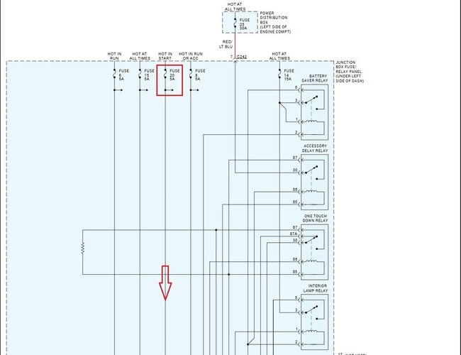

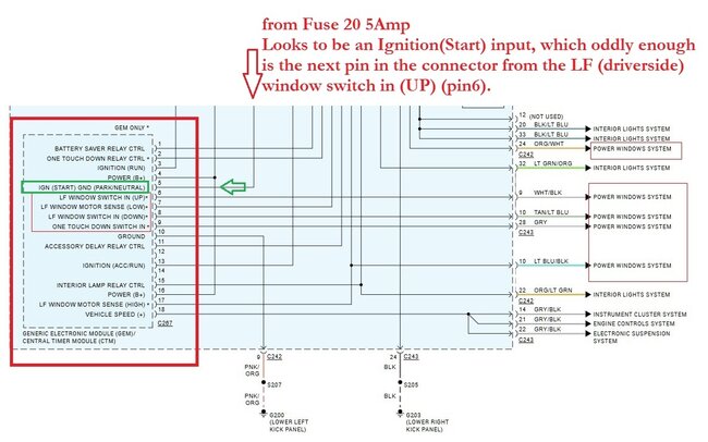

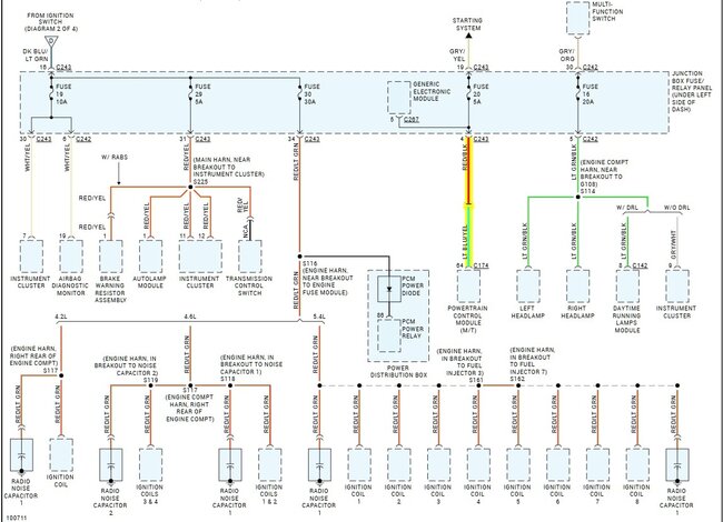

Ok Fuse 20 5amp, did you try using jumper cables for temporary grounds? You dont need to hook them to battery positive, just use them as large jumper wires to ground the engine block and frame to battery negative.
It looks like Fuse 20- 5amp is "Hot in Start". It looks to send a start signal to the PCM through the Clutch Pedal Switch. You're still in a "Crank no start" condition correct? Have you done a test yet to see if youre missing ignition spark or fuel injector control?
Running the jumper cables to battery negative to the engine block is just a short cut test to potential Grounding issues, The reason Im stressing that test is because the PCM grounds to the engine block, and so does the battery, and ground straps are over looked in many cases. Just looking at them doesnt tell us how much resistance a braided frame to body strap.
You can (diagram 1) see that Fuse 20 wont have power until the clutch pedal is down and the key in the Start/Crank position. Make sure you dont have any broken or corroded wires down at the pedals as well.

The wiring diagrams do show an anti-theft module, are you seeing a constant or flashing security light? I would think you would still see the check engine light as well, But if you have a security light On, it will usually shut off a few seconds after the key goes to the On/Run position. Is that something youre noticing?

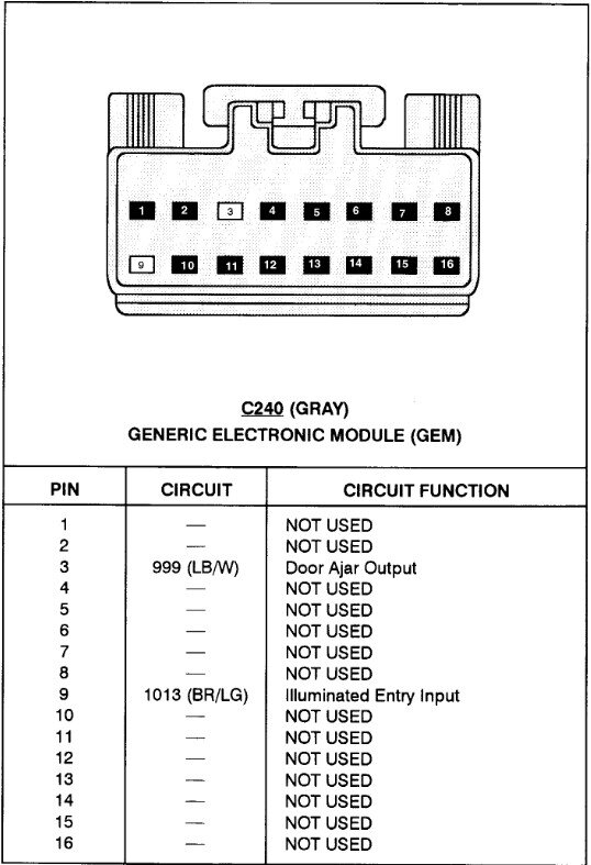

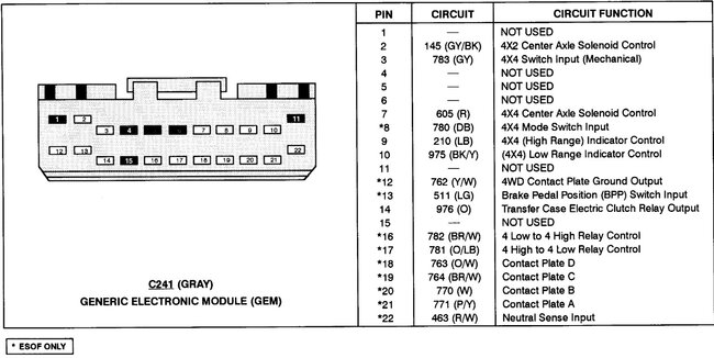

The GEM module is basically a body control module, just called something else. Below are the listings on page one (diagram 1,2) and page two. Showing everything that has an input or output from the GEM.
I would check any connectors under the dash or connectors to the engine compartment fuse box. They're pretty easy to check.

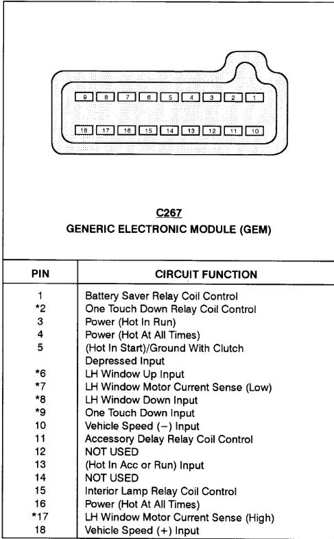

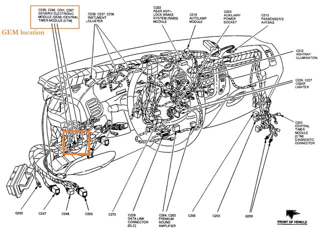

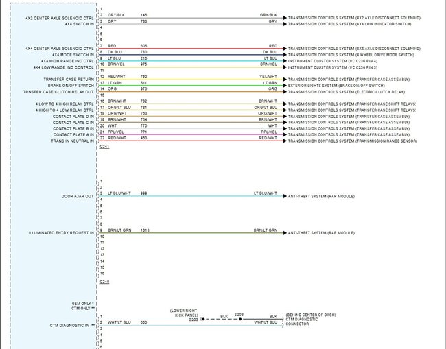

To your 1st question on the window, yes the GEM controls body functions. This is the 2nd diagram from above, you can see there are a 2 control modules here. Calling a failed module is difficult, but here I would go and check this connector for any corrosion, I can see why its not starting with that fuse blown.
Aug 5, 2025 at 4:44 PM
AL514
  • 5,541 POSTS
This is the GEM (body control module) is located, with its 4 connectors. They are all labelled and you shouldnt have too much trouble locating it, look for broken or rubbed threw wires down where your feet are. Many times wires will just rub threw after 20 years and they short out. The GEM doesnt look to be in a good location when it comes to water.
