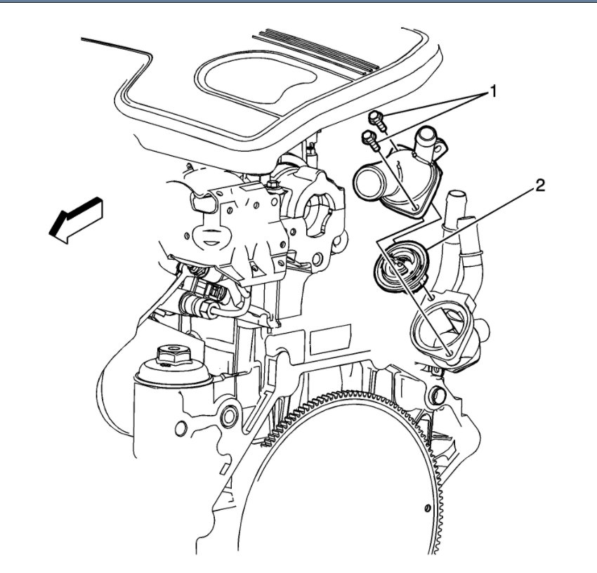

Coolant temperature goes up and down at slower speeds and the coolant fan is always running when I shut the engine down.
Sunday, February 25th, 2018 AT 5:39 AM
MECHANIC
52,796 POSTS
Here is a guide to help you see what's going on with additional related guides:
https://www.2carpros.com/articles/engine-overheating-or-running-hot
1. Low coolant level. You need to pressure test the system to verify no leaks.
https://www.2carpros.com/articles/radiator-pressure-test

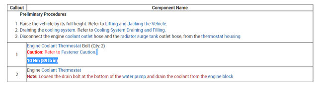

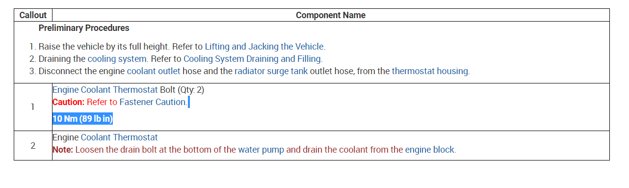

2. Thermostat. Common problem s it sticks.
3. Clogged radiator. I would flush the system.
https://www.2carpros.com/articles/coolant-flush-and-refill-all-cars
