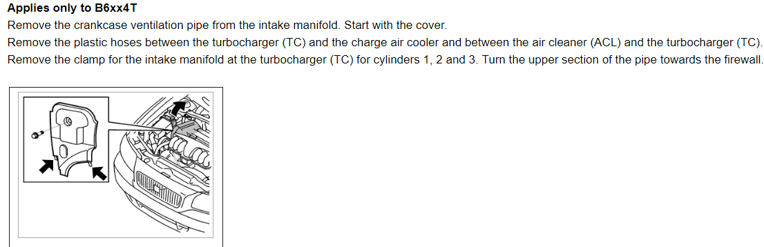

At 193 it should not be boiling over and that is when the cooling fans come on which is normal. You could have a blown head gasket even though there is no coolant in the oil. Here is a guide to help us check:
Also, I would replace the radiator cap or have it tested to make sure the cooling system is holding pressure.

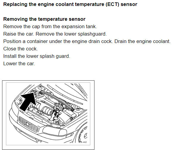

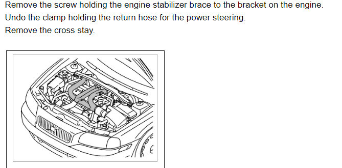

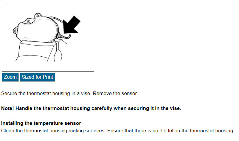

Here is a guide to show others that visit the post what you are in for when changing the sensor out:
https://www.2carpros.com/articles/coolant-temperature-sensor-cts-replacement

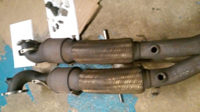

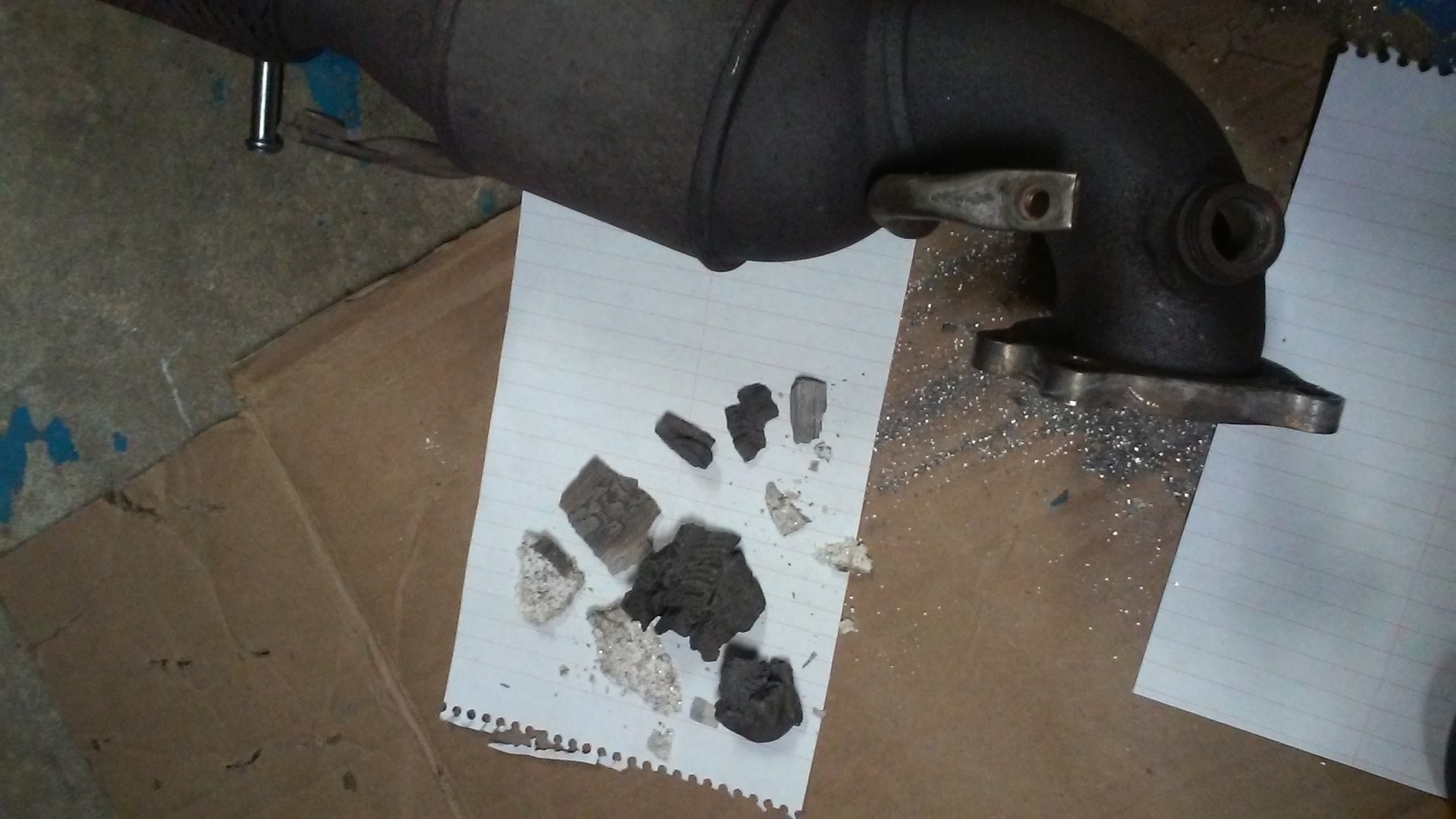

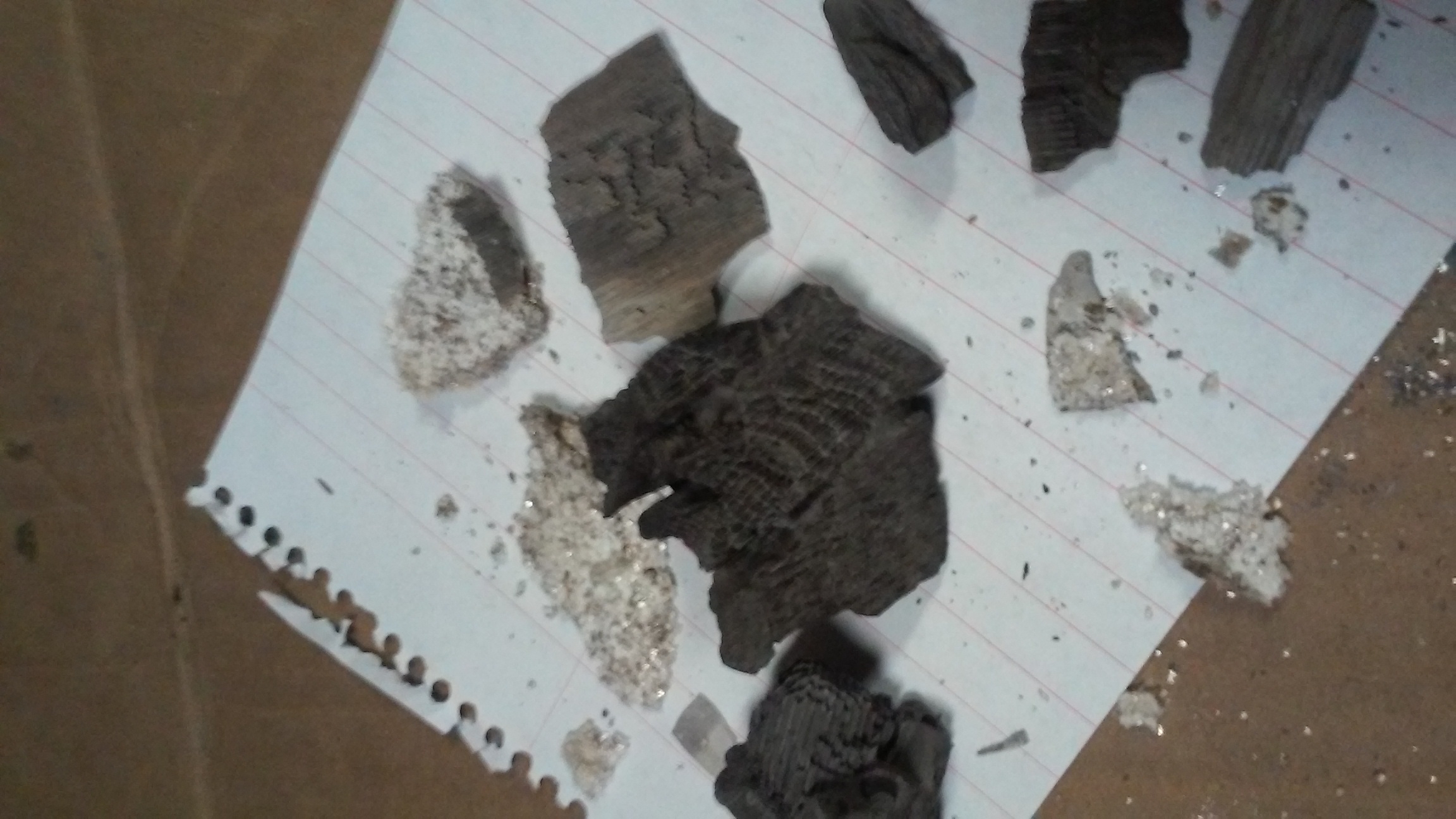

My daughter and I heard a noise nobody wants to hear when I started the car. The dreaded sound of an empty aluminum can with several pull tabs rattling under your car. No its was not a midget under the car rattling a can, It is the beloved sound of your honeycomb baffle in your catalytic converter disintegrating, separation, collapsed, bye, bye.

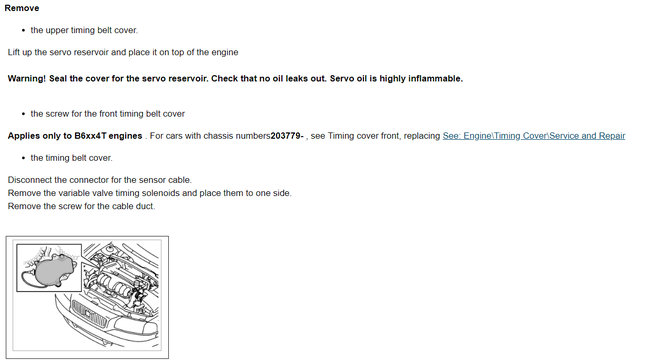

It still sounds like you have a blown head gasket. The chemical test can give false readings. Can you remove the spark plugs and pressure test the cooling system? Leave it for fifteen minutes under pressure then with the plugs out turn the engine over to see if coolant shoots out.
Here are guides to help:
https://www.2carpros.com/articles/radiator-pressure-test
and
https://www.2carpros.com/articles/how-to-change-spark-plugs

Ken, I'm a bit late on the reply, but it was the cooling fan that was the issue. It was from a S60 and not a S80-2.9T. Problem resolved with a new OEM Fan and Bosal OEM Compatible Cat Converter Assembly.

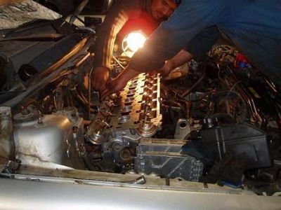

  • 152,000 MILES
The car is hot, it get my butt to change the gasket, but not how to align the VCT system, or weapon normally and automatically adjusts the computer?
Best regards.

JIS001
  • 3,412 POSTS
Do you have the tool to lock both cams ito place? Let me know.
