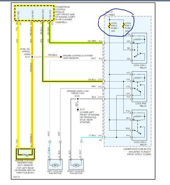

I don’t have a air system in my garage so I purchased one of those kits with the blue fluid and ran that test on my radiator and the fluid remained blue indicating no gasket leak. I replaced also the water pump, and then entire gauge assembly in the dash which included the temp gauge! I don’t understand a few weeks ago when I installed the new computer everything worked properly! We put the computer in and drove around and came back to garage open hood and the fans kicked on properly! Then the next day I drove to town came back to garage then the fans would not come on! I have a bad feeling something caused the computer not to work the next day after computer work everything properly the day before. Guess I might be purchasing an expensive scanning computer next and see if it will tell me if computers got shorted out? Any ideas I have replaced everything!

The chemical test is not an accurate test. That is why I suggested the air test.
I would have someone do it for you to be sure.
The ECM only grounds the relay for the fan to operate. It does this based on input from the coolant sensor on the engine. I highly doubt the ECM is the issue. I believe it is a mechanical issue.
I attached the wiring diagram for you to view. Check the fuses I circled for power.
if you remove the connector for the coolant sensor with the key on, the fans should come on.

Roy, the car purrs like a kitten! Some of my mechanics friends said the car would run rough if it was head gasket. Also, if you have a blown head gasket the fans would still come on but the car would overheat regardless! The diagrams you sent me are useless since I have 3 wires on my ECT sensor, a solid green that tests 12 vts when on and the yellow that’s 4.99 vts and a orange/black stripe that I assume is a ground but I’m not sure. Can you find a wiring diagram of the 3 wire ECT sensor and send it?
Sunday, May 17th, 2020 AT 4:00 PM
  • 52,797 POSTS
The green wire is for the temperature gauge.
The other 2 are for the temperature sensor itself which is a signal for the ECM of the engine temperature. They both go to the ESM. Neither are grounded externally. They ground or return is controlled in the ECM.

Did you try removing the connector for the coolant sensor with the key to the on position and see if the fans kick on?
That will tell you if the entire circuit of the fans is working correctly.
If there is air in the intake where the coolant sensor is located, the fans will not come on due to the lack of fluid in contact with the sensor end.

Okay, I unplugged the CTS and turn key on and they did not come on. But I started the car and they came on in a few seconds after I started it! So what’s the verdict?
Monday, May 18th, 2020 AT 2:27 PM
  • 52,797 POSTS
The test is done with the key on or started. Then remove the connector.
That sounds like the fans are working. If they were then the circuit is working as it should.
It is the air in the intake at the sensor that is not allowing the fans to come on.
