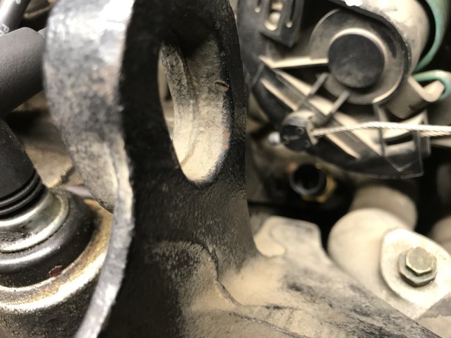

I seem to have power on all fuses. My coolant sensor has 3 wires green, yellow and orange black. How do I test it and why didn’t my fans come when I unplugged the coolant sensor? Does the car need to be running when I unplug it. Or do I unplug it then start the car? Why does my sensor have three wires? Also what is engine control system and MAP sensor?
Apr 13, 2020 at 10:56 AM
  • CAR REPAIR CONTRIBUTOR
The coolant sensor should only have 2 wires. A 5 volt reference and a return to the ECM.
The map sensor is a 2 wire sensor and has no effect on the issue.
The coolant sensor is by the thermostat.
Apr 13, 2020 at 11:07 AM

Okay, I tested the wires on the coolant sensor. As I said the green was a ground and I got a good 12.5 volt reading there. I tested for system voltage to computer and got 4.95 volts. I left it unplugged and started the car and they did come on with sensor unplugged! I left car running and tested the return voltage voltage from computer and got .14 volts. So can you tell me what problem is now?
Apr 13, 2020 at 12:42 PM
6STEELRINGS
  • 29 POSTS
Here it is. I can send a picture of the connector if you want.
Apr 13, 2020 at 1:20 PM

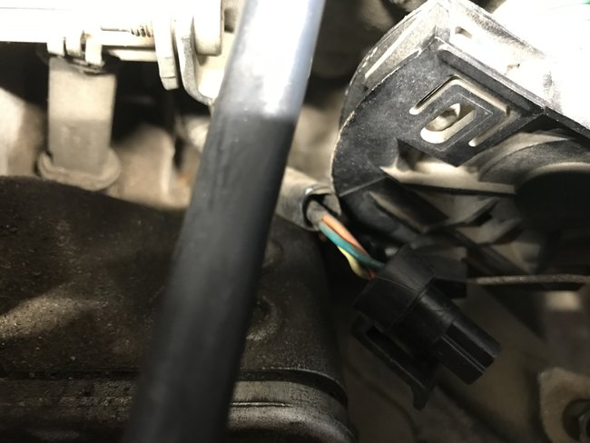

Here are the connector wires:
Apr 13, 2020 at 1:25 PM
Okay, that is the sensor that does both the temperature gauge and the signal for temperature.
I would change the thermostat as it may be opening late causing the temperature to go up. The position of the sensor makes a difference.
Apr 13, 2020 at 1:41 PM
The green wire is for the temperature gauge.
The other 2 are for the temperature sensor itself which is a signal for the ECM of the engine temperature. They both go to the ESM. Neither are grounded externally. They ground or return is controlled in the ECM.
