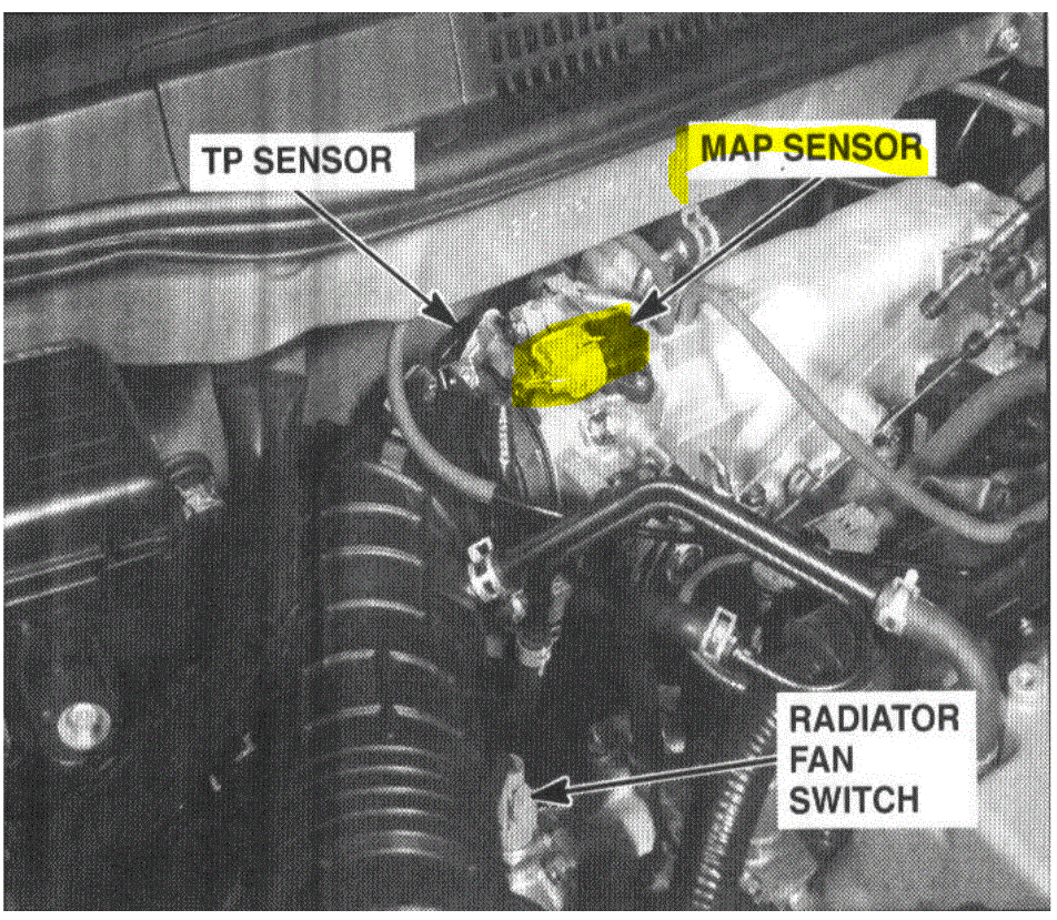

Compression is fine.
I cleaned the throttle body it was pretty bad. Put it back on and it darn near started but didn't.
I replaced the battery over the weekend, so no codes unfortunately.
Can't locate the mass airflow sensor.
Kind of at a loss at this point.
Wednesday, May 25th, 2022 AT 9:29 PM
  • 110,194 POSTS
This vehicle doesn't have a MAF sensor. In its place is a MAP sensor, (manifold absolute pressure sensor). I attached a pic below showing its location.
Let me know if that helps.
See pic below.
