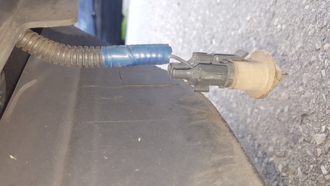

There is a hanging cable connector underneath the front end of the car right below the fog lights. Could this be the cable for the left turn signal that is flashing non-stop when I ignited?

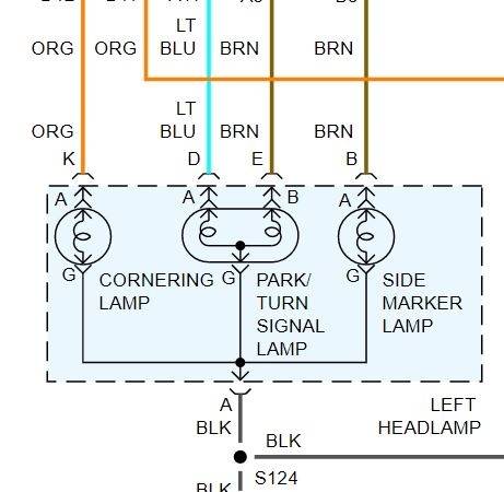

When a signal bulb is bad or something is causing power not to complete the circuit, the signal will flash double time. That is so the driver knows a bulb is not working. Based on your description, I would say there is a good chance it is related to the signal. Is it possible for you to let me know the wires' colors that are hanging or even upload a picture of what you see?

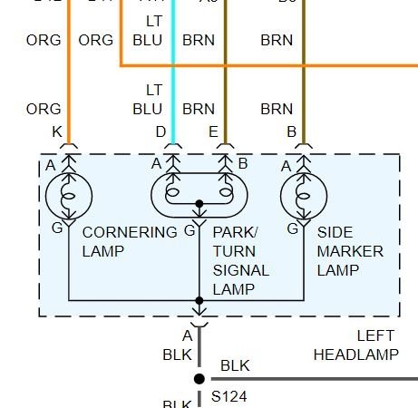

I attached a picture from the wiring schematic. It shows the wire colors to the left front turn signal. Take a look at it and see if what is hanging has the same colors.

this is the other side. The cable should be attached as you see it.
Aug 30, 2019 at 3:54 AM
  • 110,193 POSTS
Welcome back:

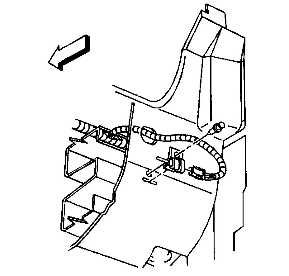

It appears to be the signal wiring harness. I can see in the first pic that the bulb is broken, so that is why it is flashing so fast. It must have come loose from the light assembly.

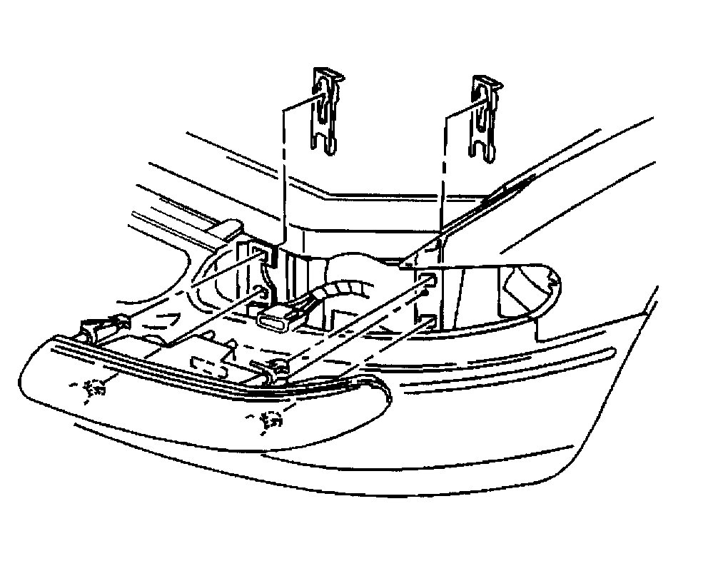

Here are the directions for replacing the bulb. You will need to remove the headlight assembly. I will include those directions, too. It is really an easy one to do. Once the assembly is out, route the wiring the same as the other side and replace the bulb.
The attached pictures correlate with removal and replacement of the headlight assembly. The directions are for headlight bulb replacement, but it shows how to remove the assembly.

pic 1
1. Raise the hood.
2. Apply light pressure to the headlamp lens to hold the headlamp assembly in place while removing the retainers.
3. Lift up the headlamp assembly retainers to release, then remove the retainers.
4. Carefully remove the headlamp assembly mounting tabs from the slots in the upper fascia support and the fender reinforcement.

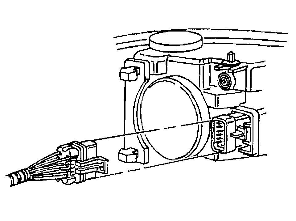

pic 2
5. Disconnect the electrical connector from the headlamp assembly.
6. Remove the headlamp assembly.
INSTALLATION PROCEDURE
pic 3
1. Connect the electrical connector to the headlamp assembly.
pic 4
2. Carefully position and install the headlamp assembly mounting tabs to the slots in the upper fascia support and the fender reinforcement.
3. Apply light pressure to the headlamp lens to hold the headlamp assembly in place while installing the retainers.
4. Align the headlamp assembly retainers over the headlamp assembly mounting tabs, then press the retainers down until fully seated.
Check to be sure that the headlamp assembly is securely retained.
5. Close the hood.
6. Check the headlamp aim, If a new headlamp assembly was installed, or if service or repairs in the front end area may have disturbed the headlamp mounting brackets. Refer to Headlamp Aiming.

So in the first picture, there's a bulb that is missing in the harness? I thought the bulb would be on top by where the headlamps are.

So in this picture below, what exactly am I looking at.

You are seeing the light socket that screws on the rear of the light housing. I believe this one takes a quarter turn to fasten and unfasten. If the bulb was replaced at one time, it may not have been secured. For some reason it came loose and dropped down.

So the picture below has a bulb missing at the end of the beige compartment. Why would there be a bulb there if the headlamps and turn signal compartments are above.

Please bear with me. That looks like the beige part is the light socket and at the end it looks like a broken bulb. Can you provide a picture from a different angle so I can see if from a different point of view? It looks like what I described, but now with you new question, I'm questioning myself. It could be an ambient air temp sensor or even a sensor for the airbag.
As far as why I believe it to be what I first mentioned is based on the turn signal going a different speed and not working. If it came disconnected, then the harness could have dropped down. I hope you understand.
Sorry, it's hard to tell from pictures sometimes.

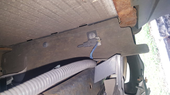

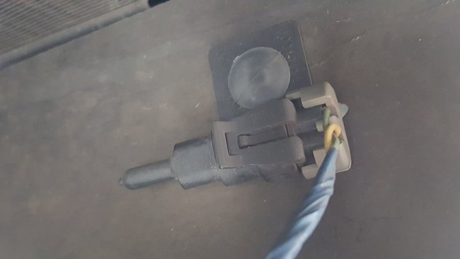

The picture below is from the passenger side underneath the car. The 'broken side' should be the same, no?
Aug 31, 2019 at 7:28 PM
  • 110,193 POSTS
Welcome back:
Yes, that sounds correct. The one in the last picture you sent is the ambient air temperature sensor. Is it possible for you to get me a picture from a different angle so I can confirm or can you confirm that it is the same as the one in the last picture?
See picture 1. That is of the ambient air temperture sensor.

What does the ambient air temperature sensor do? Is that related the HVAC system?

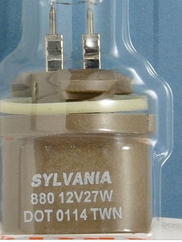

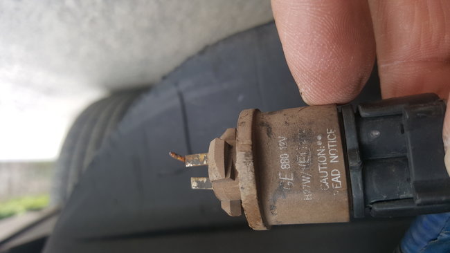

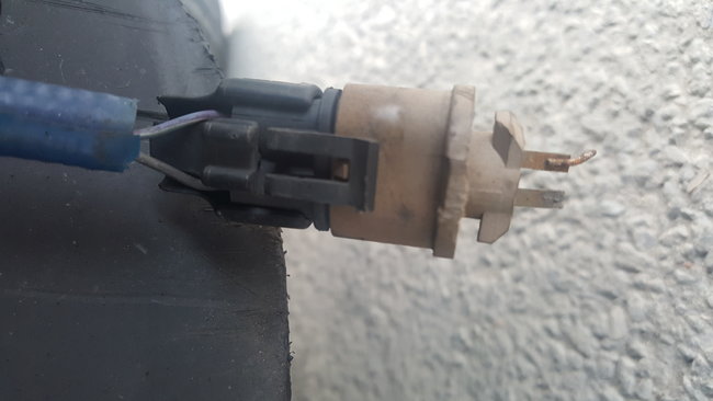

Here are some more pictures. The first picture is the defective ambient air temperature sensor. The second picture is the left passenger side harness which is fine. I don't think that is a temperature sensor it is something else. As you can see, they do not look alike. What do you think it might be. Just curious. You think there are 2 temperature sensors?
Sep 1, 2019 at 5:49 AM
  • 110,193 POSTS
Welcome back:

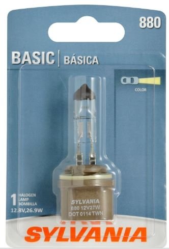

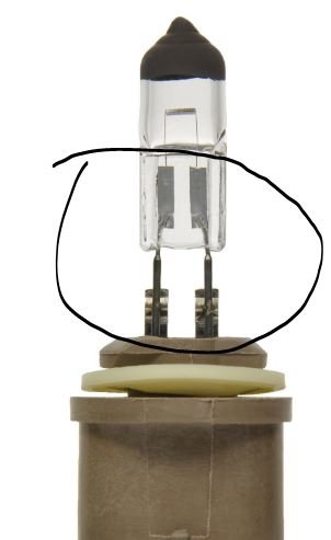

I'm back to my original thought but with a twist. It is a light, a GE 880. Most likely a fog light. Does the vehicle have fog lights? The bulb is a fog light bulb. The glass is broken off it, but I'm certain that is what it is.
See the attached pictures. If you look at pics 1 and 2, you see the electrodes in the bulb that are partially left on yours. I circled them in the second picture. Picture 3 is the bulb in the package.
It was hard to tell in your original post, but I thought it was a bulb. That's why I needed pics from different angles to confirm. When you said there was a turn signal issue, then I suspected it was the signal bulb. Does that make sense? LOL Not being there makes it tricky, but I feel very confident that is what you have.
Let me know if the vehicle has fog lights.
I will watch for your reply.
Sep 1, 2019 at 6:05 PM

Yes, thank you. Now I see what you were saying that the bulb fell off. The fog lamps haven't worked for awhile. The harness fell off the fog light compartment that's why the fog lamp compartment is loose. Maybe the previous owner started fixing it and never finished.
Thanks for all your help with this issue. I am so glad you were able to figure out the cause of the problem. A million thanks again.

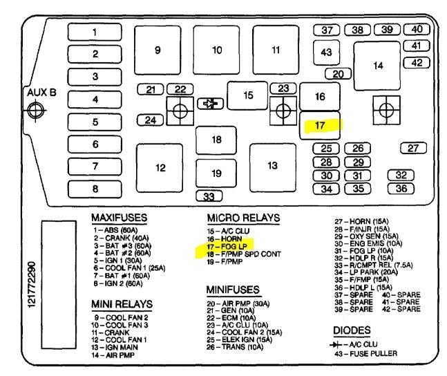

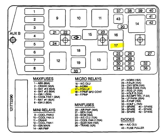

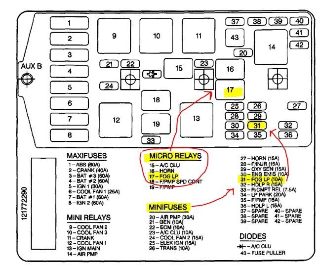

As far as a fuse, it is in the under hood fuse box. Fuse 17 is for the fog lights. I attached a picture of it below.

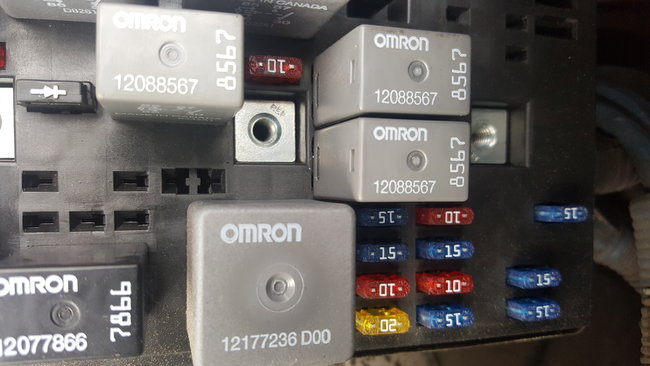

Now, I found the fuse #17 but it looks different than the regular fuses (red, yellow, blue ones on picture below). It's a grey box. I didn't think that was a fuse.
Does the just pull out?

On the top (picture below), there's a white arrow pointing down on top of an upper case white letter 'T'(black rectangular button).
What is that for?

First, I'm sorry. Number 17 is the fog light relay. The fuse is number 31.
Take a look at the attached picture.
Let me know if that helps, and sorry for the mix up.

I did see #31 but the fuse was okay.
