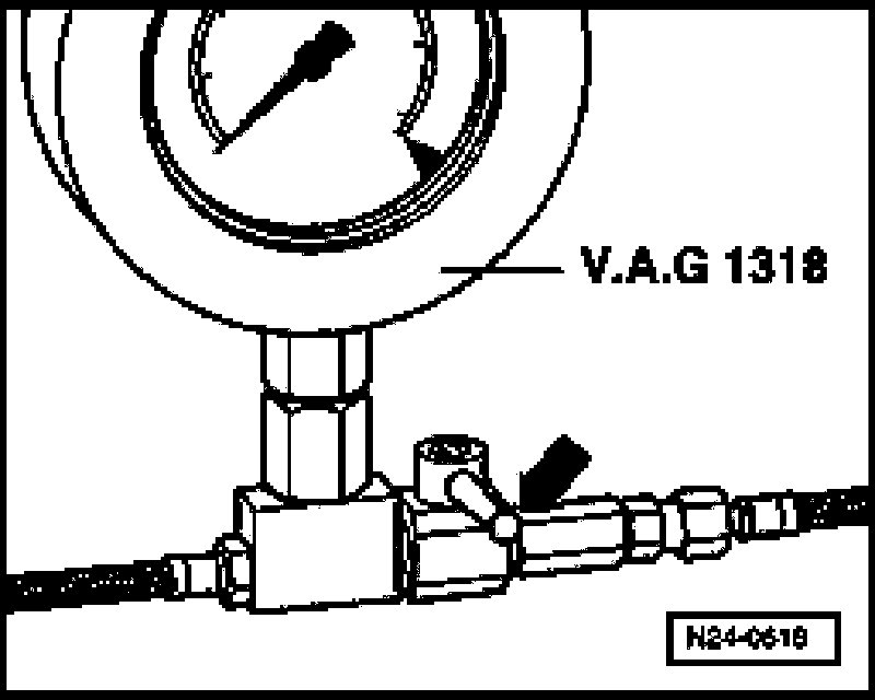

Here are the directions specific to checking pressure on your vehicle. You will need a scanner to do this and few other things. The attached pics correlate with the directions.
WITH GENERIC SCAN TOOL
Fuel Pressure Regulator And Residual Pressure, Checking
Function
The fuel pressure regulator controls the fuel pressure as a function of the Manifold Absolute Pressure (MAP).
The specified value for this test is dependent on the working pressure of the Fuel Pump (FP). This is about 3.0 bar positive pressure

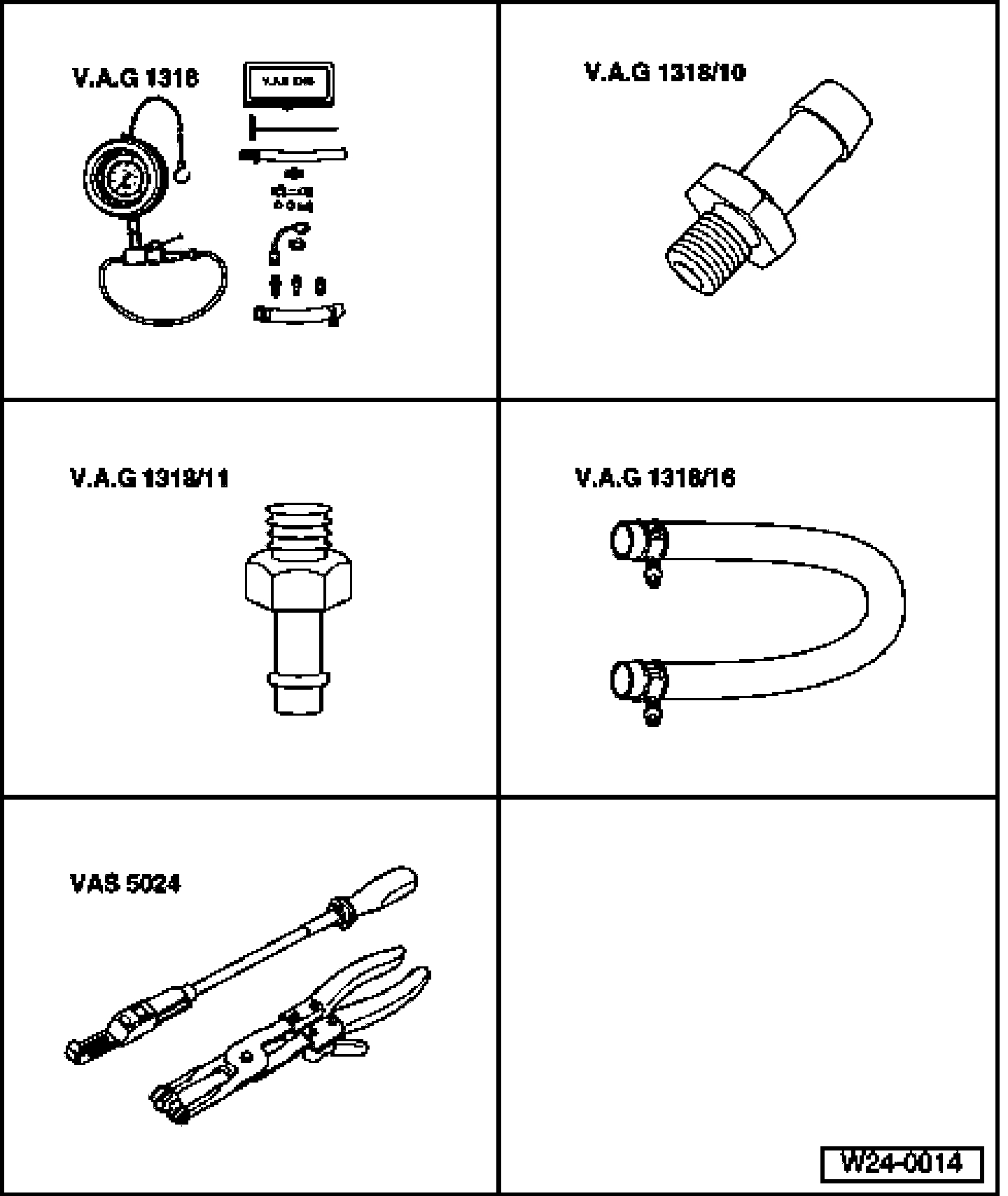

Recommended special tools and equipment
pic 1
- V.A.G 1318 pressure gauge
- VAG1318/10 adapter
- VAG1318/11 adapter
- VAG1318/16 hose adapter
- VAS5024 assembly tool for spring-type clamps

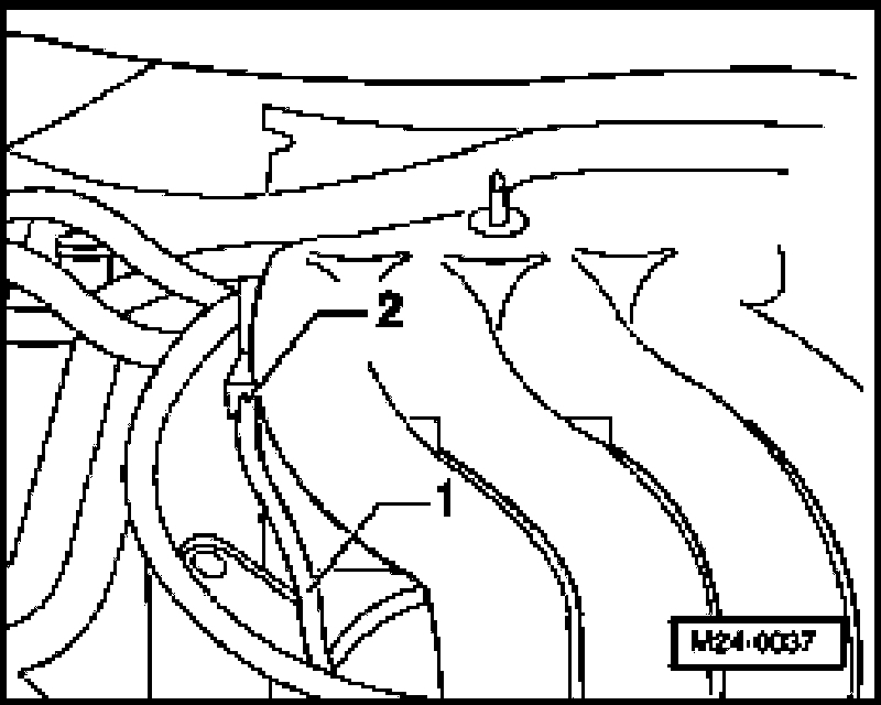

CAUTION: Fuel system is under pressure. Before opening system, place rags around the connection point. Then release pressure by carefully loosening connection.

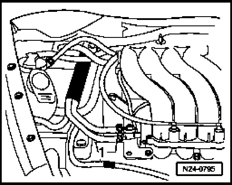

pic 2
- Disconnect fuel supply line -1- (black) from fuel distributor and catch escaping fuel using a rag.

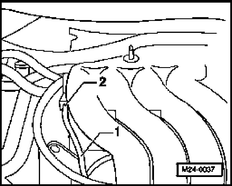

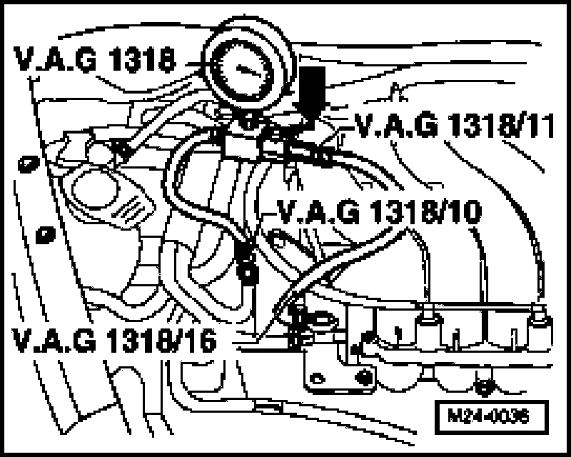

pic 3
- Connect pressure gauge to adapter (VAG1318/10) at supply hose and to adapter (VAG1318/11) and hose adapter (VAG1318/16) at supply line.
- Open shut-off valve of pressure gauge. The lever points in the direction of flow (arrow).
- Start engine and let run at idle.
- Measure fuel pressure. Specified value: about 3.5 bar positive pressure.
pic 4
- Disconnect vacuum hose -1- from connecting piece -2-. Fuel pressure should rise to about 3.0 bar positive pressure rise.

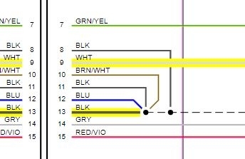

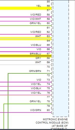

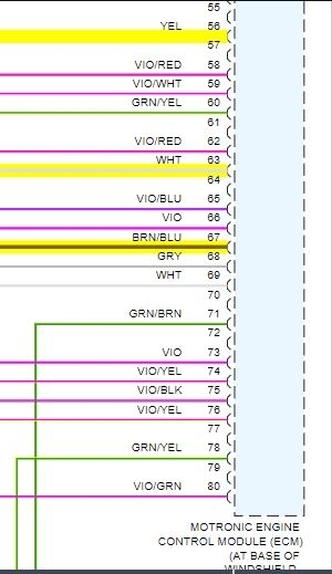

The 16705 code in my car prevents spark to the engine due to it not knowing the engine's RPM speed. I can't start it to check fuel pressure, and I replaced the entire smog system. No vacuum leaks as far as I know. The 17521 code went away after I replaced the O2 sensors and only came back on after I have been cranking it. I know that there's air in the fuel line due to me having to disconnect it to rwplace the camshaft sensor. I'm at a total loss. On the crankshaft position sensor: in the wiring between the crankshaft sensor harness and the ECU supposed to have continuity between all three terminals?
Sunday, May 19th, 2019 AT 5:54 AM
  • 110,194 POSTS
Welcome back:
They should show continuity.
P0321 16705 Ignition/Distributor Engine Speed Input Circuit Range/Performance
With that code, the ignition isn't receiving a signal from the crankshaft position sensor (Engine speed sensor). All wire should have continuity. Is there one that doesn't?
I attached three pictures. The first shows the sensor and wiring to it. The second indicates a splice in the wiring (which could be the issue). And the third shows where the three wires connect (pins) on the ECM.
Take a look to see if there is an issue at the splice and if all wires show continuity between the sensor and ECM.
