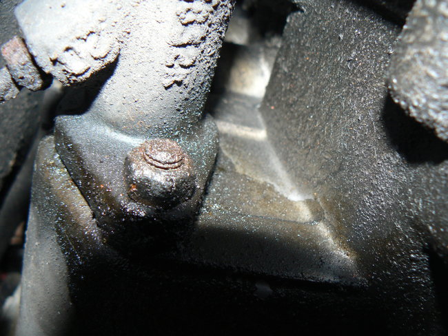

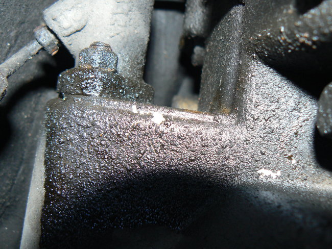

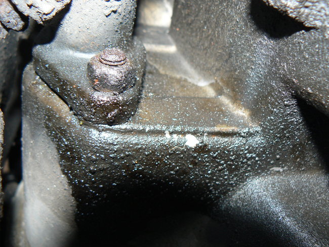

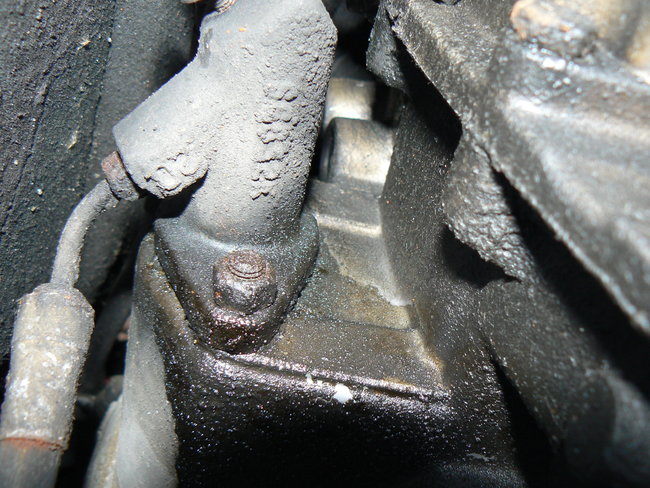

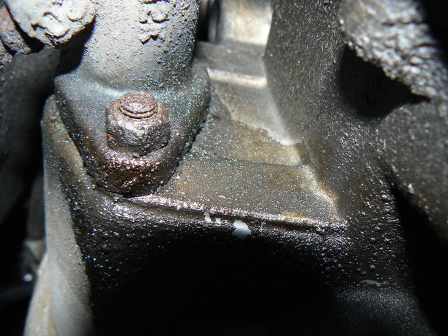

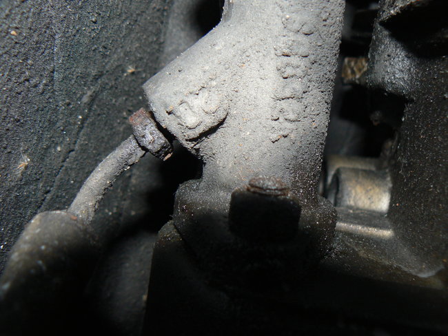

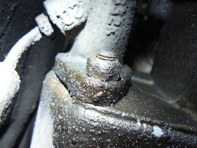

Here are the images of the slave clutch cylinder. I did not fill up the fluid as I wanted to do this first. The leak is at the bottom bolt. There is no leak at the pipe coming out of the cylinder on the left. So it looks like a seal failure, which is what I suspected. I haven't checked the clutch master cylinder yet and will probably not bother as there is no fluid inside the driver foot well (from what I remember). If you can confirm what my observations are that would be great. If you want me to do any more steps before buying a new unit I will do so.
I didn't take a picture where the bleed valve was but there was no leak there either.
Mar 17, 2019 at 10:30 AM
JOETECHPRO
  • 705 POSTS
Hey CHRISTOPHER SA,
I would say you are correct and it looks like you have a leaking slave.
One additional consideration will be if the clutch has been contaminated by the leaking brake fluid. This you may be able to inspect partially through the slave cylinder mounting hole but to fully check you would need to remove the transmission.
You can try just replacing the slave and seeing if the clutch works okay, but if contaminated it will potentially slip and require replacement.
To replace the slave cylinder it is a case of removing the old unit, disconnecting the line connecting the new unit. It will then need to be bled and installed.
Regards, Joe

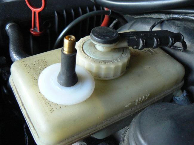

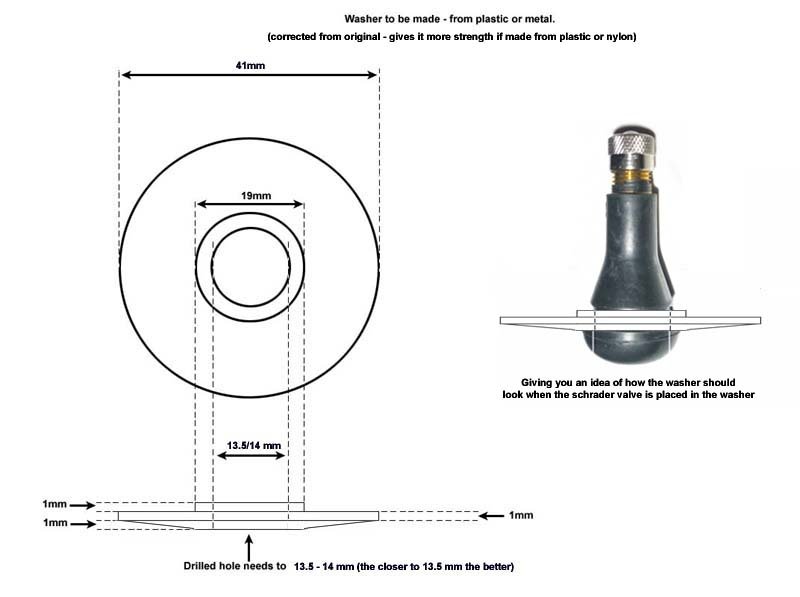

To get the master brake fluid cylinder put under pressure (without buying expensive equipment) I made up a washer (see image) with a schrader valve (obtained for free from a place where they put new car tires onto your car) in the middle thinking that I could use a bicycle pump and put it under pressure that way. The image shows what the washer looks like beside the cap to the master brake fluid reservoir. I also put epoxy around the underside of the valve so that there would be no leaks at the point where the schrader valve goes through the washer.
The cap is removed, the central part is unplugged and removed from the cap and the washer with the valve put in place of the central bit. The washer was a snug fit and used the rubber washer under the original piece in the cap as a means of sealing the unit.
I filled the reservoir with brake fluid to about 0.75 below the valve stem's underside and used a bicycle pump to put the system under pressure.
When bleeding the new slave clutch cylinder only about two inches of fluid came through the tube before the pressure ran out. But I was able to see that there were no bubbles and I did loosen the clutch rod as stated in the instructions. I also saw that the fluid level inside the reservoir was a lot lower - around the level it should be which was about an inch lower than when I started (the MAX line on the outside of the reservoir).
It could be that I have to bleed it for much more than what I did. If so I will have to rethink how to put the reservoir under pressure.
If that doesn't work I may have to replace the master clutch cylinder which is really difficult to get to (behind the clutch pedal). Mind you, there are no leaks of brake fluid inside the vehicle.

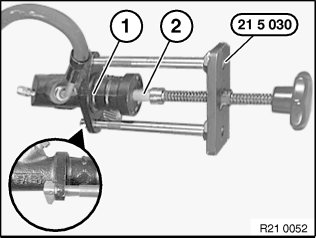

Here are the instructions from the Bentley manual (for bleeding an old unit):
1 . Remove brake fluid reservoir cap. Using a clean syringe, remove brake fluid from reservoir. Refill reservoir with clean fluid.
2. Attach pressure brake bleeder to fluid reservoir.
CAUTION - Do not exceed 2 bar (29 psi) pressure at the fluid reservoir when bleeding or flushing the hydraulic system.
3. Connect a length of hose from clutch slave cylinder bleeder valve lo a container.
4. Open bleeder valve and allow brake fluid to expel until clean fluid comes out free of air bubbles.
5. Close bleeder valve and disconnect pressure bleeding equipment from fluid reservoir. Hose on bleeder valve remains connected.
6. Slowly operate clutch pedal about 10 times. Fill reservoir with clean fluid as necessary.
7. Unbolt slave cylinder from transmission.
8. Position slave cylinder so that bleeder valve is facing up (highest point).
9. Open bleeder valve and slowly push slave cylinder push rod all the way in . Close bleeder valve and slowly release pushrod. Repeat procedure until fluid runs out clear and without bubbles.
10. Disconnect bleeder hose. Install slave cylinder to transmission. Add clean brake fluid to reservoir as necessary. Check clutch operation.
I missed out steps 7 - 9. After bleeding I attached the slave cylinder back to the transmission (and never took it off again). I pumped the pedal a few times and when nothing happened I thought that it had not worked! Now I know what to do. Hopefully the above steps will work.

That is an ingenious design. Just don't apply too much pressure or the master cylinder can be damaged. As far as the steps missed, chances are there is a lot of air stuck in the slave. By the way, I totally agree about getting under a vehicle on jack stands. Just be careful. Let us know if that takes care of the problem.

1. I attached my made up schrader valve washer and put the system under pressure with a bicycle pump that had a pressure gauge attached which I had purchased for about $15. The pressure was pumped to 29lbs psi. This schrader valve washer worked very well.

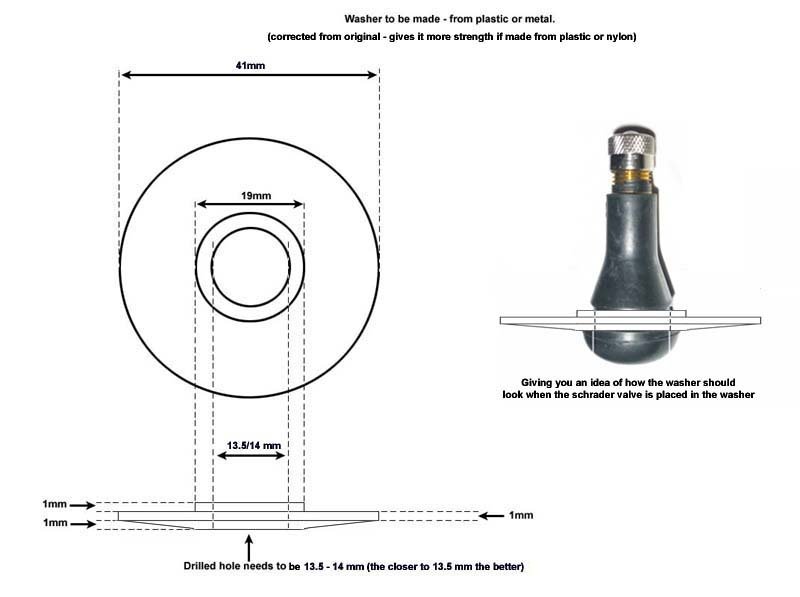

Getting correct instructions is vital - buy or download a Bentley's manual. It has very good instructions.
No matter what hose you get the nipple on a non-BMW slave cylinder is not the same as the nipple on a BMW part. See of you can salvage the nipple from the original slave cylinder and swap it in place of the one on the new slave cylinder. The original one is made of brass and new ones are aluminum (on non-BMW parts), plus the stem on a new one is very short and does not give one enough room to use a clip to securely attach a hose. If you can't do this, position the clip about 0.5 inches above the end to be able to grip with your fingers to keep the hose in place.
This job can be done by one person if using the schrader valve washer system I created. One also needs to buy a hand pump with a pressure gauge. These items are quite cheap and can be purchased for less than $20. The schrader valve can be obtained for free from any tire shop. Making up the washer could be difficult depending on whether one has access to a lathe or not.

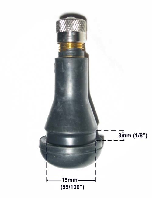

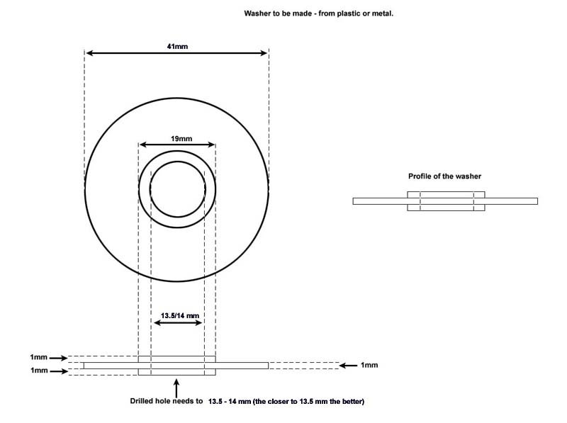

The dimensions of the washer are as follows:
Center hole - 13.5 - 14 mm in diameter (schrader valve stem is 15mm at the point where it slots in)
Height of 'collar' around hole above is 3mm.
Collar width - 19mm
Washer diameter - BMW E36 Specific - 41mm
Washer thickness for middle - 1mm
See image below for schematic.
Use epoxy resin on the under side of the washer around the valve seat to make an air tight seal. When using the washer tighten the cap as much as possible.

By the way, I have corrected the schematic of the schrader valve washer as that is the shape I actually ended up with due to the washer being distorted by the cutting tool on the lathe (even though I started out trying to cut the washer to the original shape). It turned out that this configuration was needed as the air pressure was causing the middle of the washer to bulge out slightly.
Yes, that is the conclusion I came to too (worn/corroded wheel bearings). I do find it quite interesting that things deteriorate more when they are not used!
Anyway, I find this site extremely helpful and its great that everyone involved at your end do not charge anything for the help provided by yourselves to others. That is why I give back in the way I do. This site encourages me to.
P.S. I am having trouble deleting the image on the left. I saw that there were errors in it and redid it then tried uploading the new one after deleting the old one and now the old one won't go away.
Jul 9, 2019 at 7:51 PM
  • 110,193 POSTS
Don't worry about the picture. Your directions took care of that. I've studied a lot about England and hope someday to visit. In addition to being a state certified mechanic, I teach literature in a high school. LOL Odd right?
