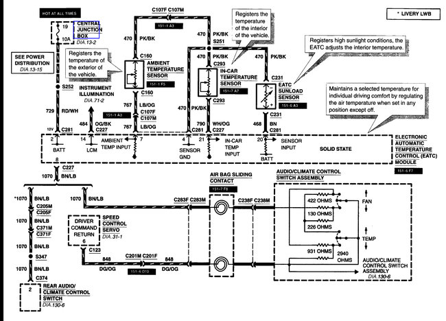

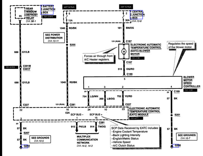

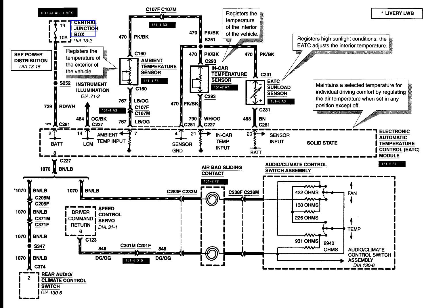

So when it is not working the control panel is not lit? If so check the fuses real close as that would indicate no power to the system at all. That usually will not be a sensor or blower motor, it would be in the power feeds into the ETAC.
It has probably set a code but unless it is a really good scan tool it likely does not scan all modules. It may also erase the code if it is power loss to the system. This is the wiring covering the main parts.

The lights stay lit, whether the unit is blowing or not. I did not mean to say otherwise. I will check the fuses and connections very closely to see if anything can be found. Thanks for the diagrams.
