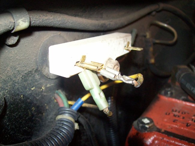

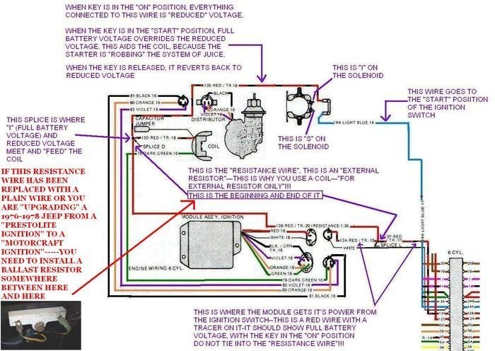

You now have a Motorcraft ignition (introduced to CJ's in 1979)
You need a coil for a 1979 (no internal resistor)
and a ballast resistor ( as the 1978 did not have a resistance wire-but the 1979 did!)

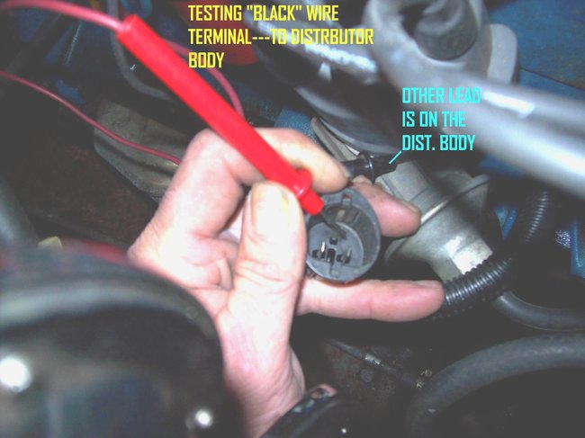

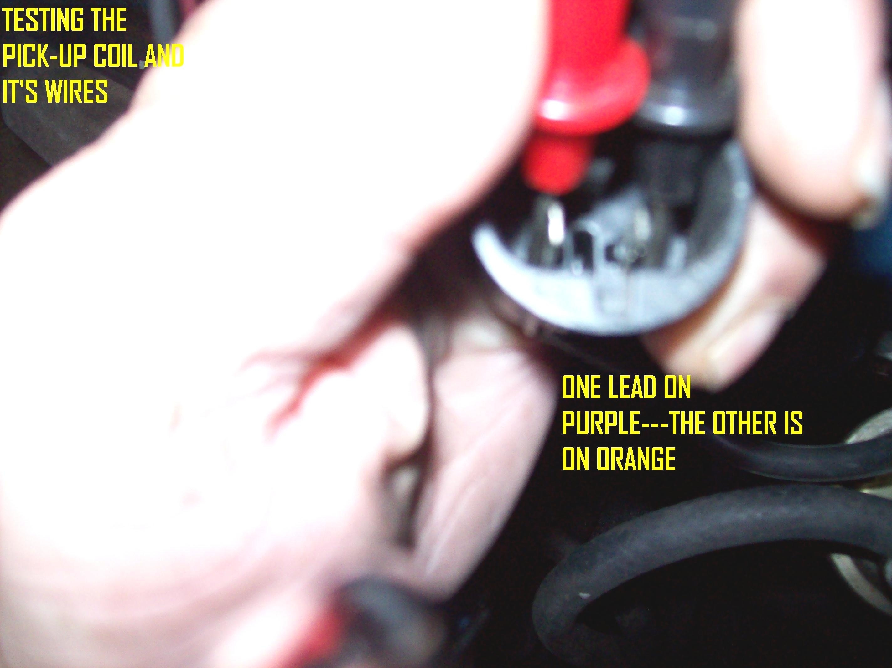

Are you wired as I show in my pics below? This is from a 1979 wire diagram. Let's check it good!

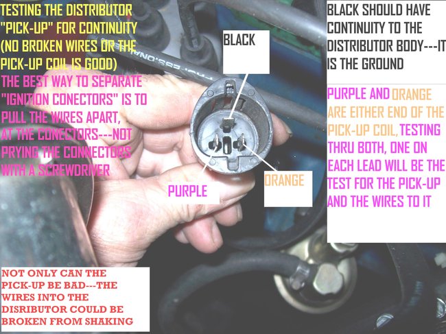

Showing a continuity test for distributor also.
(I upgraded my 1977 to Motorcraft too, Too many quirks with the whole Prestolite deal that left me stranded too many times).

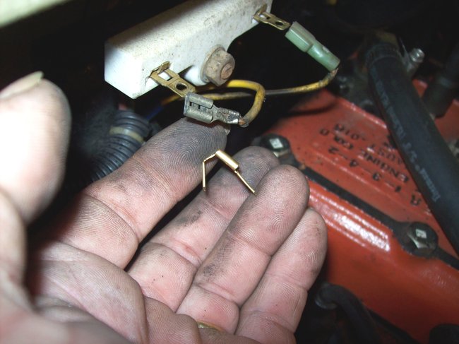

This is the one that it calls for on a 1979.
http://www.autozone.com/ignition-tune-up-and-routine-maintenance/ignition-coil/duralast-ignition-coil/111930_576402_17367/?checkfit=true
Ballast resistor-
.8 or .85 OHM will work,
"i Believe"- Well all of them have a pocket on the backside in which the resistor coiled wire is in.
The ones that are wide open tend to let the coiled wire maybe bounce/ move about while you are bouncing the Jeep on the road.
To me these seem to fail/ coiled wire breaks- Jeep is now dead in the water
I think the one I got last was from NAPA auto parts, It had ceramic/ or something poured over the coiled resistor wire (like a ceramic cover over pocket) I have had this one a long long time.
If you can find it anywhere, try to go with that type (OHMs the same as I mentioned) Online pics may keep you from traveling everywhere!
Should you become dead in the water, check the ballast. Just to get you in, you can temporarily bypass the ballast using a Jumper Wire/ Tying the two wire together/ use a "Piggy back" (Picture Below). Put the piggyback on one side and leave it there until you need it. Going this route, it is just "plug and unplug". Nothing' else needed! Get a new ballast soon so that everything is back to normal!

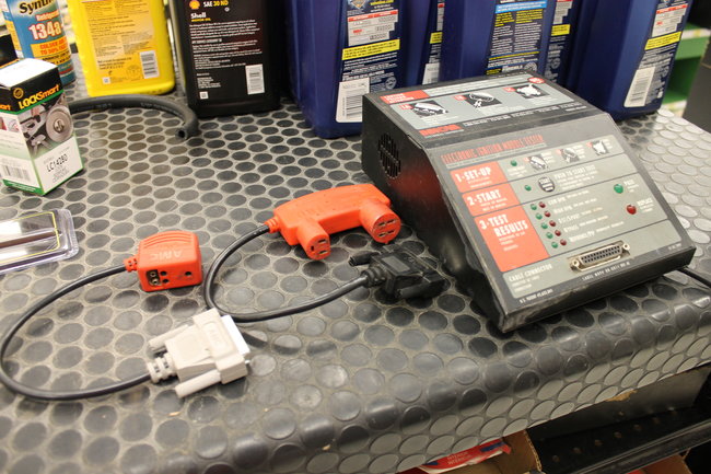

Next paragraph is taken from a 2010 answer I gave (Given it many times since then too!)

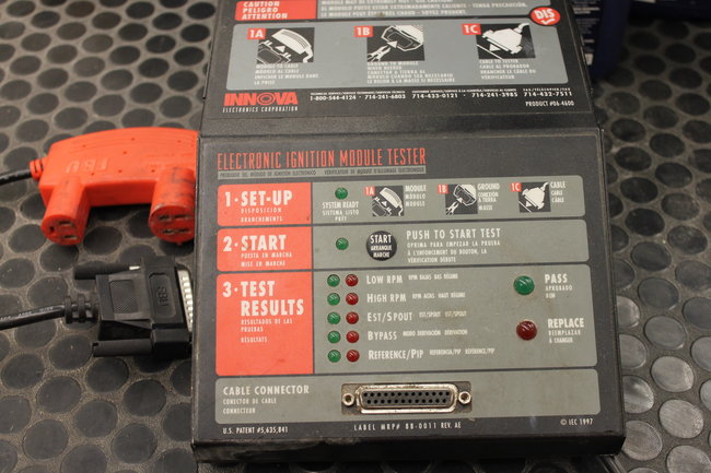

"It could be that your Ignition Module is bad (either system). Test old one at Autozone or Advance Auto for FREE, Test 5-7 times in a row and quickly, this heat up its guts! If it fails once (That is after the Tech figures out the correct plugs and settings) REPLACE IT, TEST THE NEW ONE THE SAME WAY BEFORE YOU LEAVE! TRUST ME. No matter what "THEY" say!"

If it were Motorcraft, maybe it has a resistance wire (no need for the ballast) Can you test the wire to see if it is a resistor wire (or have you replaced it with a regular wire?). I'm suggesting may be that the needed resistance has been doubled (I'm guessing).

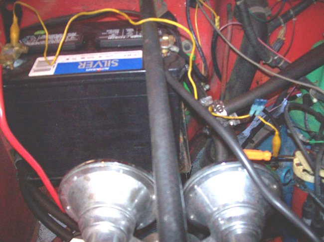

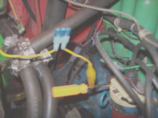

Try this! AS A TEST
Pos battery to Pos coil
See my 1st two pics, see if spark improves
Temporarily disconnect "I" at solenoid, maybe solenoid is somehow dragging it down
You tested this puppy at an auto store? Pics are of Advance Auto Parts Machine
