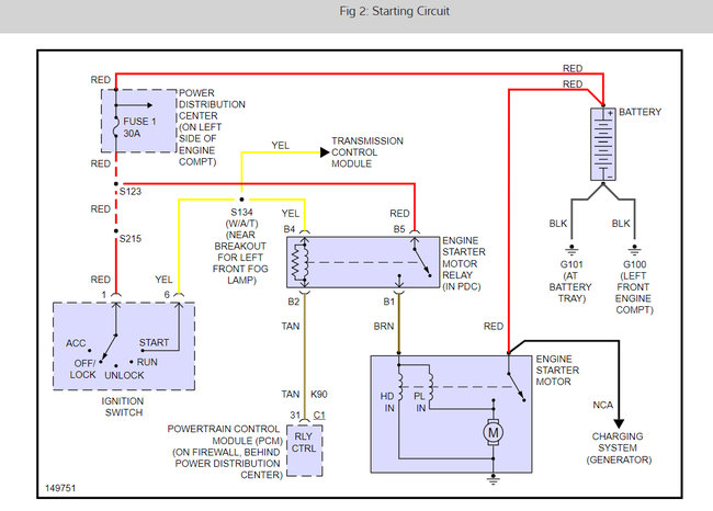

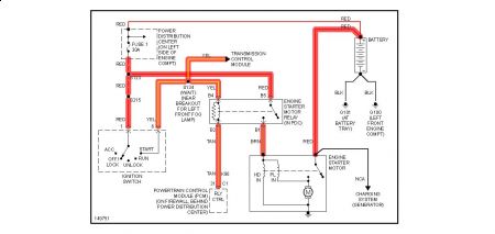

It sounds like the starter or starter relay has gone out, Here is a guide that will show you how to test and give you an idea on what you are in for when doing the job
and
and
Here is the starter wiring diagrams so you can see how it works. Please let us know what happens.

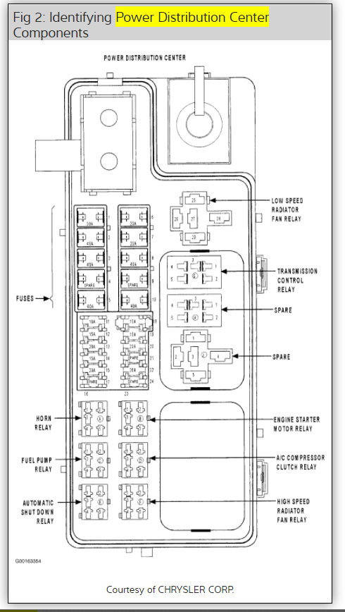

Disregard the park and neutral switch and check the starter motor relay in the power distribution center-
https://images.2carpros.com/forum/automotive_pictures/12900_starter_relay_5.jpg

Is the security light on solid or flashing?If not we need to follow this guide to see if the starter is okay. It sounds like the starter relay could be bad.
Jan 3, 2020 at 10:01 AM (Merged)
SATURNTECH9
  • CAR REPAIR CONTRIBUTOR
  • 30,869 POSTS

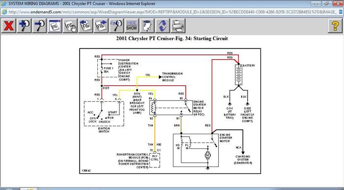

If the security light isnt on then you should have power to the yellow wire coming out of the ignition switch with the key in the start position.Also constant power to the red wire at the ignition switch.

SATURNTECH9
  • 30,869 POSTS
The red wire to the ignition goes back to the number 1 thirty amp fuse in the under hood fuse box like it shows in the wire diagram i posted.So see if there is power to both sides of that fuse.
HOWTODRIVESAFE
I was wrong red is hot yellow is not. I installed a new ignition switch that fixed it
