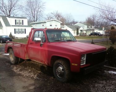

1985 Chevy C10, 350V8 4 Speed Manual Trans. 1 Ton Dually.... I am wondering what the usual cost is for service on my Manual Trans. Clutch. My clutch is going out and I need the parts replaced. What is the cost usually for this service? I have never replaced a clutch before.
https://www.2carpros.com/forum/automotive_pictures/375173_Photo0029_1.jpg
Saturday, June 20th, 2020 AT 1:18 PM (Merged)
2CARPRO JACK
  • 11,533 POSTS
Looks like about 4.5 hours of labor. As far as the clutch itself, it will depend on what you decide to use. Reman clutches are less expensive but tend to have more problems, I always go with new. Looks liek those clutchs go from about $450 on up, so you may want to call and shop around for different options
