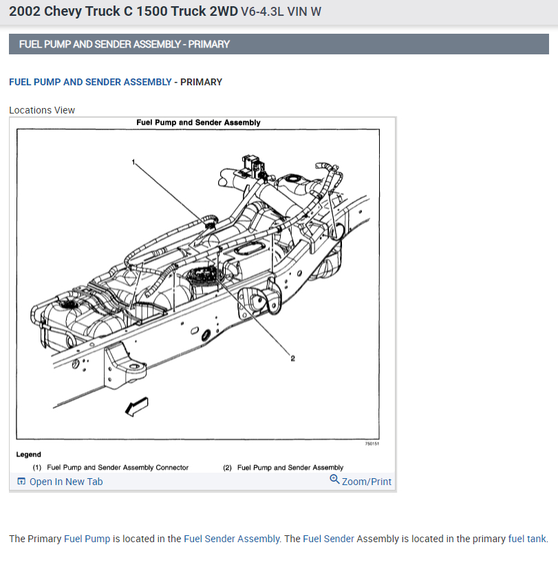

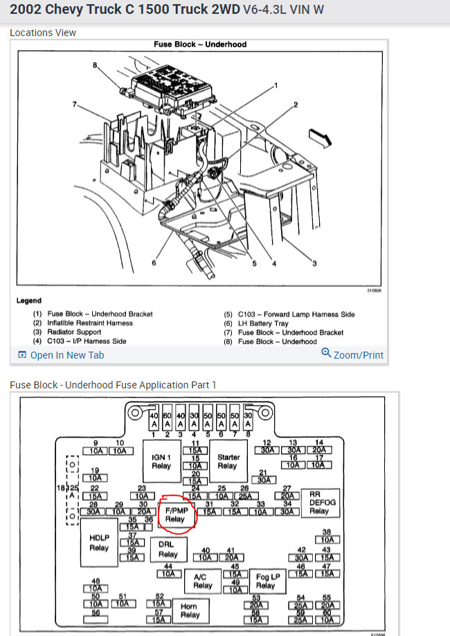

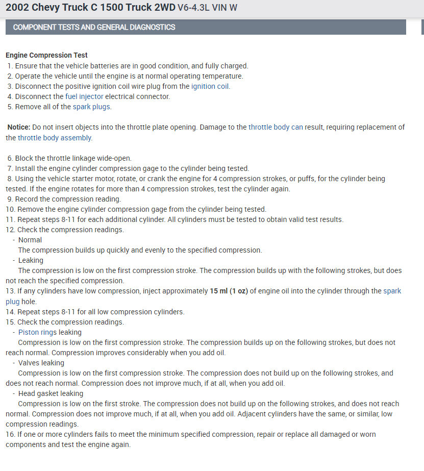

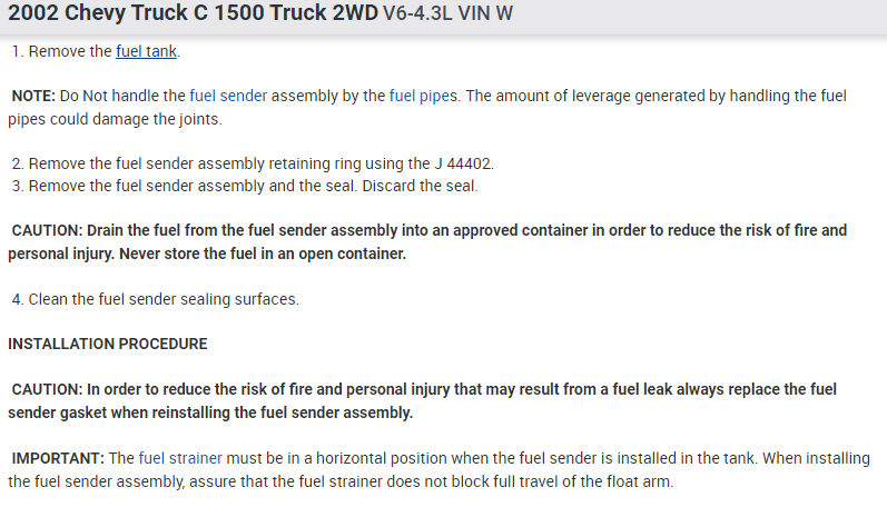

You will need spark, fuel and compression to start the engine.
Have you got a chance to check for spark and fuel?
You can check for fuel pressure.
You should have 55-62 PSI of pressure with key on and engine off.
https://www.2carpros.com/articles/how-a-fuel-pump-works

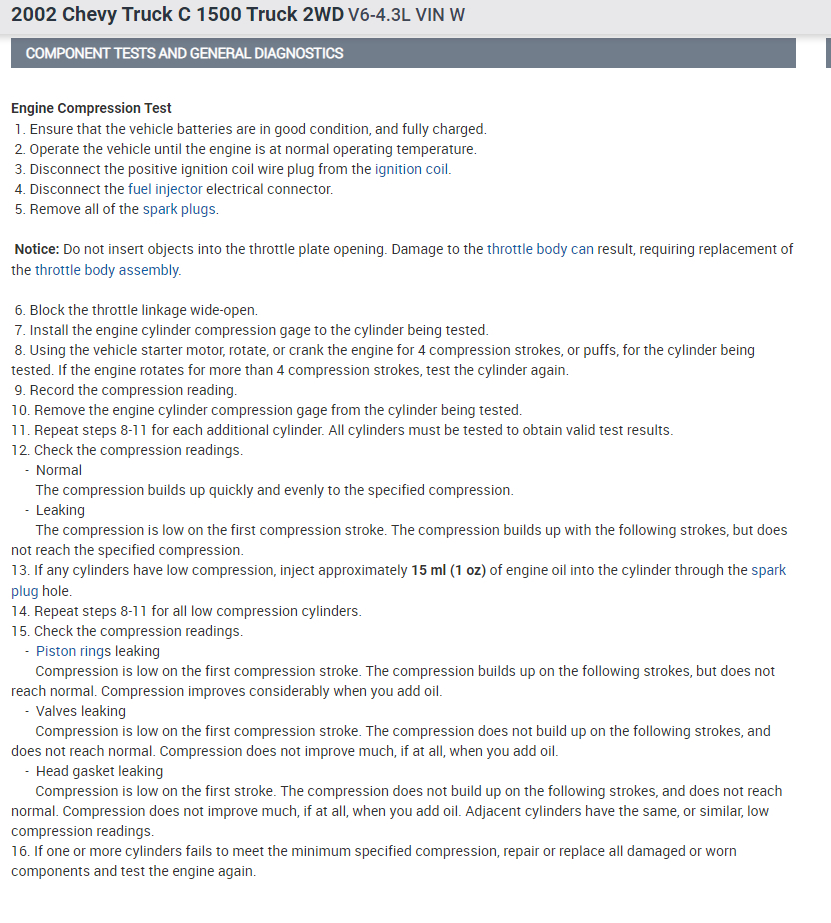

Last item would be check for cylinder compression.
Low compression will keep the engine from starting even with spark and fuel.
Here are few helpful articles:
https://www.2carpros.com/articles/the-reasons-for-low-compression
https://www.2carpros.com/articles/symptoms-of-low-compression
