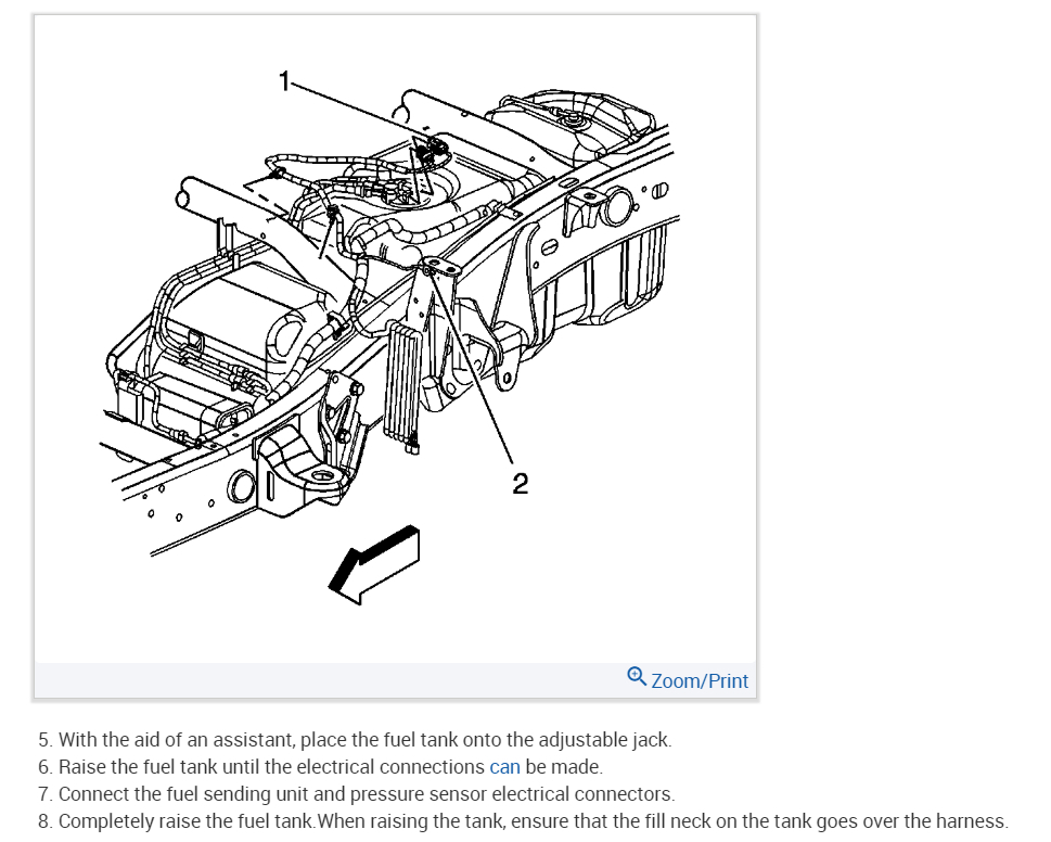

Pickup died while driving - won't start back We messed around with wiring inside of dash - really doing nothing - pickup did start - fuel pump was working when started - turned it off and it wouldn't start back after that - it turns over just won't start

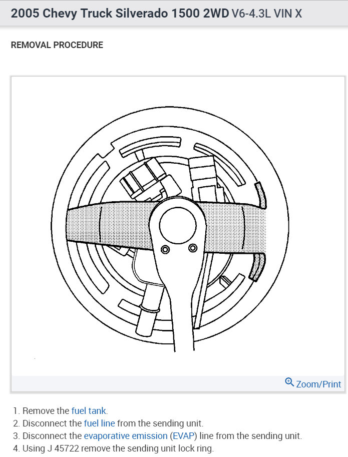

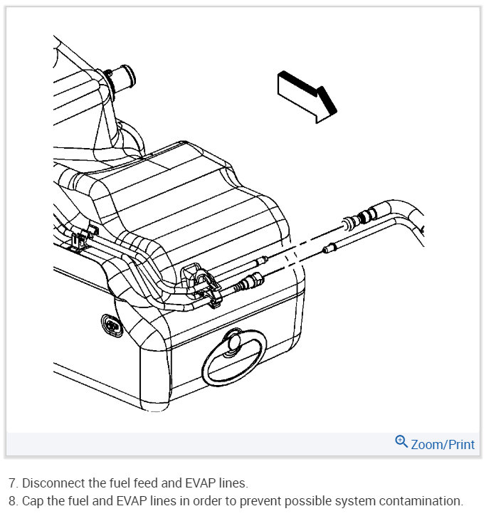

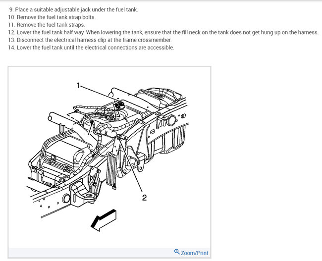

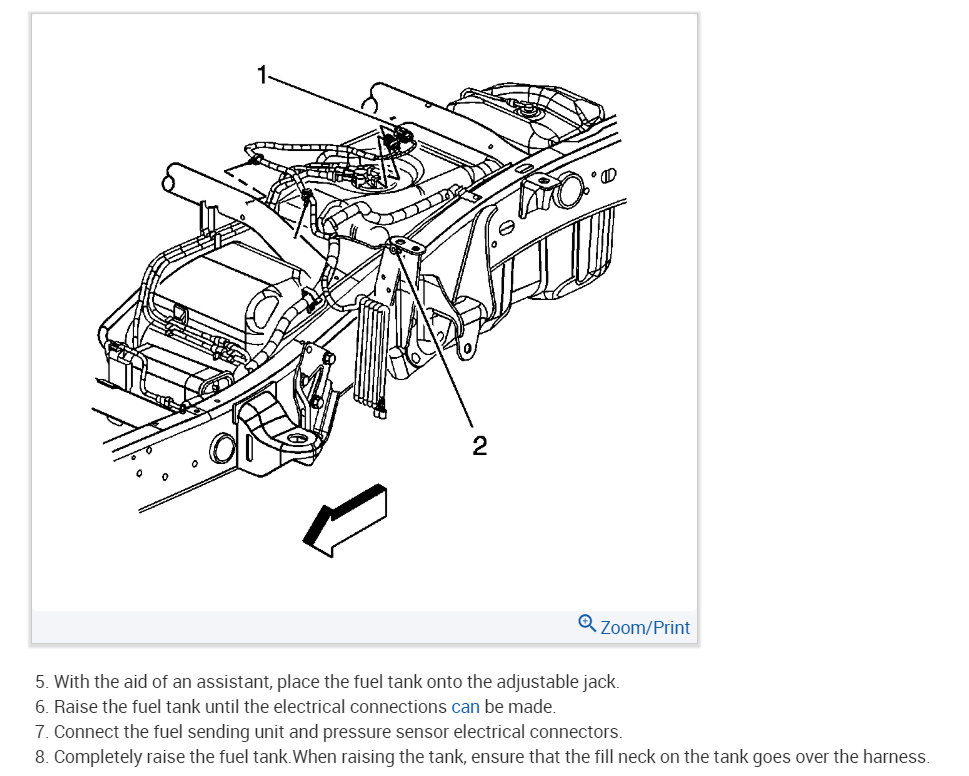

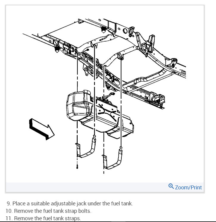

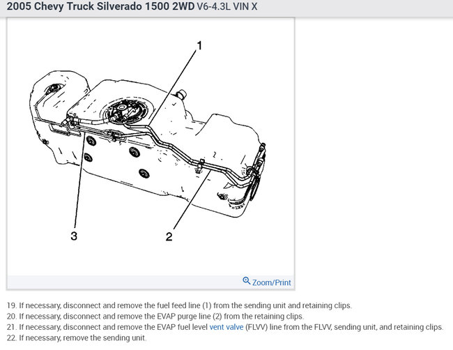

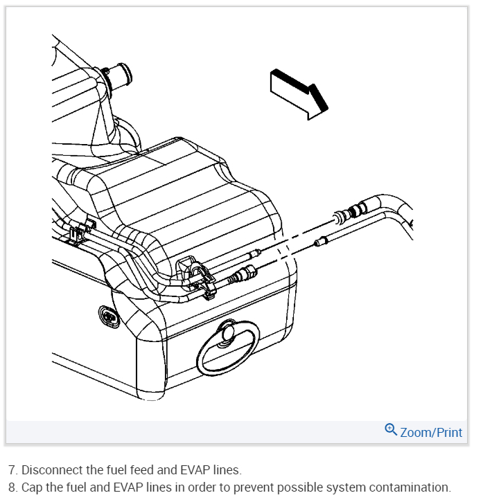

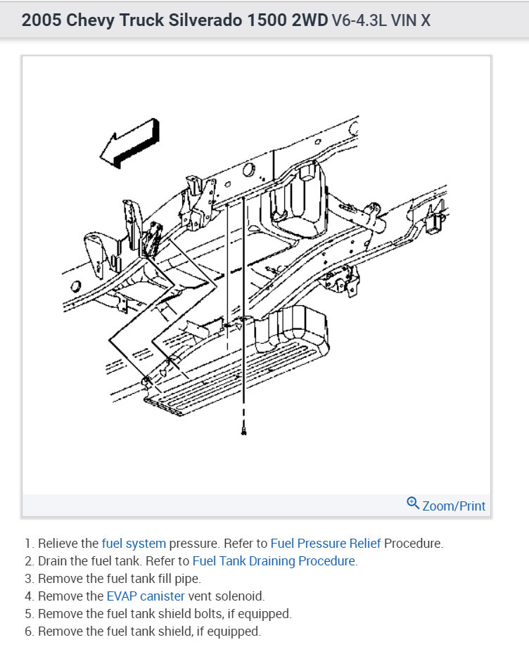

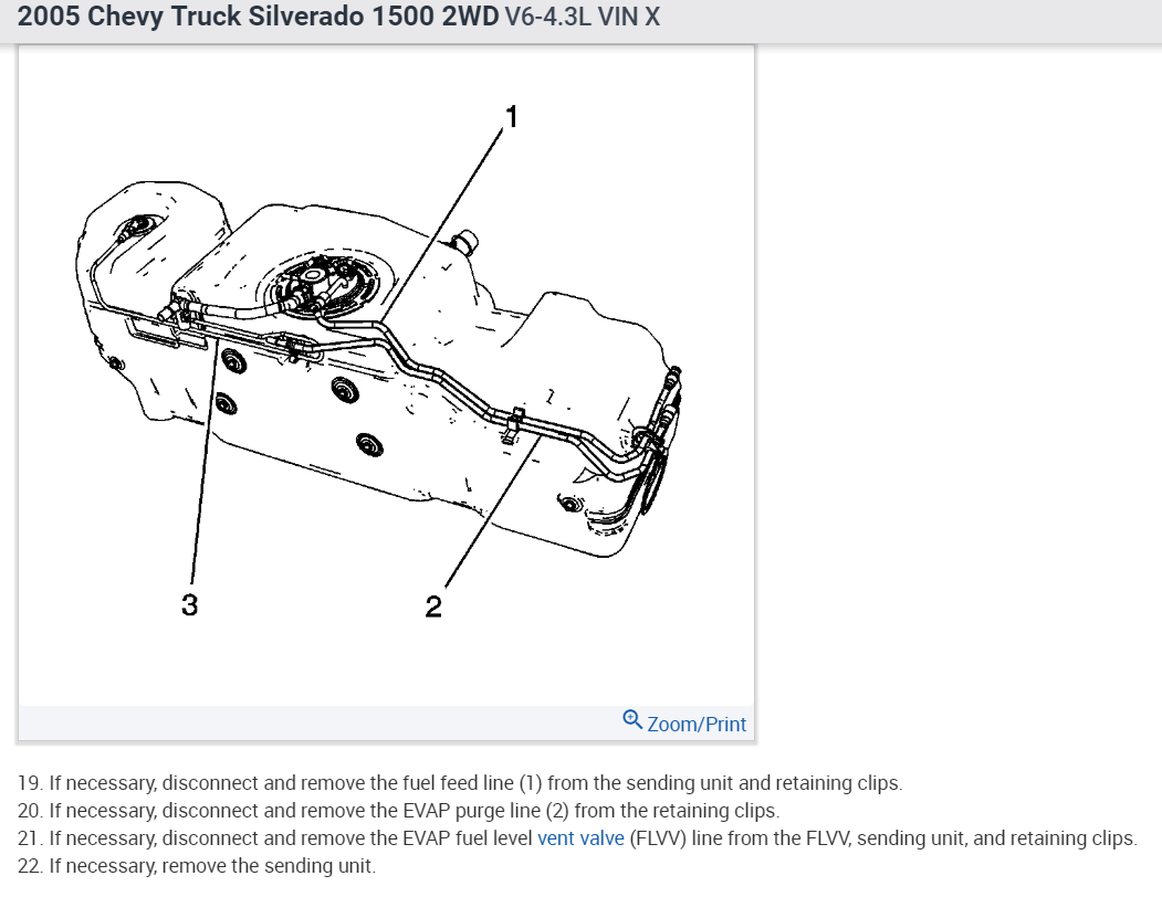

It sounds like the fuel pump is out here is a guide to help you fix it and diagrams below to show you on your truck.
https://www.2carpros.com/articles/how-to-replace-an-electric-fuel-pump
Check out the diagrams (Below). Please let us know what you find. We are interested to see what it is.

Thank you for responding. Through process of elemination we took a rubber mallot and hit on the middle of the gas tank - the engine would start and run as long as we were tapping on the tank. We replaced the fuel pump and are on the road again!
