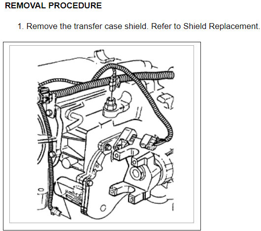

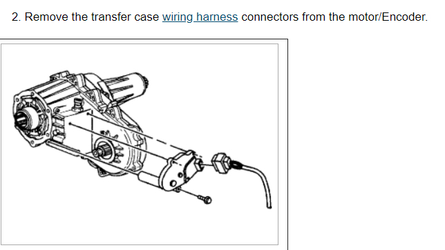

Yes you can replace the actuator yourself here is a diagram to help you get the job done. The actuator encoder as they call it is on the side of the transfer case.

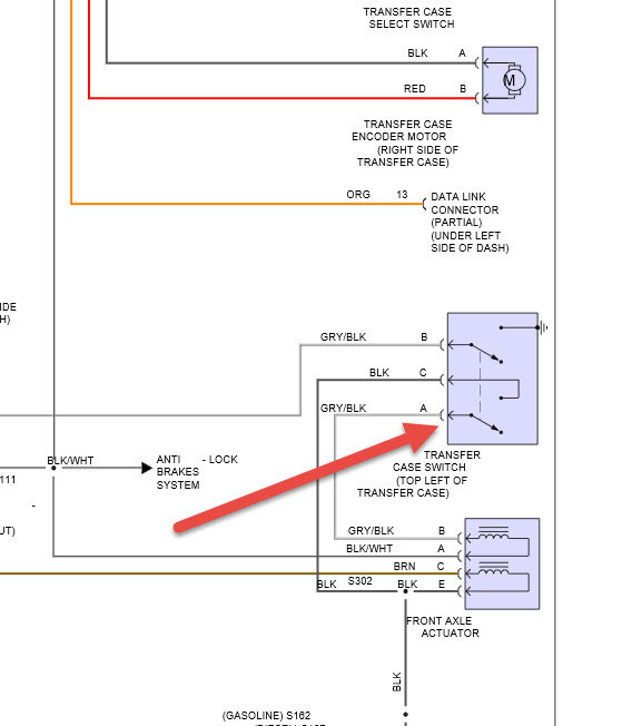

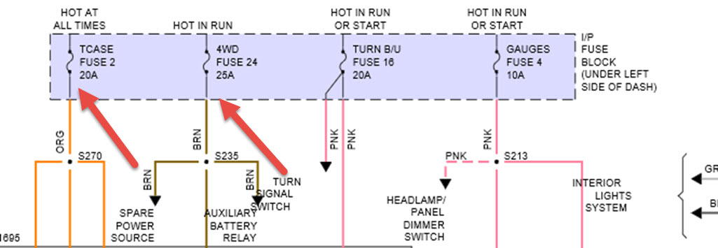

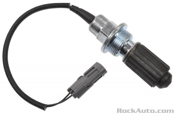

You cannot jump anything to read codes a scanner would be needed for this. Put old tcm back in if you have it and check to see if power is going to encoder motor on tcase. Check fuses where shown in pic and also check to see if encoder motor is getting power and working. Finally check switch on tcase where arrow is to see if that is working.

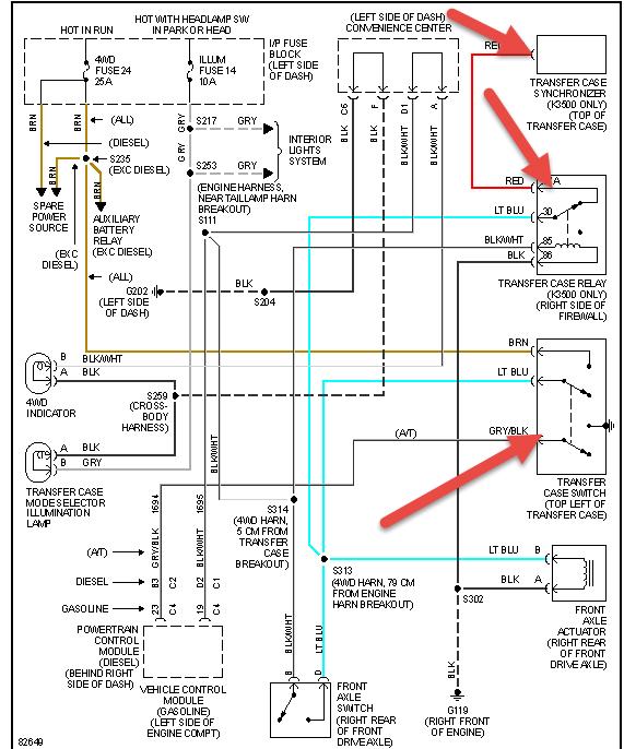

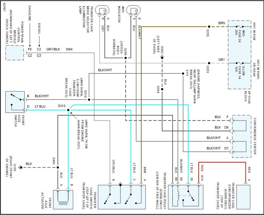

TONY E HILL
No power to actuor I replaced switch in cab still dosnt work is their a fuse inline ihave checked all outher fuses
+5
Wednesday, September 2nd, 2020 AT 10:49 AM (Merged)

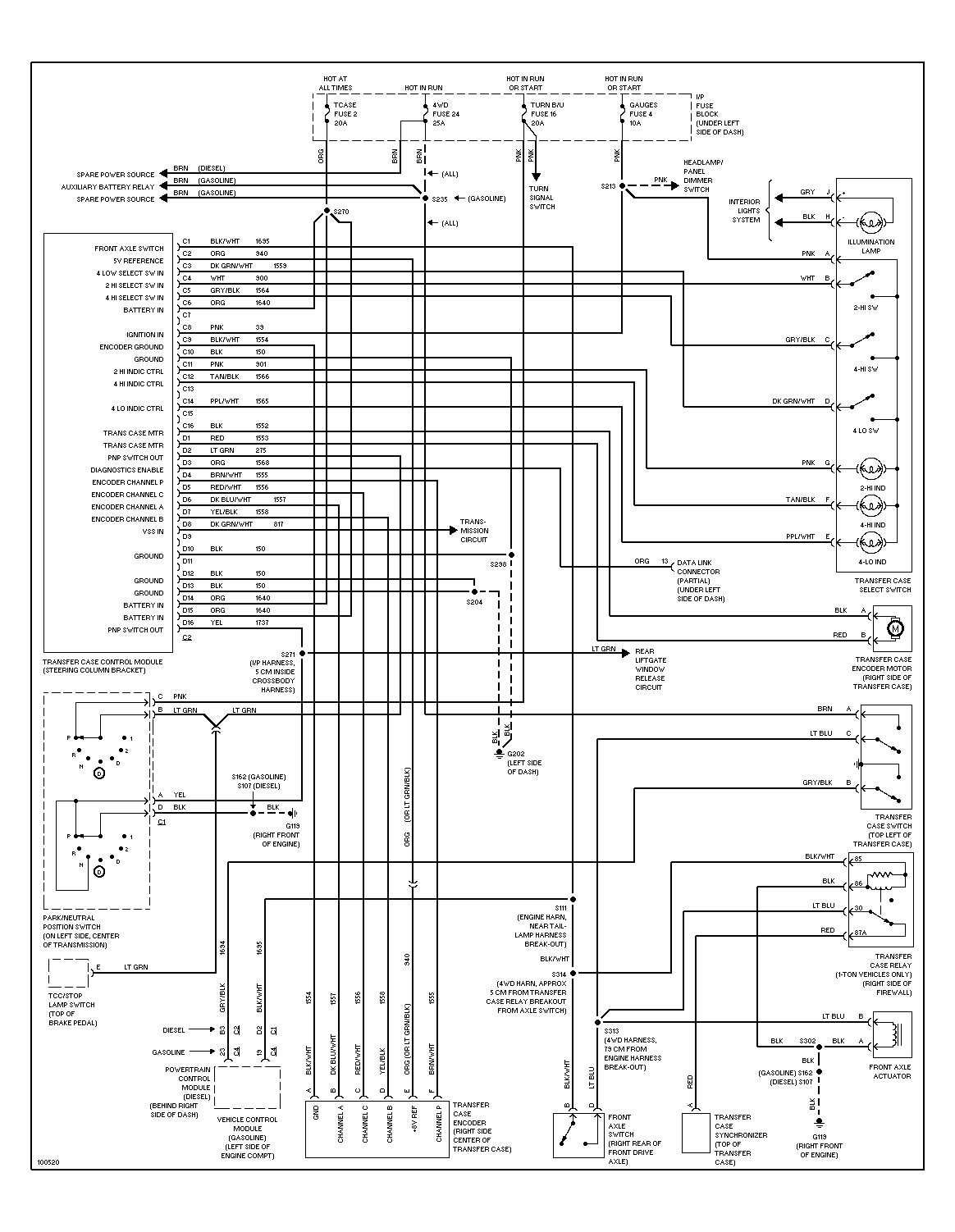

  • 108,192 POSTS
I attached a wiring schematic for the transfer case electrical. Take a look and see if it helps.
+4
