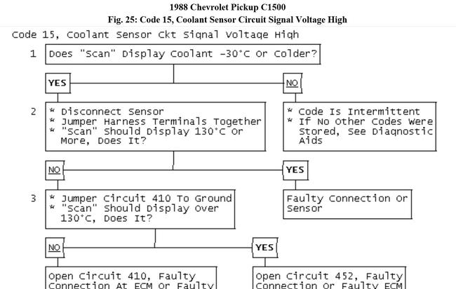

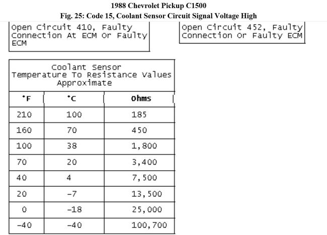

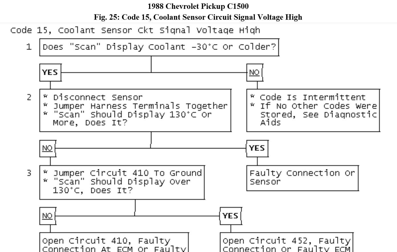

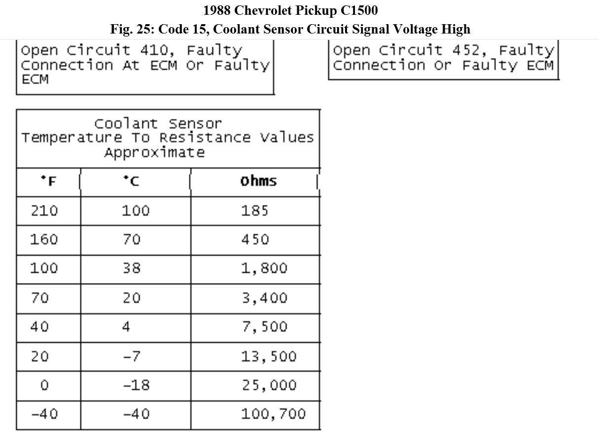

This means the problem is most likely intermittent and could be due to a loose wire, ECM or the charging system.
The chart below shows how to go about testing the circuit.
