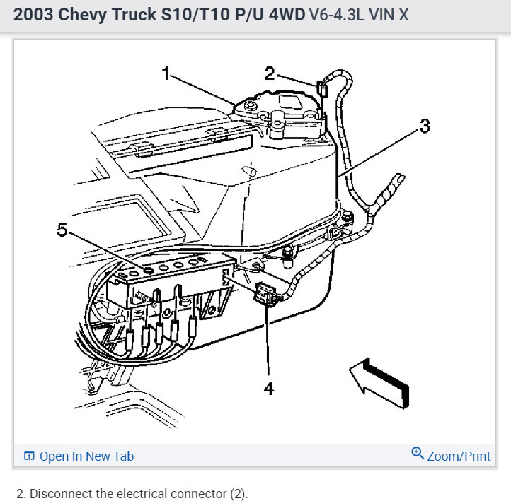

have replaced thermostat, flushed heater core,still get heat sometimes, but does not last. tested the temp control switch has 9.92 ohms, and it is variable with turn of the control shaft. what does this temperature control switch actually control? Is it a valve? the truck runs great. runs about 210 degrees and is full with antifreeze. does not overheat. It used to have heat really fast, the heater core has been replaced, and worked fine for a winter, it was working then it started to have sometimes heat.
Oct 3, 2020 at 12:09 PM (Merged)
SATURNTECH9
  • CAR REPAIR CONTRIBUTOR
  • 30,869 POSTS

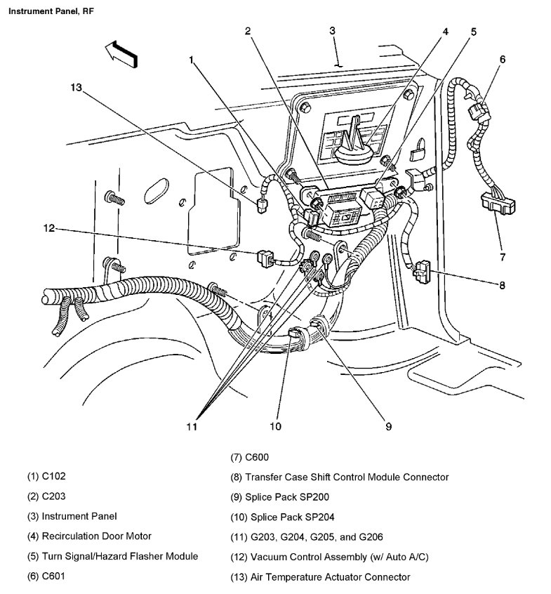

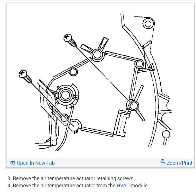

There is a temperature blend door actuator to control the temp. Here is a guide to show you what you are in fro when changing it out with the location of the actuator for you car below.
this guide can help as well
With the engine up to operating temp are both the heater hoses going into the heater core getting too hot to hold?
Check out the diagrams (Below). Please let us know what you find.

I changed out the actuator and now I have heat again! thank you so much I has freezing. I love this site
