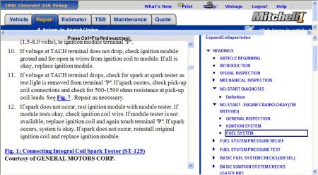

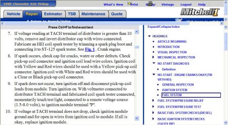

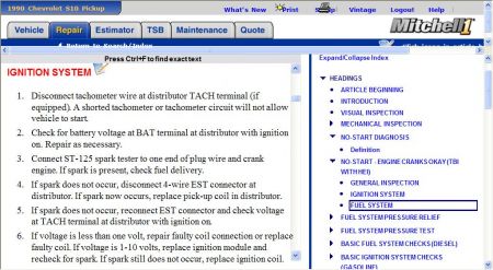

See no start troubleshooting below
https://www.2carpros.com/forum/automotive_pictures/12900_is1_2.jpg
https://www.2carpros.com/forum/automotive_pictures/12900_is2_2.jpg
https://www.2carpros.com/forum/automotive_pictures/12900_is3_1.jpg
