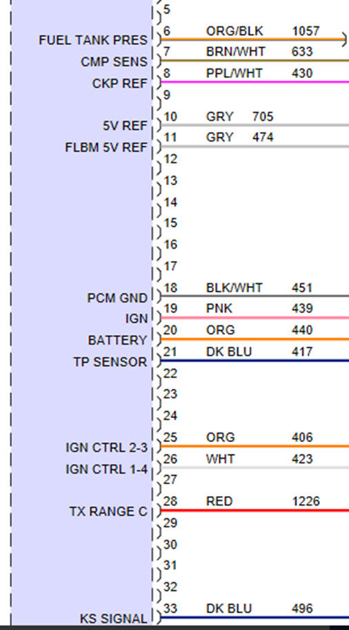

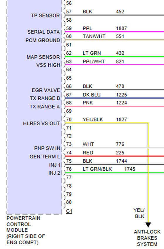

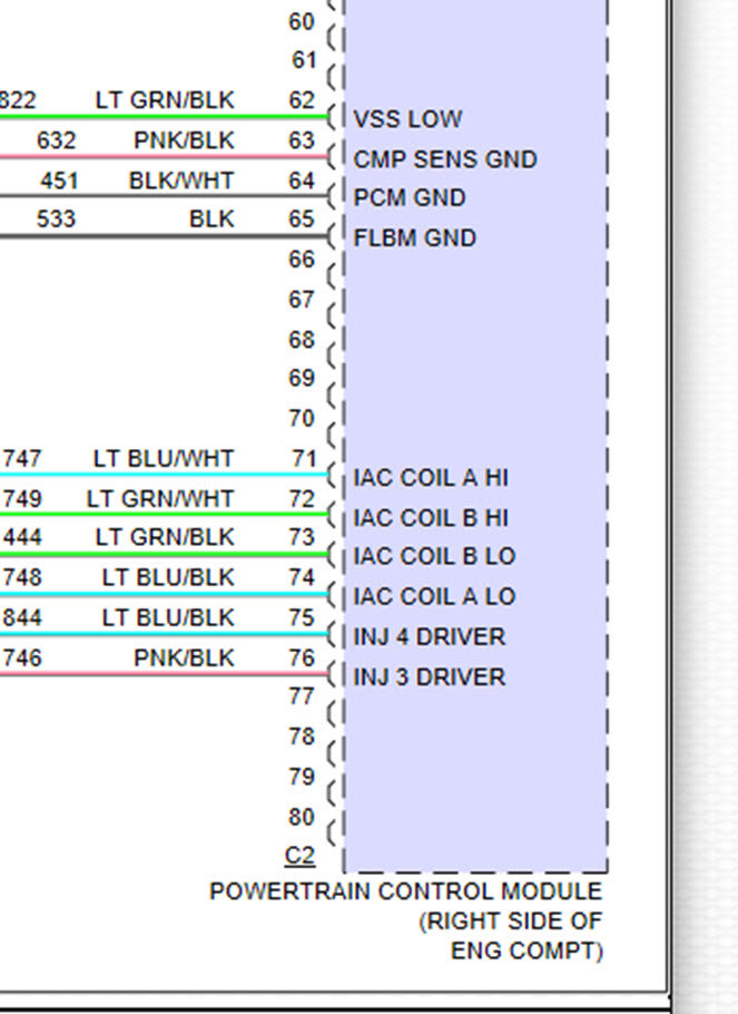

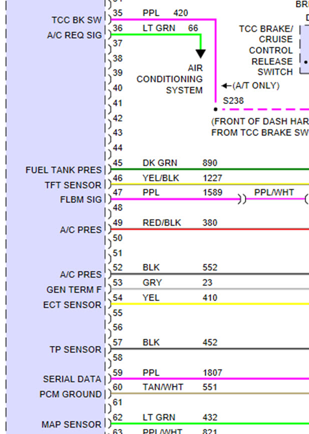

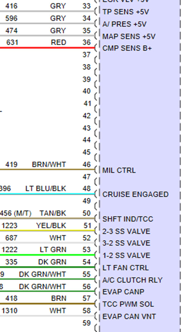

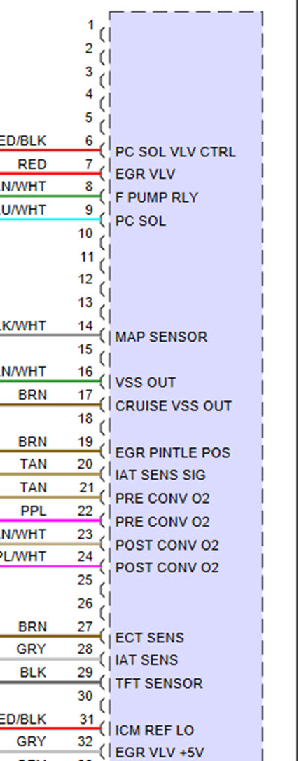

Here is pcm pics best I can do you'll have to piece together because of size.
Tuesday, October 4th, 2016 AT 9:33 AM
