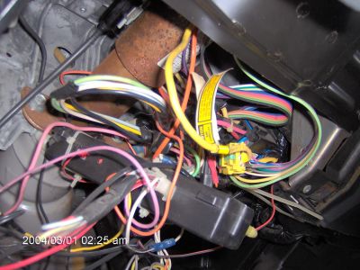

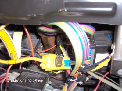

The wires for the bracket have been removed and wired into what looks a module for the remote starter. I can't make out exactly how they are wired. It is a jumbled mess. I can take a pic if my camera works and that helps you. I also tried the starting fluid and the engine did die even though I sprayed as it ran. There is also some sort of toggle switch under the dash that seem to be wired into the remote starter. It doesn't seem to make a difference either way. It will start and run for a minute either way.
Thursday, January 1st, 2009 AT 11:47 AM
BLAZER98
  • 20 POSTS
I included the pics from under the dash. It is a mess. There is a small gray box for the remote starter and a long black box also. Don't know what they do or how to bypass them if they are the problem.

The only wire in that is in the bracket is 2 wire dual color black and tan

IMPALASS
  • 3,112 POSTS
Hello -
Well, look at the wire colors that I attached and see if they are the correct colors before the pic.
It may not want to run because the air cleaner is off....... Sometimes the TBs act like that.
Swap your fuel relay with another like relay.....

Wow you are fast....... Nice pics......... Thanks
When you say 2 wire....... Black tan... Is that two wires, one black and one tan?
If it is two wires....... One black and one tan... Try taking the codes from that.......
Thursday, January 1st, 2009 AT 12:11 PM
BLAZER98
  • 20 POSTS
There are 2 wires (one black and one tan) that are put into one electrical spade type connector and that is in the slot for wire "A"
Thursday, January 1st, 2009 AT 12:21 PM
IMPALASS
  • 3,112 POSTS
Hello -
Jump those two... The black to the tan - sorry to say again..... But please don't' start the car
