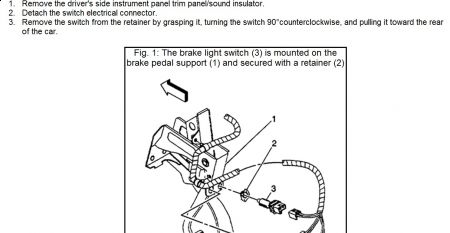

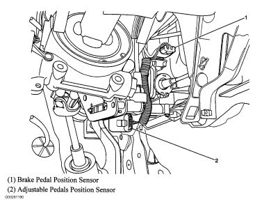

I just purchased a new brake light switch and cannot locate on vehicle. Behind the brake pedal is not enough information.

how to change a stop light switch

I found this information.
