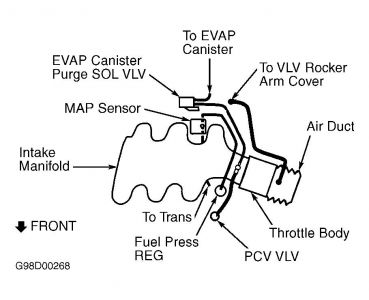

My car won't take gas, it acts like it is full, but I know there is no gas in there. This is the second time this has happened. Last time I kept trying everyday and after about 5 days it finally took gas.

Need to check your EVAP emission system. Either your purge solenoid or the check valve is not working properly.
https://www.2carpros.com/forum/automotive_pictures/55316_98malibuvacuum_1.jpg
