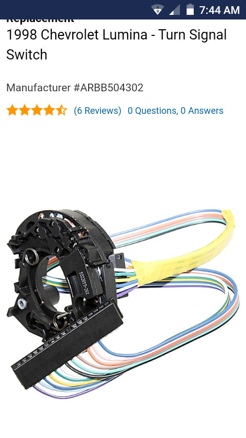

CAROL HADDOX
1998 Chevy Lumina LS Sedan
My lower brake lights weren't coming on. Mechanic relaced the multifunction arm, this did not fix issue. Different mechanic replaced a round ring-like switch located inside the steering column, that the multifunction arm plugs in to. This fixed the issue, lights are now coming on.
