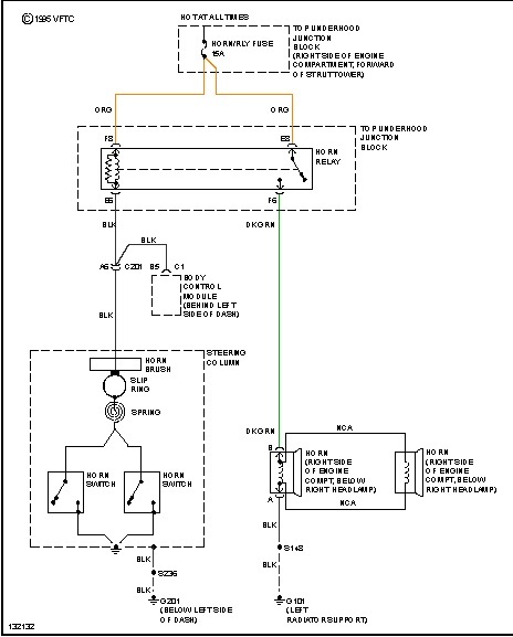

Horn not working and fuse is good?
JDL
  • 16,098 POSTS
The horn button is part of the ground circuit for the coil side of horn relay. Possible problem with wiring circuit in steering column?
Because of air-bag, there are safety issues with working on steering column.
If you use a jumper wire between the load side of relay, the horn should sound, does it? The load side of relay is the side with the arrowhead line.
