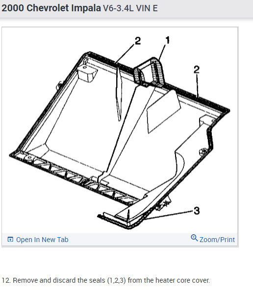

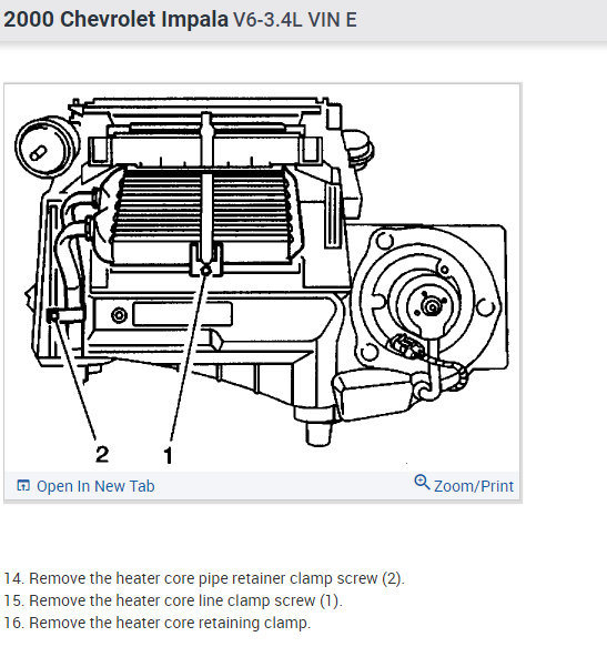

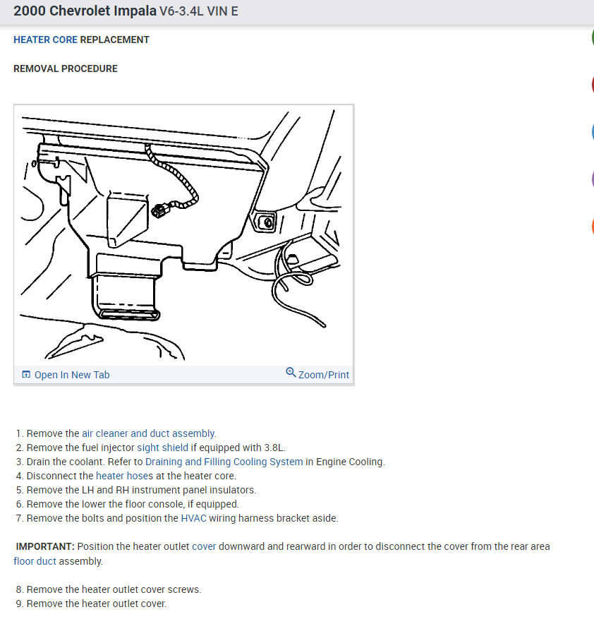

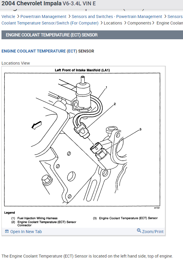

im having trouble overheating an heater not heating. i have replaced waterpump an thermostat. heat gauge says its over heating but the water is not hot. what do i do now?
Feb 12, 2010 at 2:07 PM
SQM
  • CAR REPAIR CONTRIBUTOR
  • 6,383 POSTS

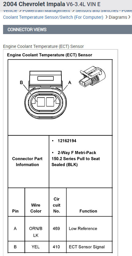

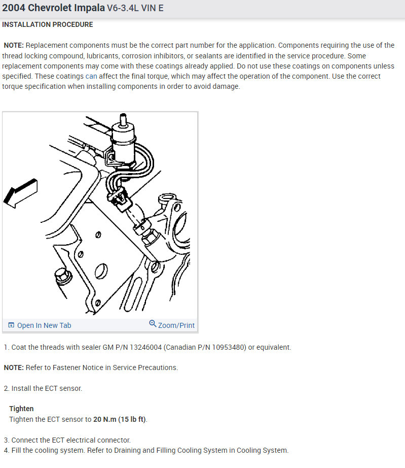

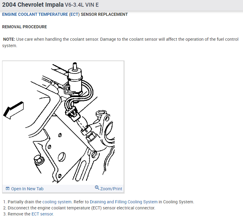

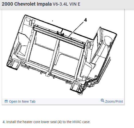

If your gauge shows overheating but the actual engine is not hot, then you either have a faulty temperature sensor or a bad gauge.
First check the temperature sensor. Good chance that is the issue.
https://www.2carpros.com/articles/symptoms-of-an-overheating-engine

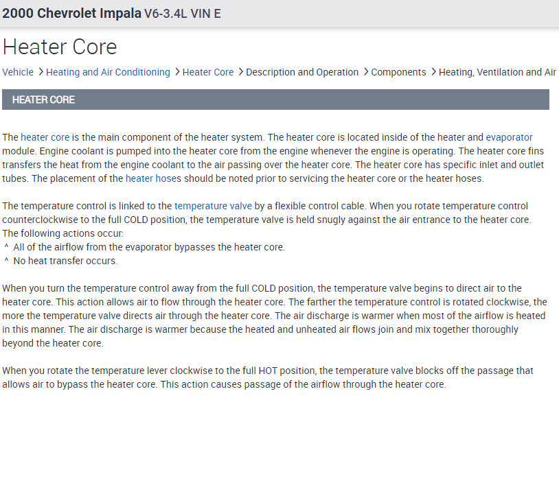

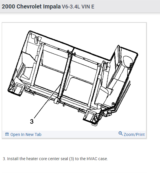

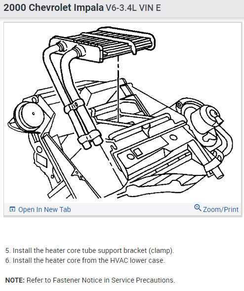

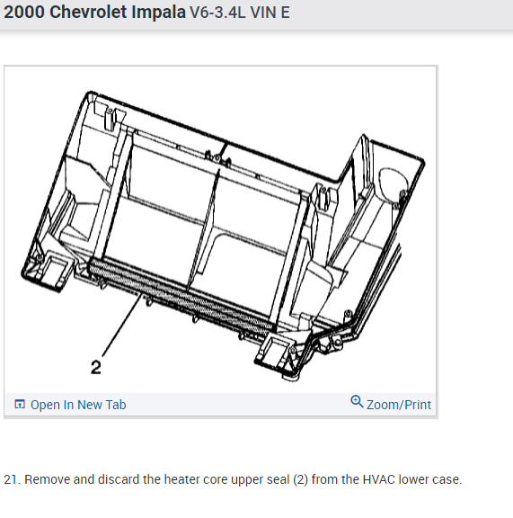

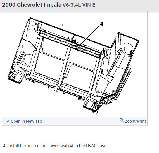

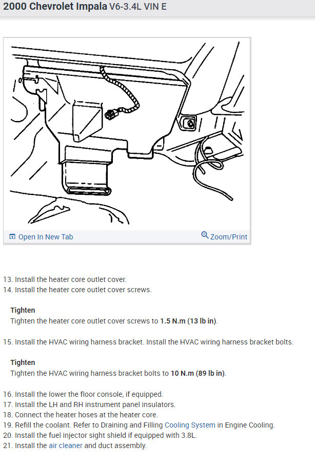

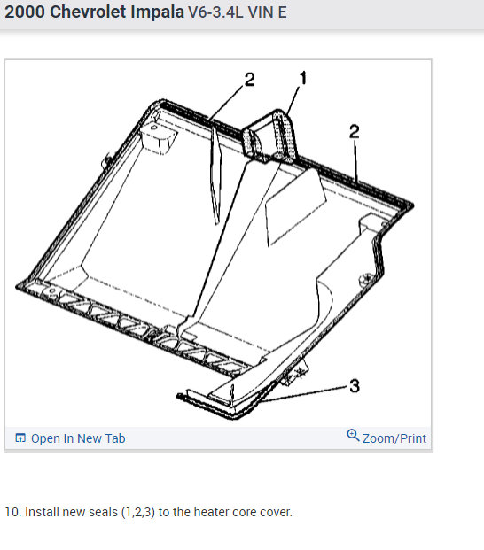

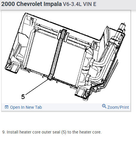

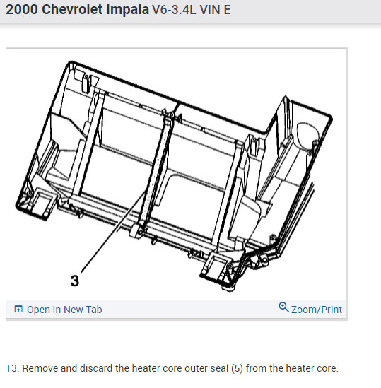

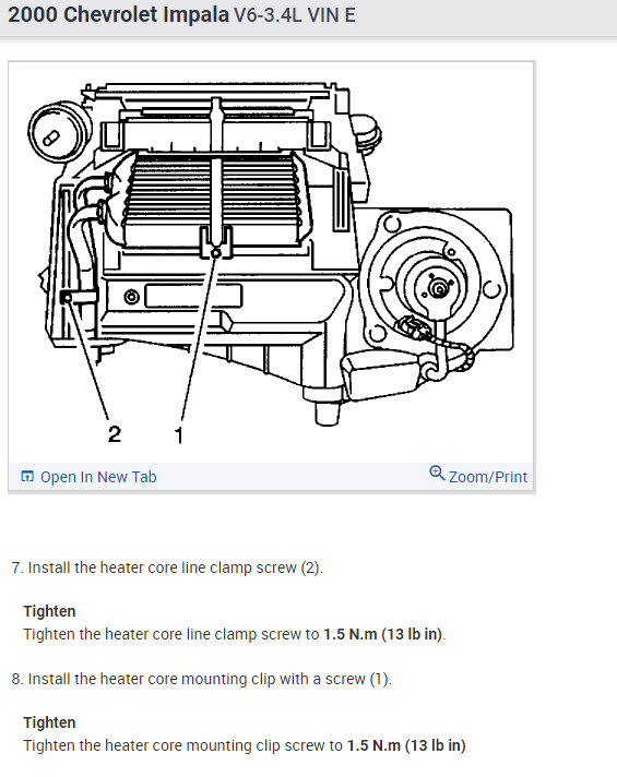

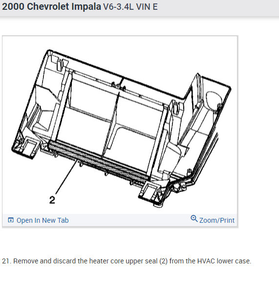

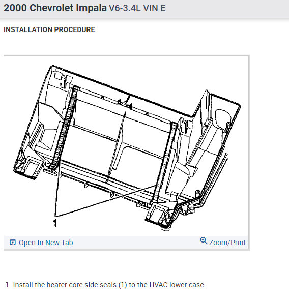

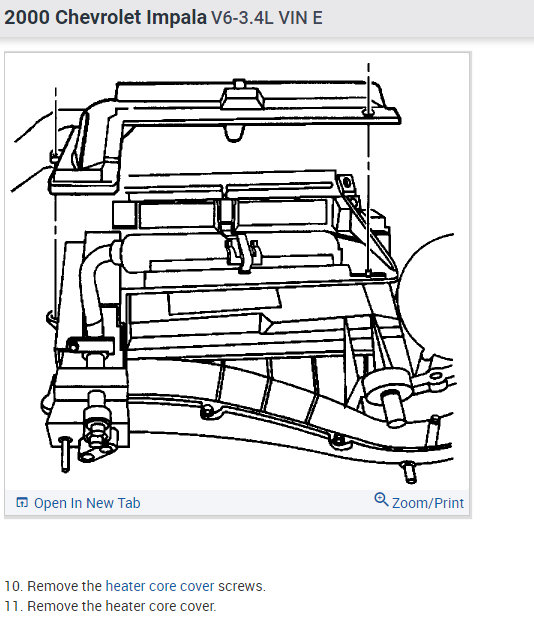

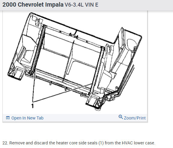

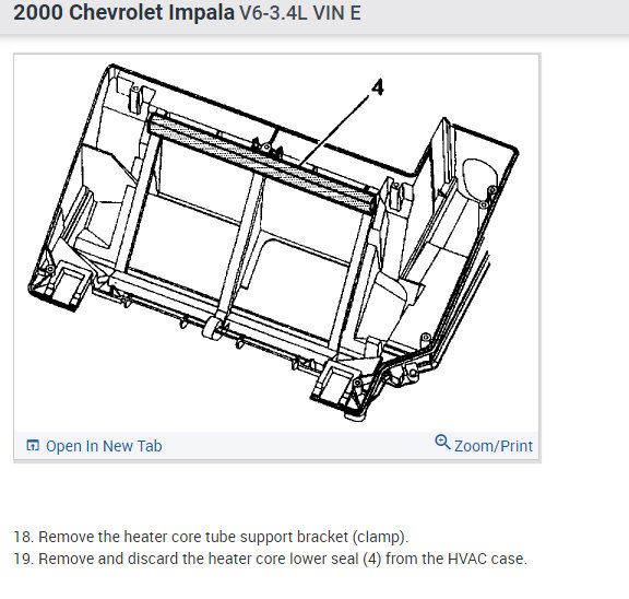

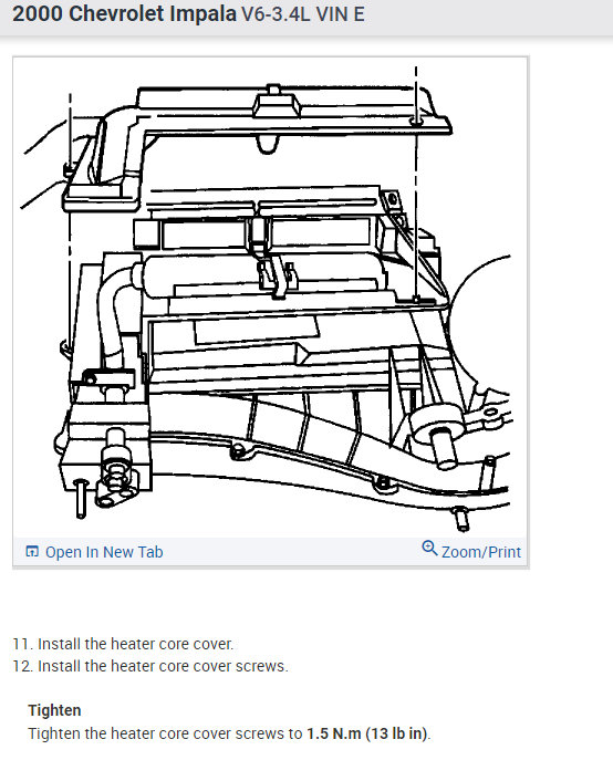

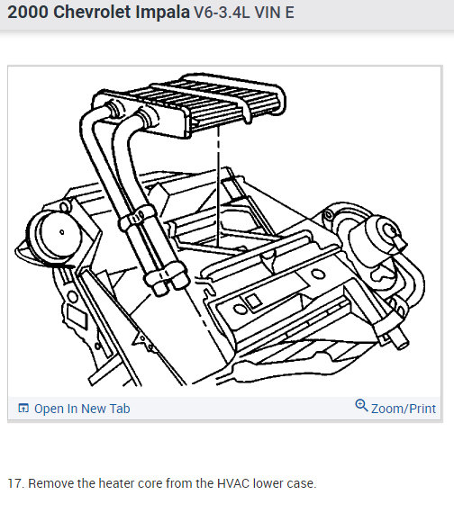

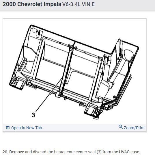

If the heater does not heat, it could be for the engine not reaching operating temperature or a clogged heater core.
If the engine running at the correct temperature then it is likely a bad heater core.
https://www.2carpros.com/articles/how-a-car-heater-works
https://www.2carpros.com/articles/replace-heater-core
I have attached the temperature sensor and heater core replacement procedure for your reference.
