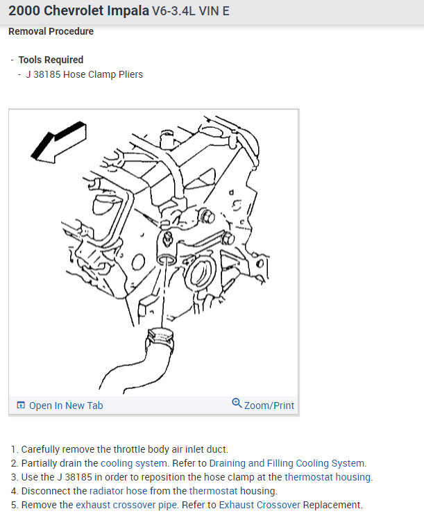

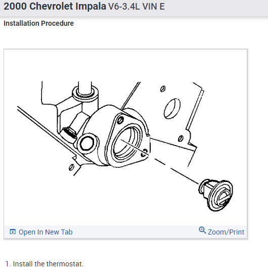

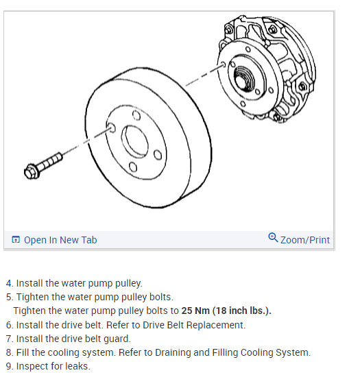

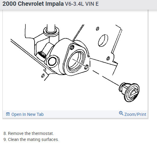

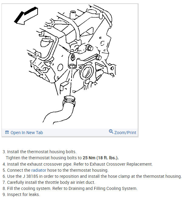

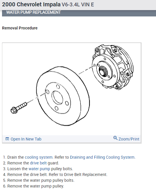

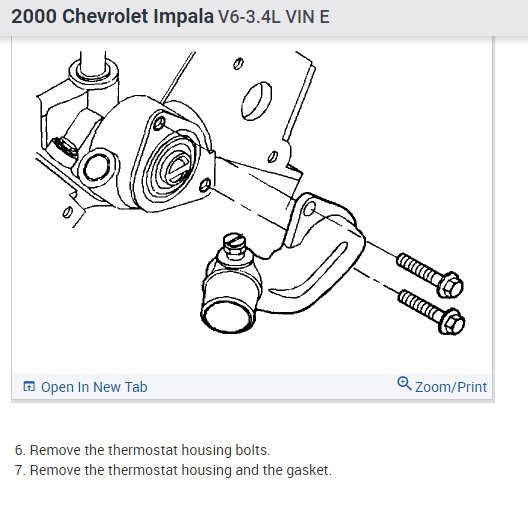

Temperature gauge floats it goes from normal to hot is this an indication the water pump is going bad or the thermoset is bad?
Thursday, April 23rd, 2009 AT 12:02 PM
SQM
  • 6,383 POSTS

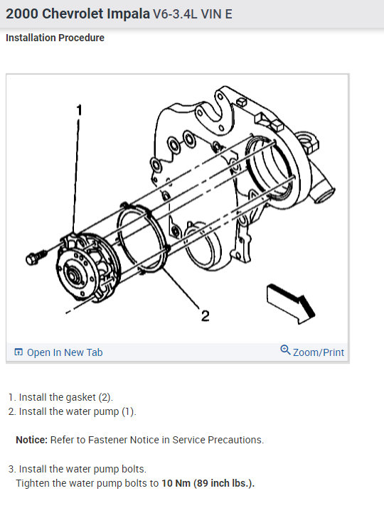

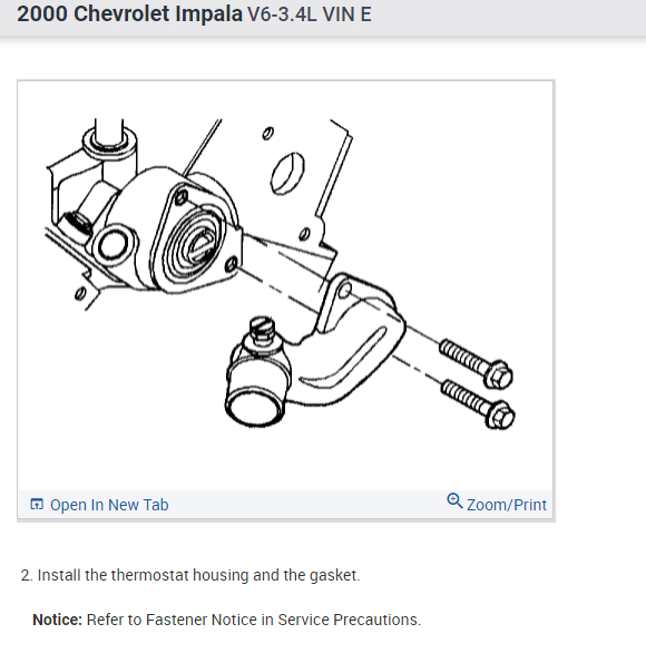

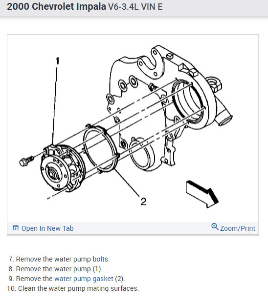

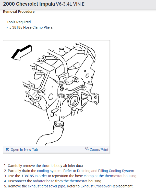

An engine can over heat due to a stuck thermostat or a water pump that is not circulation coolant thru the engine.
The engine can also over heat due to a faulty cooling fan. If the cooling fan does not work properly or does not work at all the engine will over heat.
Now does the engine actually over heats or it just the temperature gauge that is showing the high temperature? Many times a faulty coolant temperature sensor can give false readings. It can also trigger the cooling fan not to operate.
You might find these articles helpful:
https://www.2carpros.com/articles/symptoms-of-an-overheating-engine
https://www.2carpros.com/articles/water-pump-replacement
