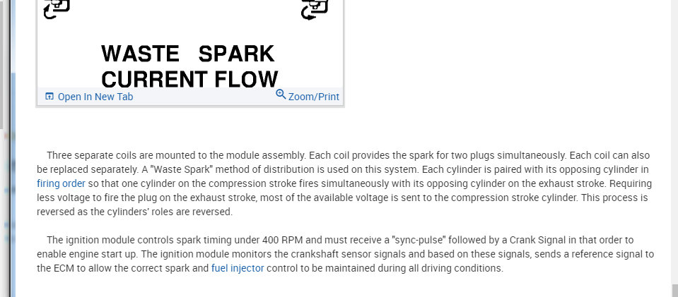

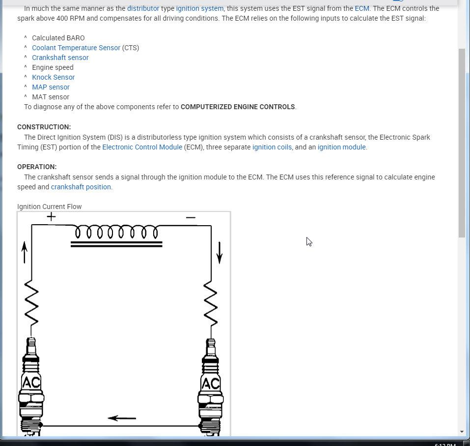

NEONJACOB246
I have the car listed above that has been sitting for seven years. 3 years ago I did a major rust restoration and got the car running with plans to drive it. It ran really badly and my dad took the car out and floored it and it shut off with no spark now. It has been sitting but now I need to get it running so my wife can have a vehicle to drive. I changed the crank sensor, and ignition module but nothing. I also don’t think the coil packs would all go bad at the same time. I’ve checked every individual cylinder for spark.
Oct 10, 2020 at 12:38 PM (Merged)
  • CAR REPAIR CONTRIBUTOR
So we need to do a couple things. First the way this shut off during hard acceleration makes me think we may have an issue with the crank tone wheel and air gap for the sensor. Even though you have a new sensor in there, if the air gap is not correct then the sensor will not pick up the signal in order to send it to the ignition module which sends the signal to the ECM.
So basically we need to find out if the ignition module is getting the signal from the crank sensor and then if the module is sending it to the ECM.
Can you monitor the voltage or does the tachometer move at all when the engine is cranking? If not, let me know and we can come up with other ways to test this.
Let's start with this info and go from there.

5SPDMANUELROCK
To tell you the truth it sounds like a faulty alternater.if this is the case it would do evrything you have jus discribed.the reason being is i've had that same problem and took it to advanced auto and they said there was nothing wrong with it and that evrthing seems in check.but this seemed to be entirly incorrect bc a alternater can be at break point and pass a test but it will eventualy just stop.which is wat sounds like is happening to you.so my advice to you is to gey ur alternater replaced and if it still happens which it shouldnt but if it does its a vacum leak.hope this helps
Oct 10, 2020 at 12:40 PM (Merged)
Great information and you may be exactly correct. I am attaching some guides that we have that will help with this information. Hopefully this will help others that view this site.
Thanks for the addition to the site. Please let us know if there is anything we can help you with. Thanks
